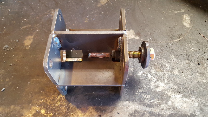

One thing most wheelers carry is a hilift jack. It seems like every time it is used the jack has a tendency to slide on the sliders and seems very unstable. I built the bracket below to help grab onto my sliders and hopefully make it more stable.
Here is the bracket.
20150901_134556 by Matthew Dresselhaus, on Flickr
It mounts onto the jack with a 1/2" bolt holding it to the jack.
20150901_134829 by Matthew Dresselhaus, on Flickr
Here is how it latches onto the sliders. Mine are 1.5" tube. I forgot to account for the weld on the back side so version two will be changed there.
20150901_135037 by Matthew Dresselhaus, on Flickr
Here it is lifting the truck. For the front I carry a chain to limit wheel travel so I don't have to jack so high.
20150901_135246 by Matthew Dresselhaus, on Flickr
20150901_135302 by Matthew Dresselhaus, on Flickr
Toss it in the toolbox and hopefully I will never have to test it for changing a tire.
Parent that thing and start selling them dude! One for each diameter tube. $30 each!
Thanks the test in the garage seemed very sturdy. Much more then without it. I need to give it some real world use and see how it performs.

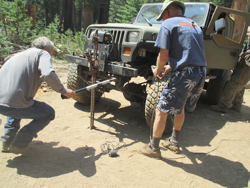

Last week 4x4junkie messaged me and said they would be going into Coyote Lake and doing some camping. My schedule didn't allow me to go for the full time he was going but I was able to do an overnight trip. Coyote Lake is in the Sierra National Forest about 1.5 hours from my house to the trail head. The first half of the trail in is to Red lake. I have been to Red numerous times as the club I belong to does the maintenance on it. I was making pretty good time and was about a quarter mile from Red Lake when I cought a group welding spring mounts back on the frame of a YJ. Turns out the guys doing the welding just happened by. The broken YJ was one of 4x4Junkie's friends meeting him in there.
IMG_0694 by Matthew Dresselhaus, on Flickr
Once they got him welded back together they packed up and took off. When the mounts broke, the driveshaft separated causing the splines to twist. We used my York and die grinder to cut 1/2" off the yoke and clean the splines on the shaft up so the front driveline could go back together. We headed in and made it to Coyote late afternoon.

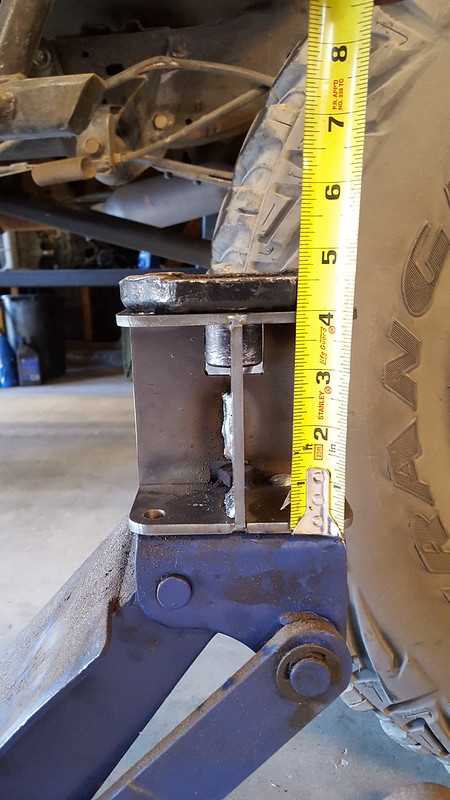

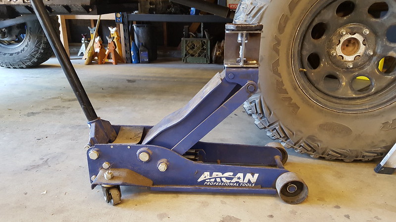

Got sick of both of my floor jacks being to short for taking my skid plate off.. So I built an extension for my bigger floor jack. It bolts through the center hole with a location circle on both sides so it won't fall off. The 4 holes in the corners are so I can build a second one and bolt them together if I want to. We will see if 4" is enough.
