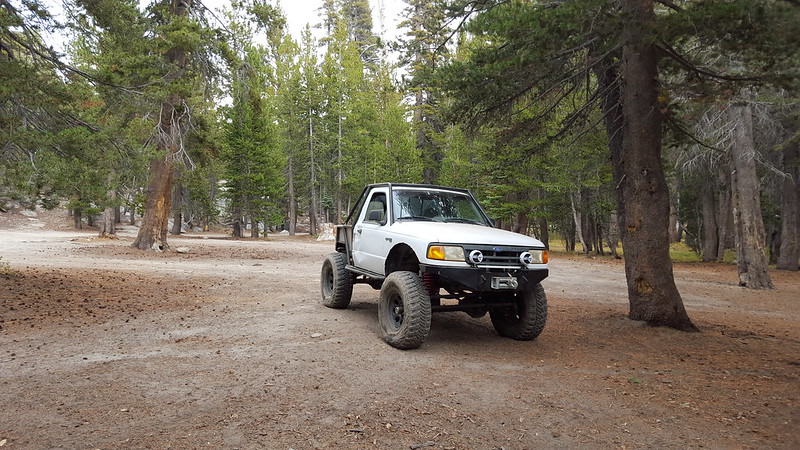

Did you go up wheeling on the 28th? I thought I saw you at the bottom of the 4 lanes. I was in the black step side ranger, parked on the curve. Then I saw two more Rangers go up after you.
Yes I did. But I was by myself. Not sure about the other rangers. I never saw them. I took my daughter up to Red lake to do a little wheeling and fishing. She had a good day, she caught three fish is less than an hour.

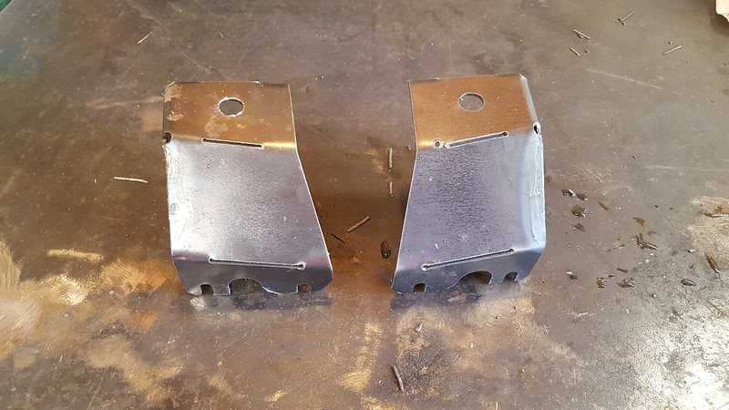

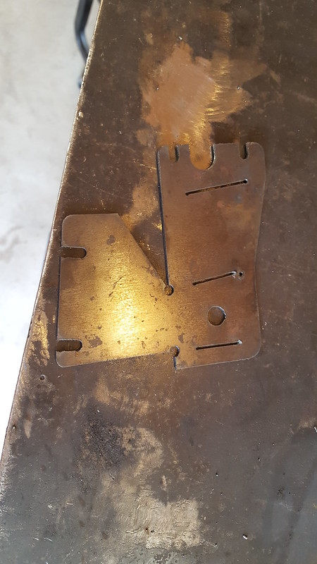

While searching on Amazon I found some $19 LED pod lights so I decided to give them a try. I needed mounts so I decided to try the bottom of the windshield. I drew up a bracket and cut them out.
20150929_111335 by Matthew Dresselhaus, on Flickr

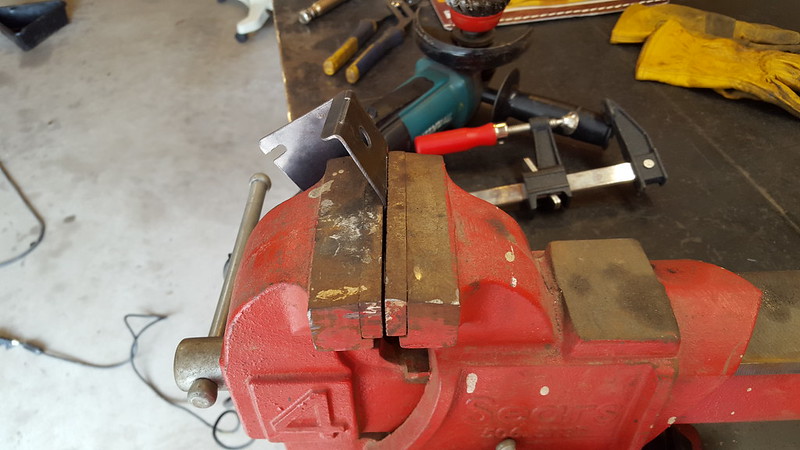

Not having a decent way to bend metal I resorted to a hammer and vice. The cut lines in the bracket help to line up the bend points.
20150929_111521 by Matthew Dresselhaus, on Flickr
Two brackets mirror images of each other for each side of the truck.

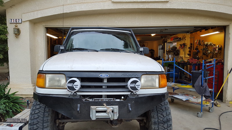

20150929_134400 by Matthew Dresselhaus, on Flickr

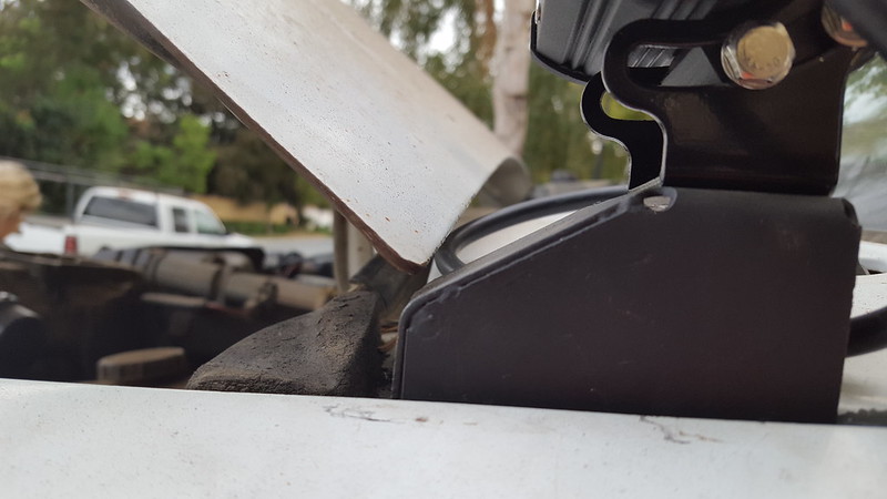

Lights mounted up.
20150929_175939 by Matthew Dresselhaus, on Flickr
Hood clears all the way through normal motion. I still need to wire and aim them. If I decide I like them I have a few ideas for improving these mounts that I will implement into version two.

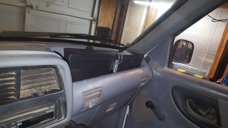

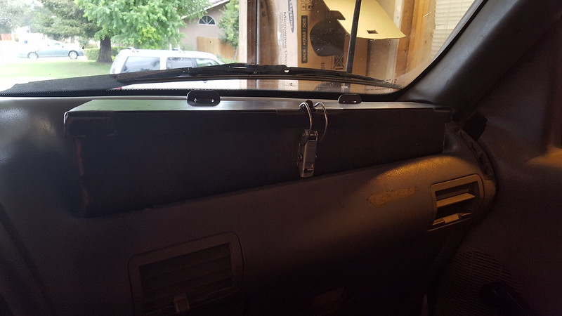

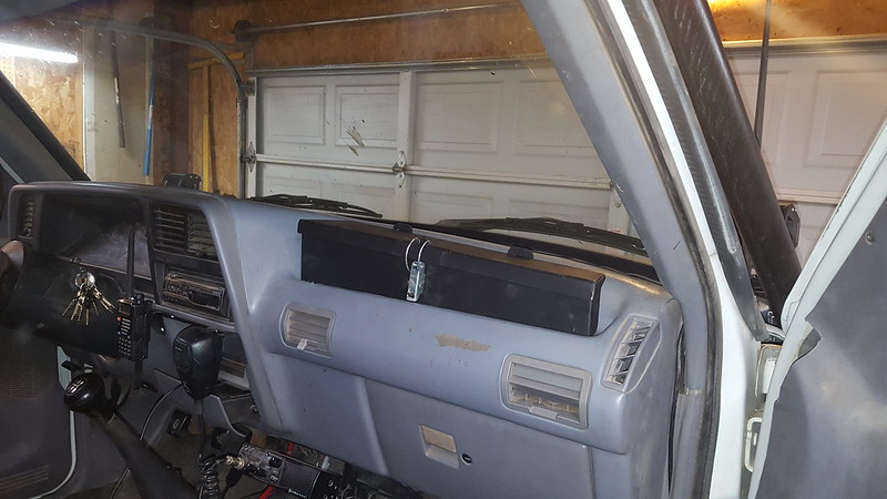

In my quest for more storage spots on the truck I turned to the dash. The 89-94 ranger and 91-94 explorers have a nice flat spot on the dash that is fine to hold pens on the highway but nothing stays there when off road. I decided to build a box to fit in this area.

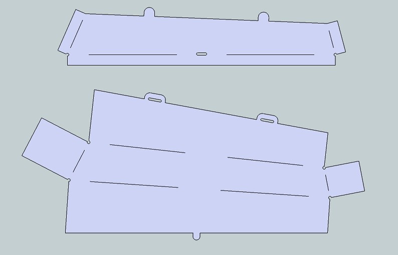

Little time with cardboard and the computer and I had this drawing.
dash box by Matthew Dresselhaus, on Flickr

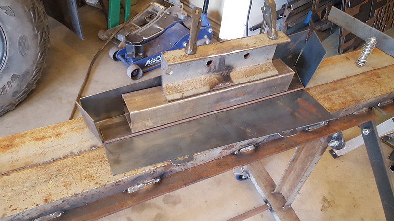

After cutting it on my plasma table I started to make the necessary bends. I need a finger brake as this was what I came up with to make a few of the bends.
20150929_142010 by Matthew Dresselhaus, on Flickr
Here is the box in position. To mount it I drilled two holes through the bottom and thru the dash. I dropped the glove box which gave me the room to put a fender washer and nut on the bottom to mount it. I had to grind a bit of the latch to allow it to clear the dash.
20150929_161041 by Matthew Dresselhaus, on Flickr
What ever happened to the plywood interior pieces? Any updated ideas to them?
The reason I ask is what about adjusting the center console a touch to hold your cb and ham mics. I really dig what you did, but my luck would have me hit a bump the split second I lift the Mic out and impale my hand on a corner.
The plywood center console is still in. I am waiting to redo it till I get new seats. I like the general layout of it. Once I get new seats will determine any size changes.
As far as sharp corners on the mic holder, that is the nice thing about cnc. It is easy to round corners to get rid of sharp points.

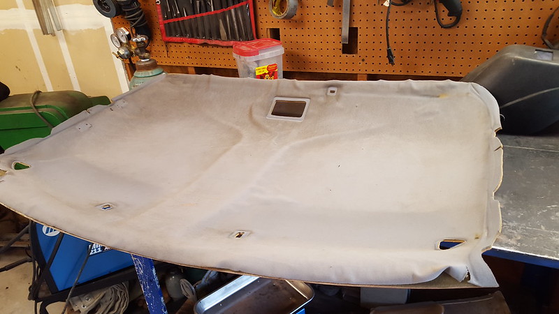

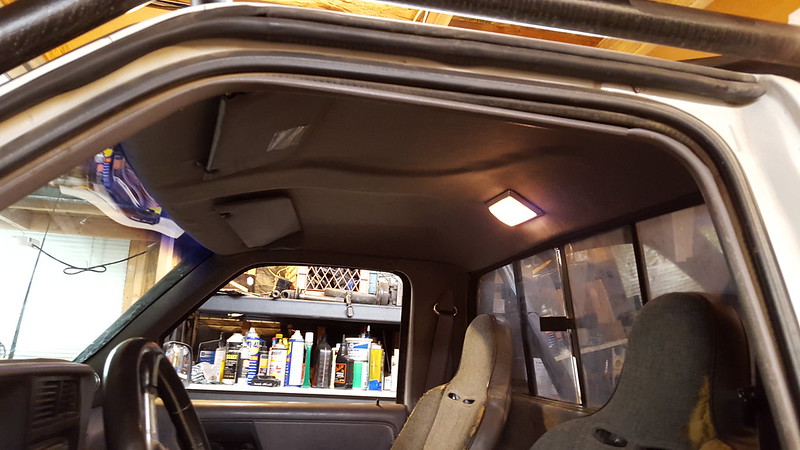

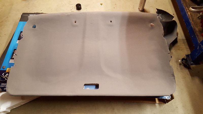

Starting to clean up the interior. The old headliner was nasty and falling off.
20151102_154506 by Matthew Dresselhaus, on Flickr
My first trip to Joanns fabric with my wife and $26 later we walked out with Adhesive and new material. Stripped the old material off and glued the new material on.
20151102_173144 by Matthew Dresselhaus, on Flickr
Installed in the truck.
20151102_185936 by Matthew Dresselhaus, on Flickr

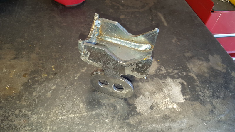

Made the adjustments to my hilift adapter to make it more versatile.
20151002_123825 by Matthew Dresselhaus, on Flickr
More info on it can be found in its own thread. http://therangerstation.com/forums/showthread.php?t=162920
