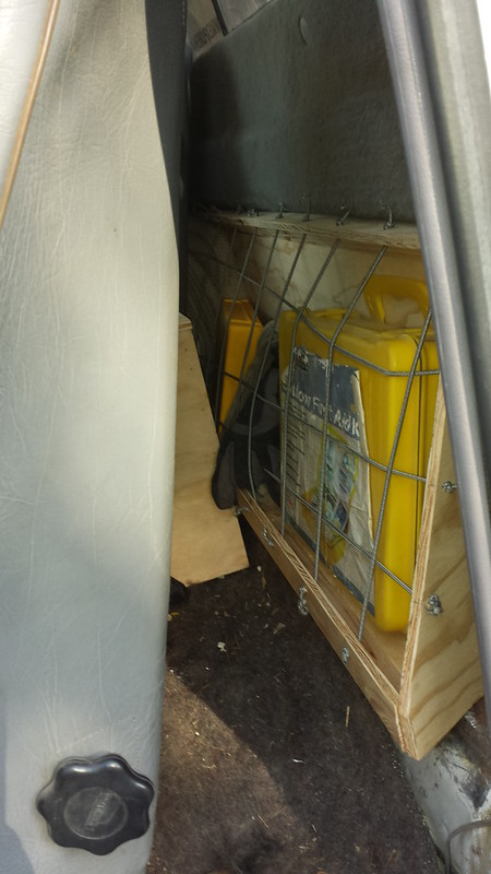

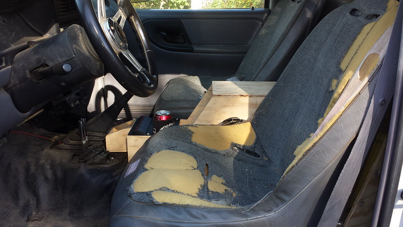

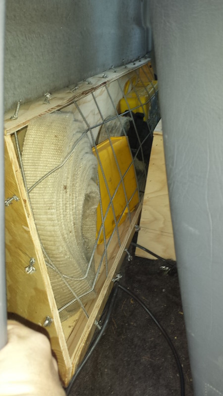

The interior of the truck has been sparse. I added some aftermarket seats and hate them. The fabric on them began failing quickly after they were installed. They are on the list to be replaced but haven't yet. Having a standard cab and stuffing things behind the seats has always been a challenge. Anytime I need something I slide the seat forward and then everything falls down and has be reorganized before the seat can go back. So I built a box out of some ply with a grid of bungee cord to hold everything in place. I used wood this round as a proof of concept to see how I like it and what changes I will make after using it a while. I used wood as it is cheaper and faster for me to work with. The next one will be made of steel and painted.

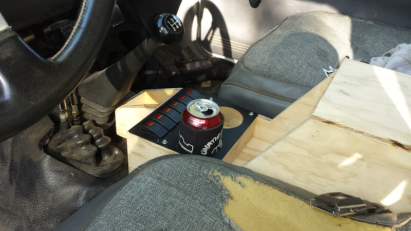

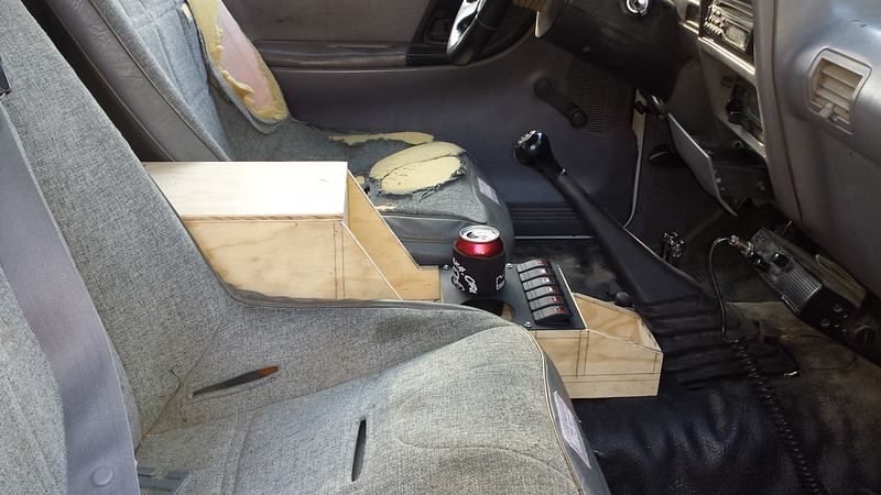

I never had a center consul once I swapped to bucket seats. I had some cheap pepboys cup holders but that was it. I again made it out of wood so I could see what I liked and didn't for the next steel version. I needed a spot to add some switches as well. These switches are in easy reach. Time will tell if they get hit to much on accident to stay there in the final version.

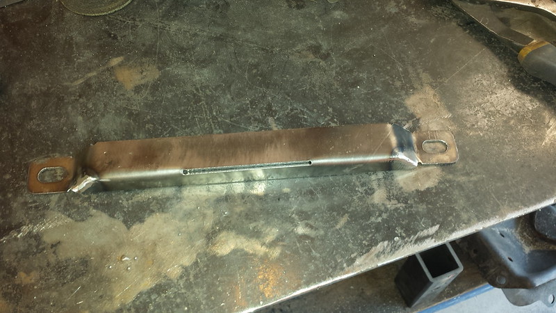

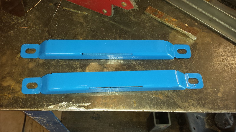

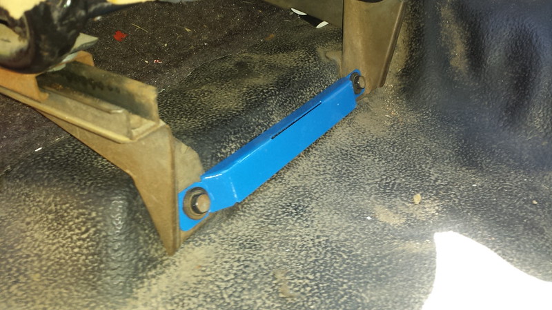

Needing a place for a flashlight I was talking with a friend and he said some land cruiser guys make a mount that goes to the front seat mounting bolts. So I drew up a bracket put a bend in it to give it some strength and now have a mount I can get some maglight mounts and a maglight and it will always be in easy reach. One for each the passenger and driver sides. Also might mount a fire extinguisher to one of them.
20150330_120225 by dresselhausfc, on Flickr
20150330_151034 by dresselhausfc, on Flickr
Driver
20150330_151550 by dresselhausfc, on Flickr
Passenger

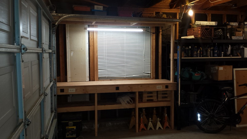

Got a little time to work on the ranger and the garage. First I am always wanting more workbench space so I built one. I added plugs to the front to make plugging in tools easy. In addition I cutout holes that will be for three receiver hitches. Plan is to mount a vice and other accessories on 2" tube that can slide in and mount to the workbench but be easily removed when not needed. I also added a shelf even with garage door track for storage up high of seldom needed items. Also made a good place to hang a light from.

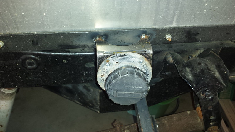

Next I made a mount to hold the gas filler and cap. They have been flopping around sense I built the bed.

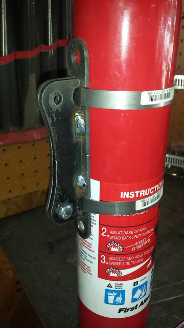

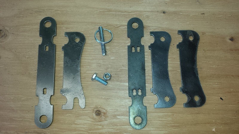

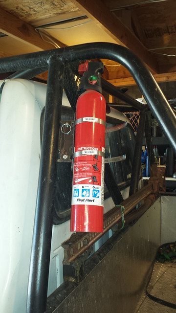

I haven't had a fire extinguisher in my truck for a while. It needed to be easy to access and not buried behind the seat so I drew and cut these brackets.
20150509_133008 by Matthew Dresselhaus, on Flickr
It is designed so either side can be bolted or hose clamped on. It could be used for more then just fire extinguishers. I used hose clamps to mount a fire extinguisher to one side.
20150509_135443 by Matthew Dresselhaus, on Flickr
The other side I left the plate off and welded it directly to cage. Pull the upper pin out and it drops out and is ready for use. No tools needed to remove it.

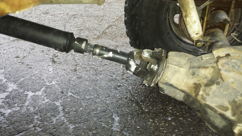

I didn't take any pictures on the trail but had some fun on a few optional paths. This is why I have a rear driveshaft made of .134 tube.
20150606_170528 by Matthew Dresselhaus, on Flickr

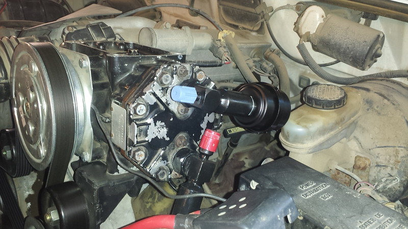

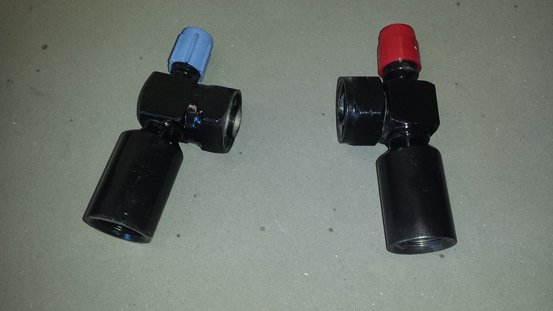

To hookup my York I had to get some custom made fittings made. The york uses a tube-O style fitting. I needed to convert that to NPT to make the system work. A local A/C shop that does a lot of tractor repairs was able to make these up for me.
20150608_160843 by Matthew Dresselhaus, on Flickr
Here they are mounted up on the york with an air filter from amazon.

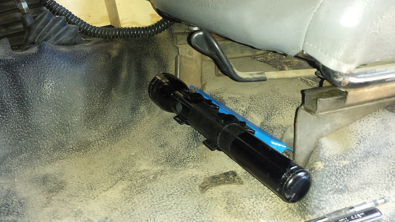

I also picked up an LED bulb and some maglite mounts and mounted my 3D flashlight at the front mounting holes of the driver seat. Easy to remove and secure.

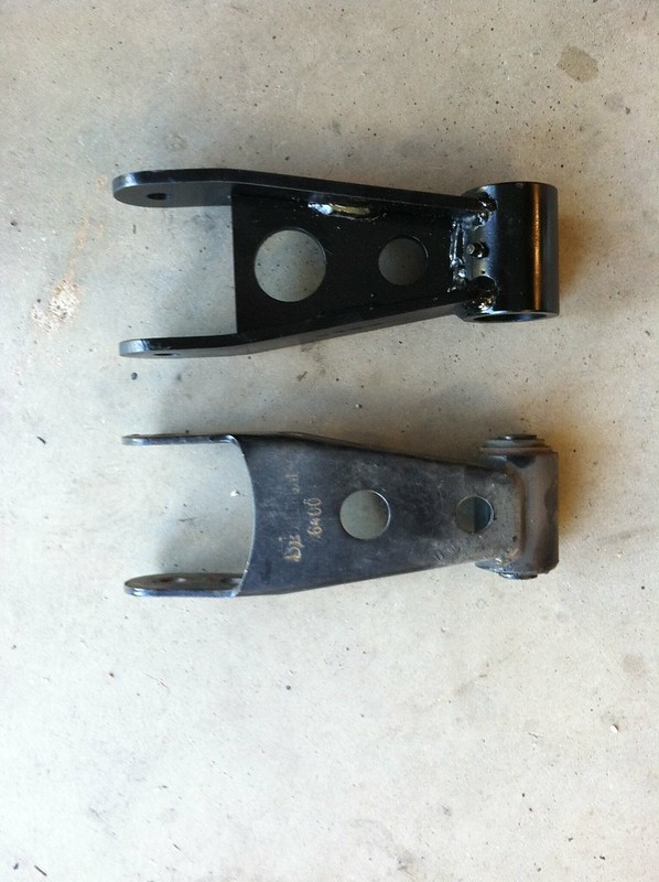

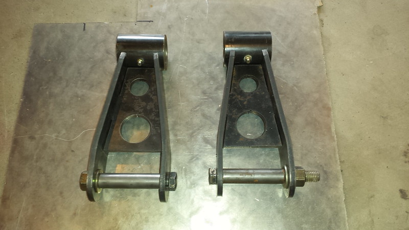

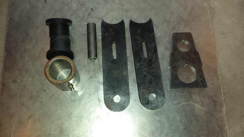

The bushings in my Belltech shackles are starting to wear out so decided to build some new shackles out of 1/4" plate. A 3" wide bushing kit from Ruffstuff or Ballistic and the three plates cut on my plasma table will make one shackle. They are roughly 7.25" from bolt hole to bolt hole.
20150609_141257 by Matthew Dresselhaus, on Flickr

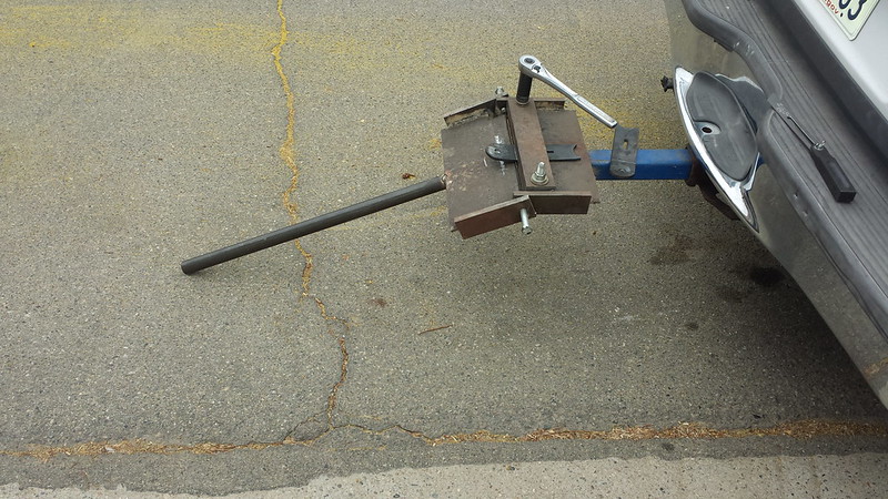

They need a slight bend in them to work so got out my fancy brake and put the bend needed in them.
20150609_141941 by Matthew Dresselhaus, on Flickr
Assembled before welding.
20150609_142616 by Matthew Dresselhaus, on Flickr
They will have to wait a few weeks for install till I have time to work on the truck again.

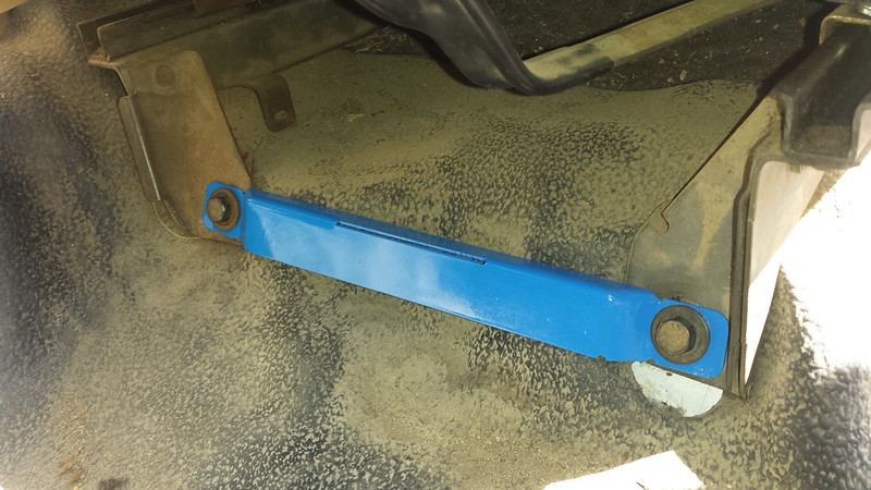

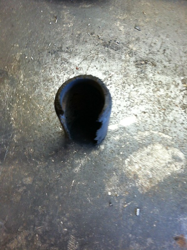

Getting ready to install the shackles and noticed the bushings in the springs were bad. This was the best one and it fell out when I removed the spring.
Untitled by Matthew Dresselhaus, on Flickr
My new shackle next to the belltech I am removing.

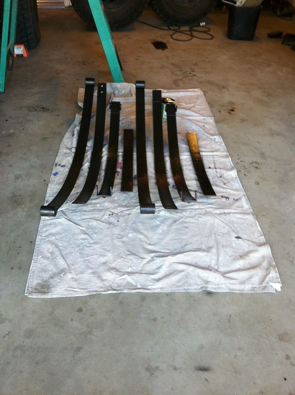

Also took the time to pull the springs apart. Wire wheeled them and then painted them. New spring bushings get here tomorrow.
I did the same with my leaf packs. It makes the truck look better plus it helps keep the squeaks down.
