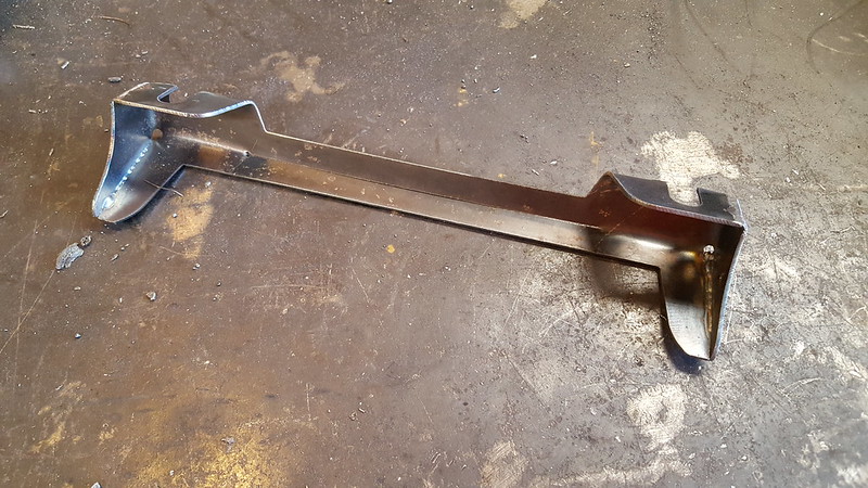

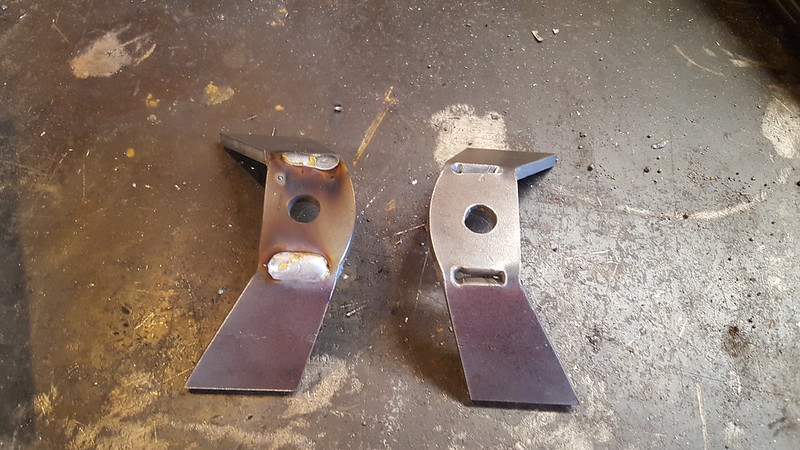

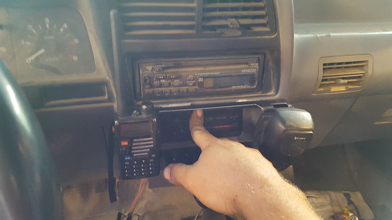

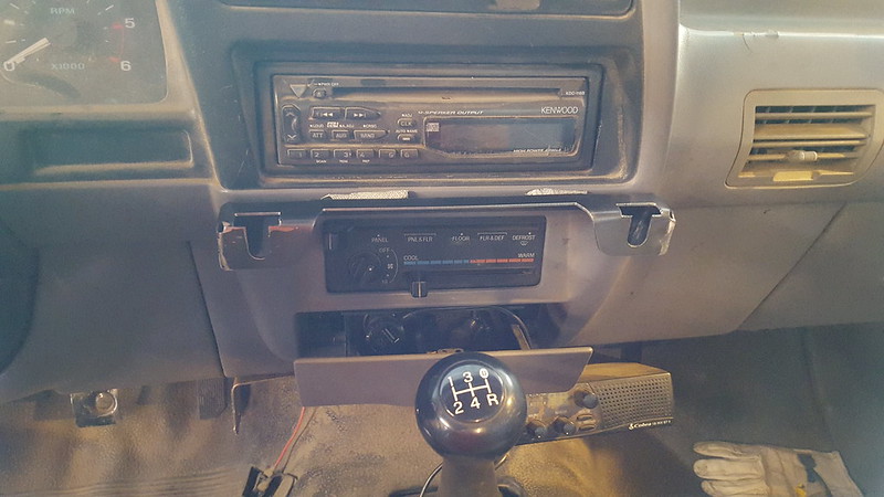

I never had a good place to hang the mic for my CB. With getting my ham license and eventually adding a second radio to my truck I needed something better then just laying it on the seat. Looking at the dash of the truck I determined the best spot is below the radio and above the HVAC controls. So I drew up a bracket cut bent and welded and ended up with this.
20150907_155936 by Matthew Dresselhaus, on Flickr

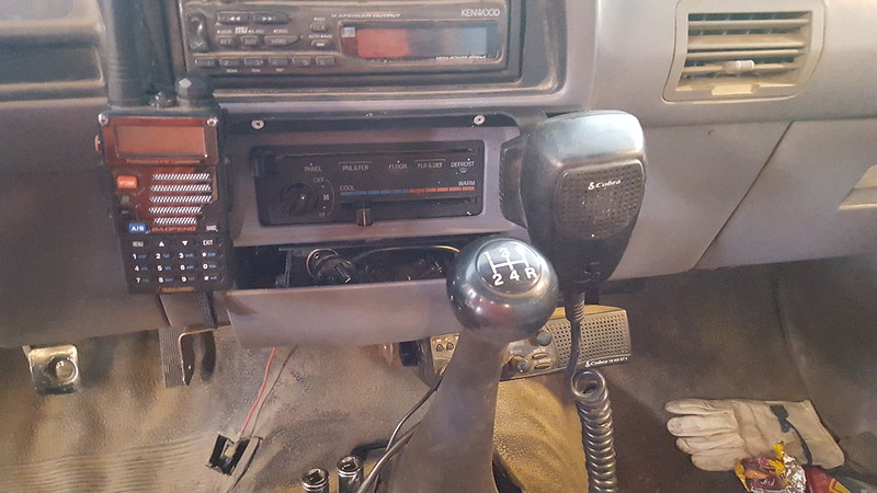

Here it is held to the dash while I check layout.
20150907_160823 by Matthew Dresselhaus, on Flickr
Until I get a vehicle mounted ham radio I can clip by hand held on one side.
20150907_160857 by Matthew Dresselhaus, on Flickr
I am thinking of pop riveting on as I doubt screws will hold well enough. I am open to other options for attachment to the dash though.

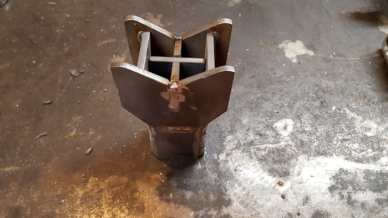

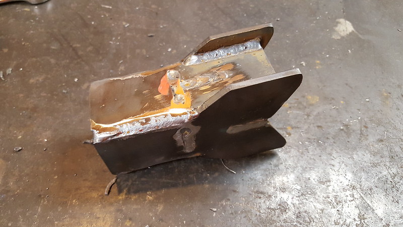

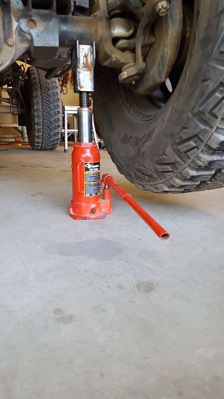

In addition to my hilift I also carry a bottle jack. Using a bottle jack has a few drawbacks though. The small flat top likes to slip off the round tube of axles and often times with bigger tires you can run out of jack before you get the vehicle high enough. So I made this adapter that slides over the top of my jack and adds 2" to the height. It is more then enough now to get my truck high enough to change a tire.
Now that's awesome! Creativity with a clear purpose that takes up minimal space. Great design! :icon_thumby:
Nice, I like the small touches you put into this thing. I wish I had a CNC plasma table

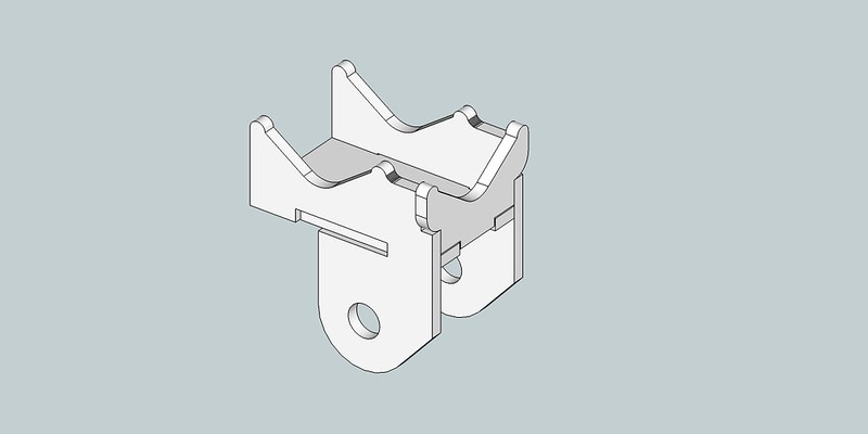

You should make a base plate for the hilift that digs into soft surfaces and distributes the load better, and that slider adapter to fit 1.75. I'd buy some
I thought about a base plate for the hilift but haven't thought of something better or cheaper then the one already available.
For the adapter to the slider I made some changes and came up with this that should fit any size tube up to 2".
AutoSave_Slider mount by Matthew Dresselhaus, on Flickr
I ran out of time and have to go back to work so it will be a few weeks till I get a chance to make one. I will keep you posted as I can make a few extras for sure.
