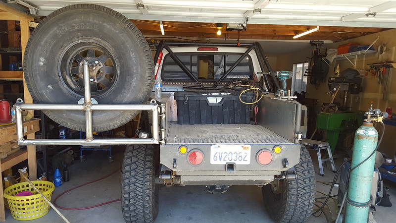

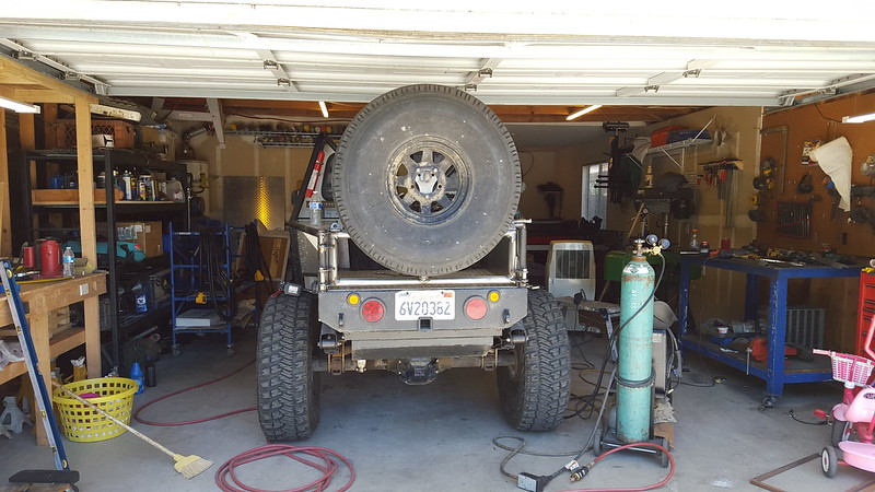

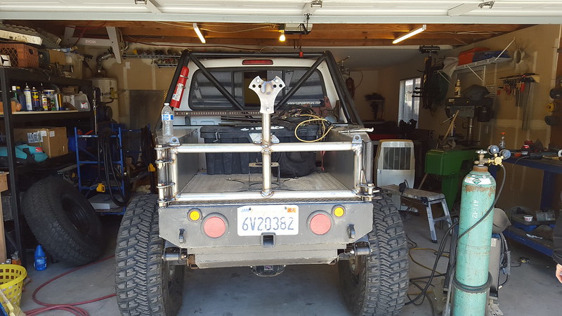

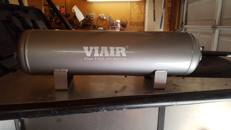

Works okay for small one off parts. I really want a bigger and more accurate one though.

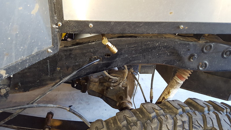

I also stubbed the chuck connector out on the drivers side behind the tire. Not sure how I will like it there.
20150728_175821 by Matthew Dresselhaus, on Flickr
I am in a bit of a time crunch as I am getting ready to head to the dusy ershim trail next week. Trying to get a bunch of things ready.
5 bucks says you hit it
Man, my old club out of San Diego runs the Dusy every year. When I get back out there, I gotta run it
That picture makes it look like it sticks out farther then it does. It is only 1" off the frame and about an inch below the bed floor. It would be a tough spot to get hit. I am more worried about dirt and mud from the tire making a mess of it. If it becomes a problem I can move it.
What club were you in? My last trip to Dusy was 2003. A friend of mine was up there last week clearing the trail with the Forest Service. Says Thompson Hill is the roughest he has seen it. Should be a fun trip.

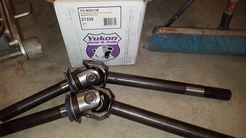

It was a nice 106 in the garage today. I assembled and installed my new Yukon shafts for the front axle. I have broke I think 5 front stock shafts (inner,outer and ujoint each time) so it was time to upgrade.

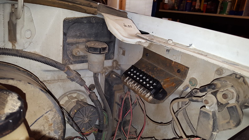

I also added a fuse panel under the hood. Not real impressed with it but for $9.00 what do you expect. It should work for a while. Where is the best place to get a keyed hot lead from? I will run it off a relay so what ever circuit it is on wont see a ton of extra power.

possibly the hot side of the starter solenoid? I can't remember which side that is, but I think it has a constant hot when the key is on.
