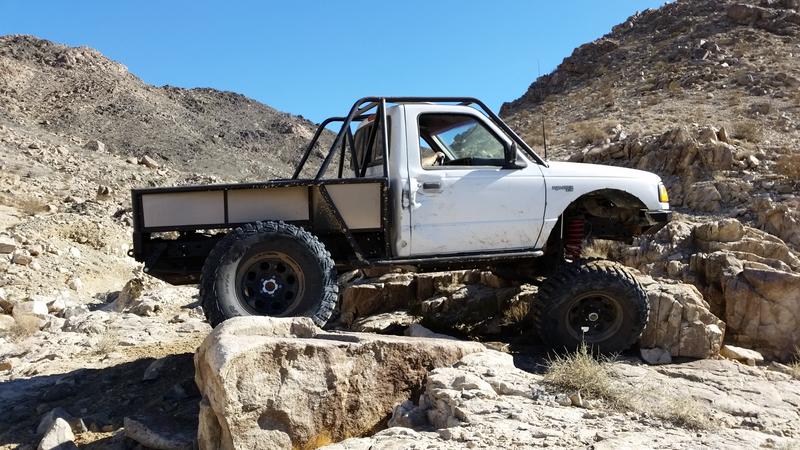

Took the ranger out wheeling new years day. It was cold with the highs maybe hitting the upper 20's with a good wind. A welded rear diff and iced up paved roads made for a fun adventure getting to the trail involving a few good fish tails. The trail was very icy and required a lot of momentum to get up in certain spots. Overall we had a good time.

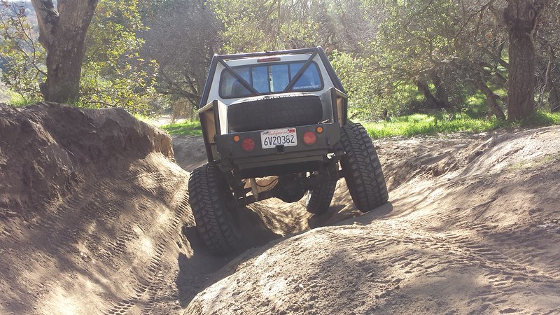

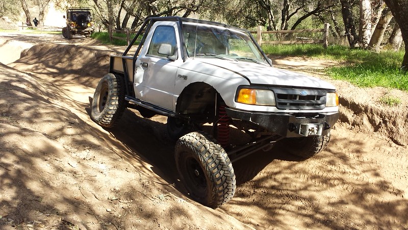

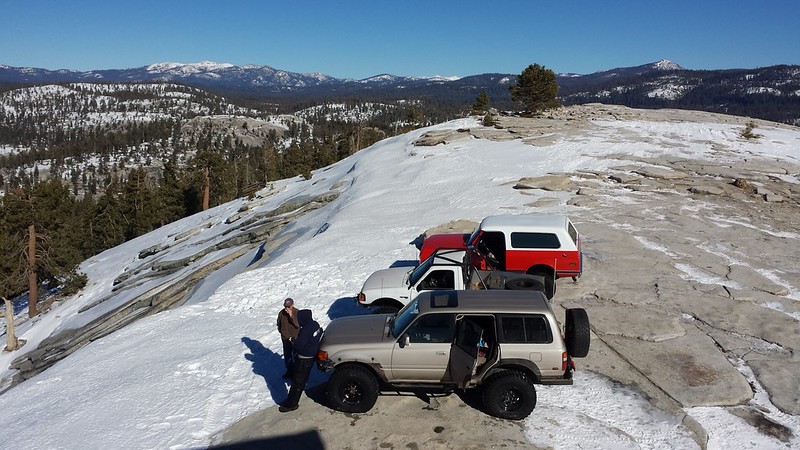

Went to Hollister Hills OHV area yesterday for the day. I kept it pretty calm because I was there by myself and was mostly just seeing what was there sense I haven't been in at least 12 years. Good day run place but don't think I could go very often till I would get bored with it.

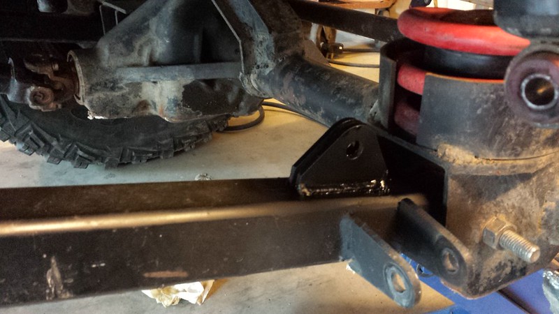

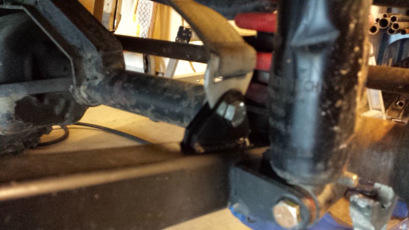

Added front limit straps to keep the shocks from being the limits.
20150131_164946 by dresselhausfc, on Flickr
20150131_165210 by dresselhausfc, on Flickr

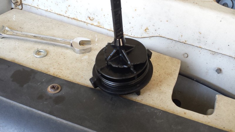

Been doing a few things to the truck. The York mount I built previously allowed the pulley to make contact with the hood when flexed up. I built a new bracket lowering the pulley another quarter inch. Hope that is enough cause that is as low as I can go. It is so tight I had to modify the PS cap so I could get it off with compressor mounted. I also had to counter sink one of the bolts grind a bit on the bracket to get the PS open.

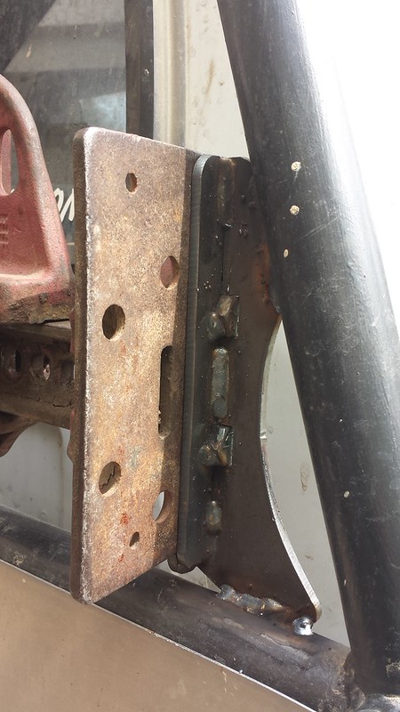

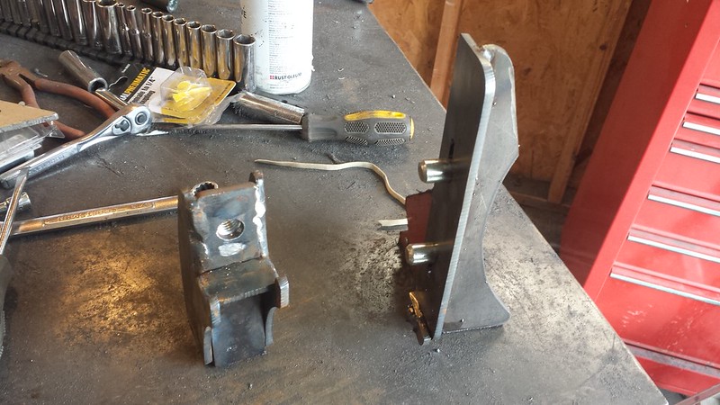

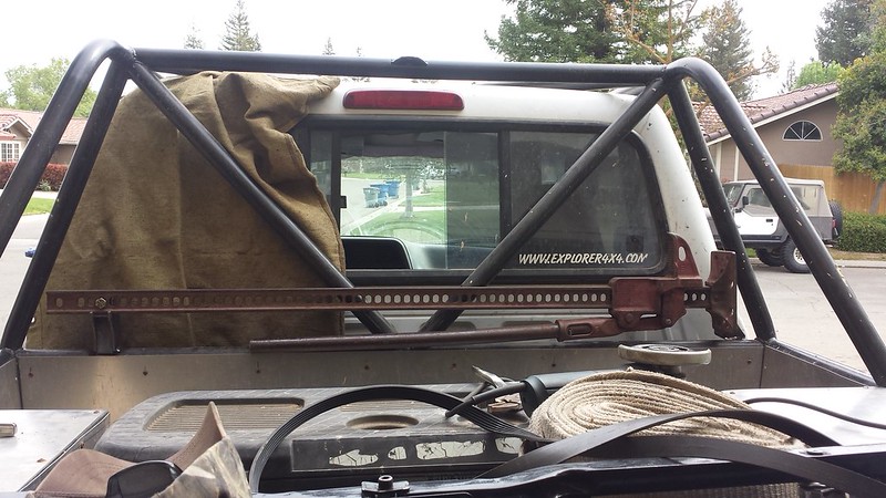

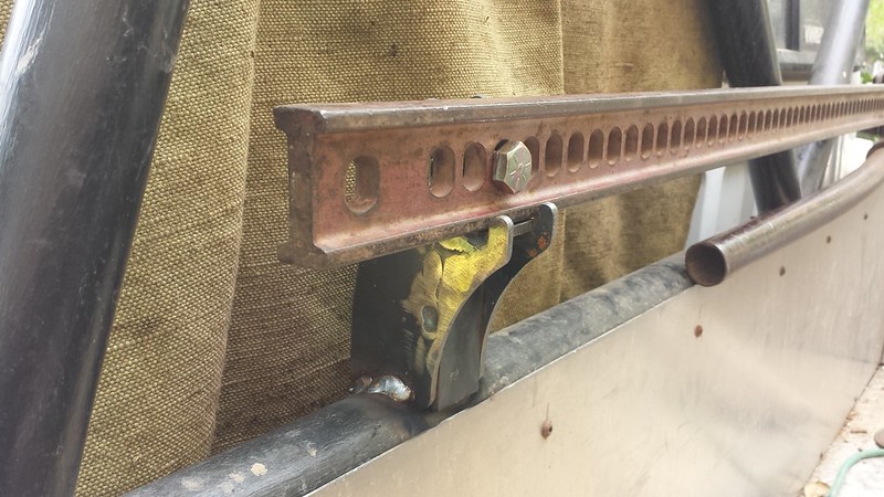

I also made a mount for my hi lift jack. A 60" jack is hard to make fit but was able to mount it across the bed under the back window. I did not want huge brackets that might be in the way if I ever need to take it off and haul other items. I ended up capturing the base plate with two cut off bolts through existing holes. The other end drops onto a bracket and then a bolt holds it. I plan on changing the bolt eventually to make for toolless removal.
20150317_113753 by dresselhausfc, on Flickr
20150317_120709 by dresselhausfc, on Flickr
20150317_120725 by dresselhausfc, on Flickr
20150317_120756 by dresselhausfc, on Flickr
