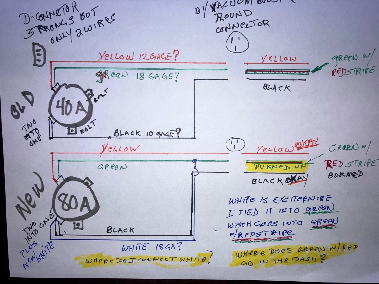

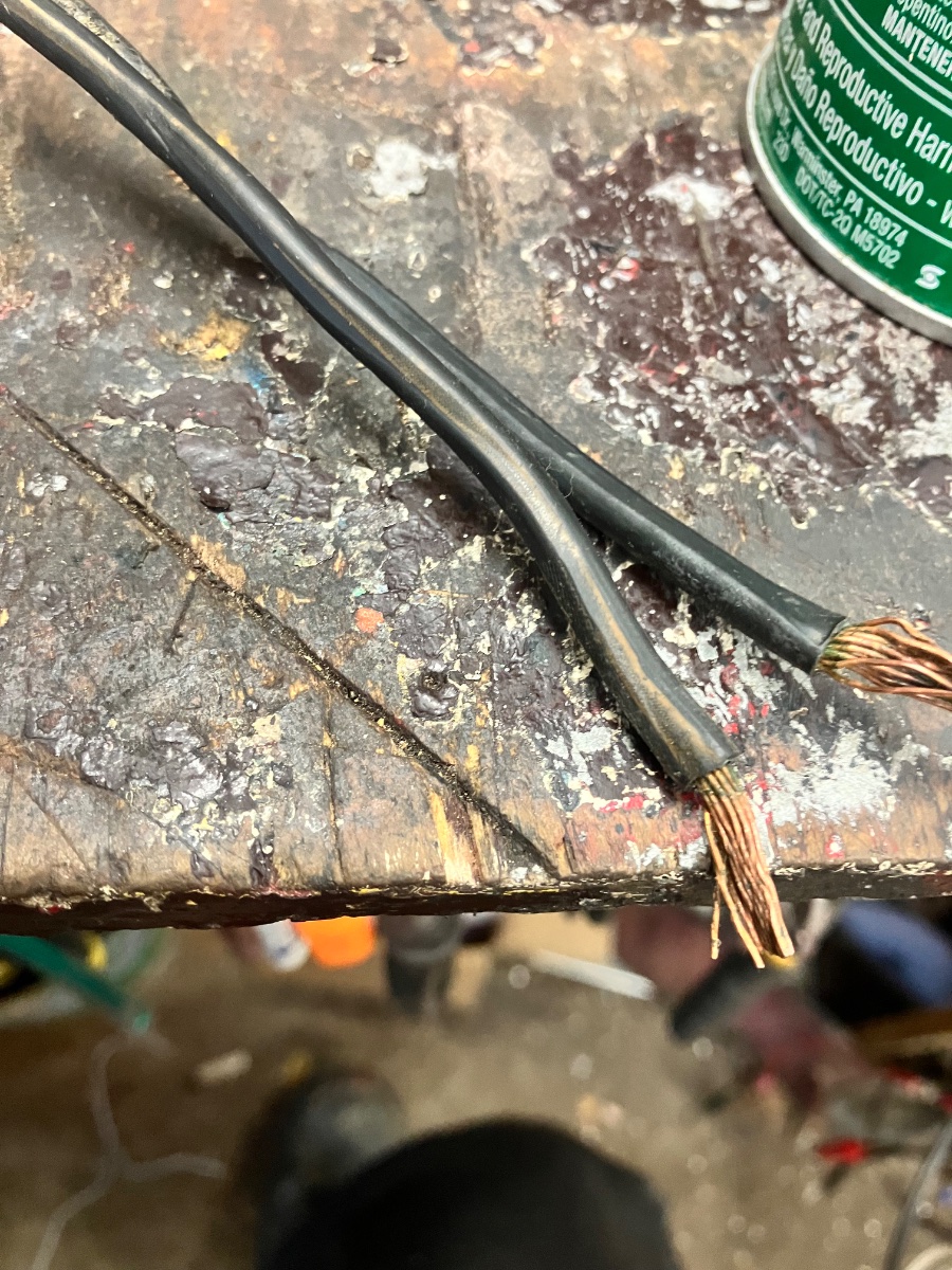

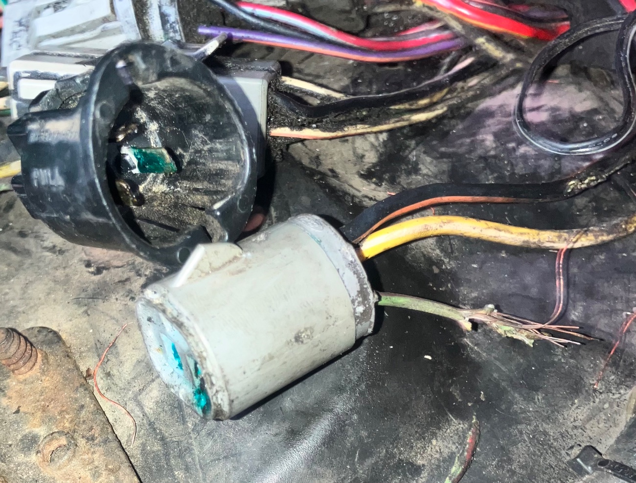

I hooked up the new alternator, the way it showed all over the Internet, and I burned up a wire in my main wiring harness. Frustrated, not happy

OLD 40A & truck wires: It has a 3-prong “D” connector on the top, but only two wires: a skinny green wire and a heavier yellow wire. On the bottom side, the main power wires were made right into the alternator (no connector) with a 3 foot lead that went over by the firewall in front of the driver. The original had two black wires that connected together about 8 inches from the alternator.
That skinny green wire, wider yellow wire, and the heavy black wire go across the engine to a 3-prong connector that goes into the wiring harness under the dashboard. On the dashboard side, the yellow is yellow, the black is black, but the green transitions to a green with a red stripe on the truck side of the connector.
NEW 80A: The new alternator has the female for the D connector. On the bottom, there are two heavy black wires, and a white wire. From reading everything and talking to you guys, the two black wires get connected into one as before. The white wire is the stater/exciter wire, and everything says to connect a power source that only comes on with the ignition, but nothing specifies a good place to do that
In several places, the literature says that that white wire can be connected to the green wire with red stripe, which is the same green wire that comes out of the top of the alternator

So that’s what I did. Two black into one black that stays black after the three prong connector by the firewall. Yellow stays yellow through that connector. The green wire turns into a green wire with red stripe after that connector. So I connected the exciter/stater wire on the new alternator to the green wire coming from the alternator.

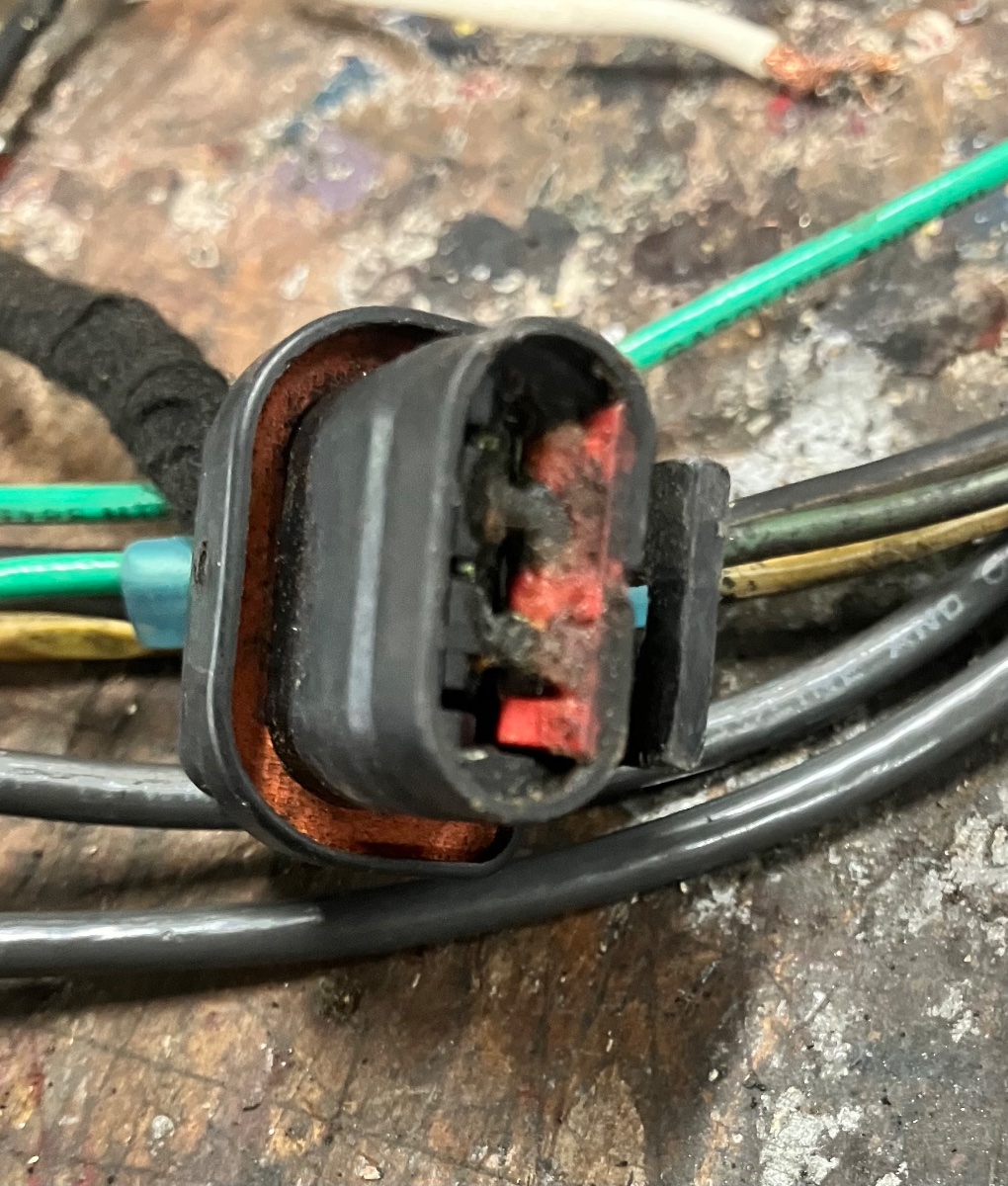

I turned it off when the smoke started pouring from underneath the dashboard then some accessories went dark. It burned up the green wire with the red stripe from under the hood to under the dash.
So, two questions. Where does that green wire with the red stripe go under the dash? Does it just go to the fuse panel or does it go up to the ignition switch or what? I obviously have to replace that wire.
And where in the holy heck should I connect that white wire? Please don’t tell me a source powered by the ignition, please tell me specifically what wire under the hood by the brake booster I should tie into.

Old alternator and new alternator, both have internal voltage regulator. Physically, they’re almost identical.

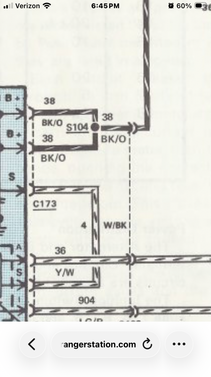

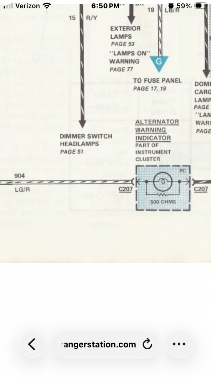

The wire colors you are stating don't make sense with the diagrams. The Light Green wire with red stripe comes from the battery charge indicator lamp in the gauge cluster. It should not be connected to anythung else. That 12v circuit comes from the ignition switch.
Here's part of the diagram. I'll post the other page in a minute.

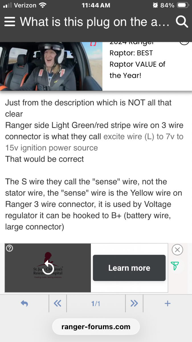

Amen to no sense, but just fyi, when they tell you how to put in the upgraded alternator, they say to attach that white ignite wire to the battery idiot lamp. The concept is that when you turn the ignition switch on, it gives power to that lamp, which lets the alternator ignite, and then the light goes out, and therefore cuts the power on that line to the alternator. I don’t think I even have an idiot light for the alternator in this truck, it just has the gauge. In that clip I posted above, it specifically says the green wire with the red stripe…

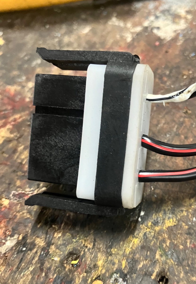

New alternator connector with the extra white wire, the ignite wire:

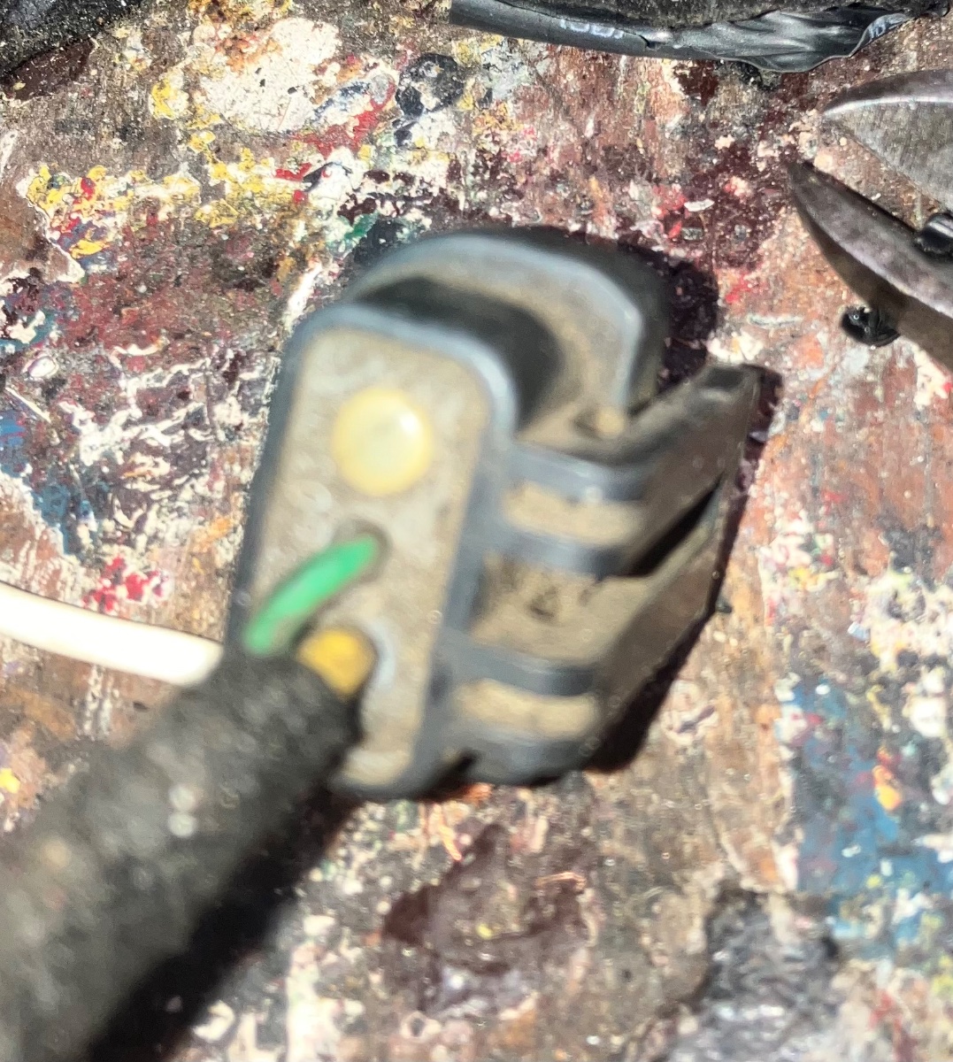

“D” connector on the top of the alternator. It is a three pin connector, but one of them is not connected and it’s just plugged:
And here is the three pin connector that is over underneath the brake booster. The green wire from the top of the alternator goes through that three pin connector into the green with red stripe wire. You can see where that wire is burned up:
First question, to repair the burned up wire, does anybody know how that is routed up to the ignition switch? Does it just go from this plug to that switch, or is there a branch off somewhere? I’m just about to pull the column apart to try to chase it down. May plan is to just cut the old wire at both ends and run a new wire outside the harness. I already stripped down the harness from the alternator to the connector under the brake booster and replaced the wire there.
Second question, the original question, what should I connect that white wire to that’s around the brake booster? I’m looking for something I can see, not the wiring diagram*, if possible. Otherwise I’ll just find something in the fuse panel that becomes hot when you turn on the key.

On the new alternator, the bottom plug with the heavy duty wires are two heavy black with a red stripe, and the white wire that has a thin black stripe. However, there is no confusion that those two black red wires are in the place of the two similar size solid black wires from the old alternator.
The new additional wire, the white wire with the little black stripe, is described in the instructions and all over the Internet as the stater/exciter wire. There’s also no confusion that that is supposed to connect to a circuit that only becomes hot when you turn on the ignition, but there is no further suggestion on which circuit you should connect to. Apparently that stater/exciter wire needs voltage from the ignition switch to start the voltage regulator, but it doesn’t have to maintain current after that. The Internet and literature all say to connected to the trouble light bulb for the battery if you’ve got one.
The bed information I got was that the green wire from the top of the alternator which transitions to a green wire with red stripe at the connector by the brake booster was the place to connect that wire. When I did that, the green wire with the red stripe fried, as well as the line I had run to the white wire with black stripe the 3 feet across the engine.
Update, I fixed the harness from the alternator to the connector by the brake booster. I got upside down and backwards and took out half the dashboard, and I found where the green wire with the red stripe was fried. I’m still not sure where it goes up towards the steering column, but it was only burned for about 12 inches, 6 inches inside the fire wall and 6 inches outside the firewall. A couple other wires got a little scorched, but nothing seems to be damaged. I have yet to put it back together.

Having been appropriately chastise by the den mother hound, I took a closer look at the original wiring. The wire I was calling yellow, is actually a yellow wire with a white stripe. You couldn’t tell that until after I put some brake cleaner on a rag and wiped it off. That matches your wiring diagram.
On the old alternator, after I really scrubbed it with brake cleaner and a scouring pad, you can barely tell there’s a stripe on the black wires coming out of the alternator, but they don’t look orange to me, but they’re so old and dirty they could be anything.
Finally, the diagram shows the green wire with a red stripes, going to the alternator warning light. Again, that’s where the literature/Internet suggest that I connect the white stater/exciter wire, which fried it. this truck does not have an alternator warning light.

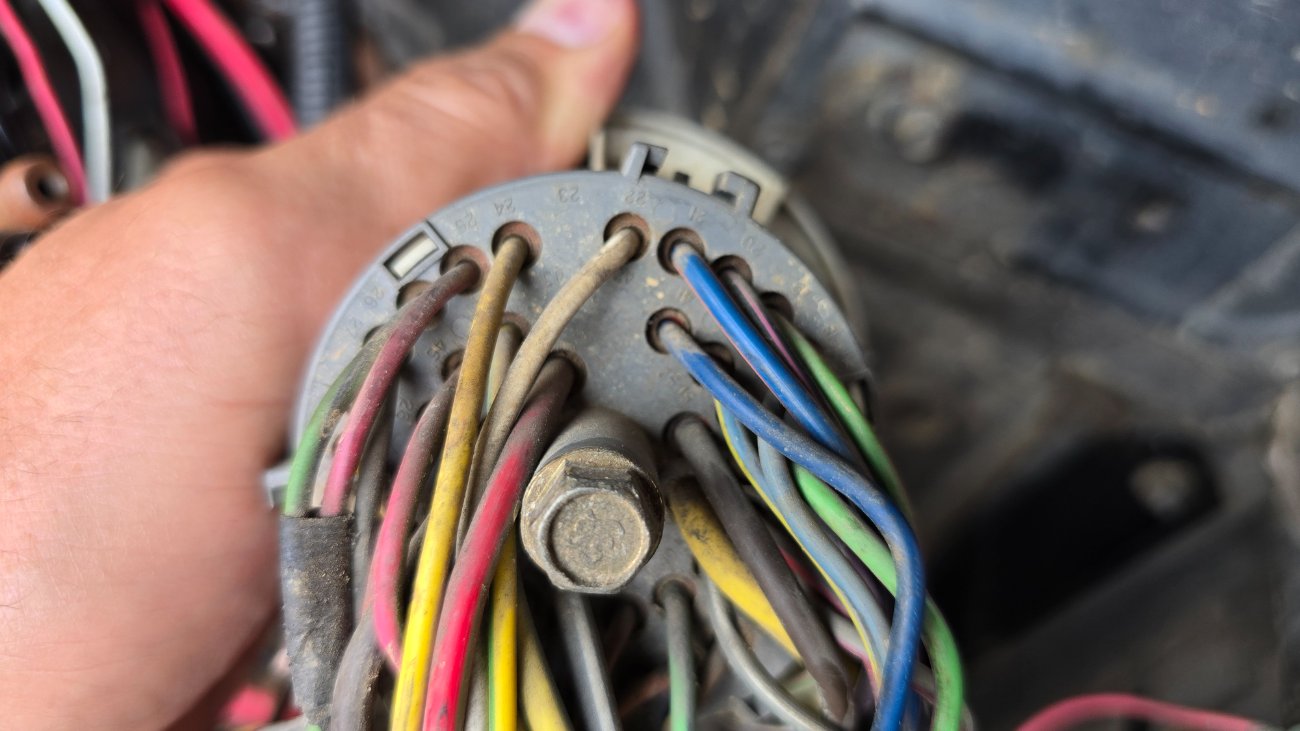

The LG/R wire is going to one of the connectors on the back of your gauge cluster. Once you pull the bezel and then get the cluster out, you will have access to inspect the rest of that wire for damage. You might need to remove some tape from the wiring harness.
I must admit I'm not sure why that wire melted. It should see full battery voltage. Connecting it to the LG/R wire puts it in a position where the resistance of the circuit (the lamp and the resistor in parallel with it) produces a condition where current in the circuit means that that resistance drops the voltage enough that your B/W wire is not seeing full battery voltage. That may be what happened.
That still leaves us with the issue of where to connect the B/W wire. The wiring diagram shows it looping around to the S terminal on the alternator. There is a note in my 96 explorer book that says that connection is only for 4.0l equipped explorers, indicating that it is not always needed. Another note explains that that wire "feeds back a voltage signal from the generator to regulator, typically half of battery voltage, used to turn off the charge indicator." That was slightly paraphrased. Try running it with that w/bk wire not connected. Just tape over the end of it. Let's see how it acts that way.

I already have the dash cluster out. I don’t see any damage on the dash cluster. I took it out because I wanted to upgrade the turn signals to green LEDs to hopefully make them brighter. I’m at that age where I ride down the road with one of them flashing sometimes. I have the four gauges, and I don’t think there’s an alternator light, but I’ll look close-up on that tomorrow before I put it back in.
