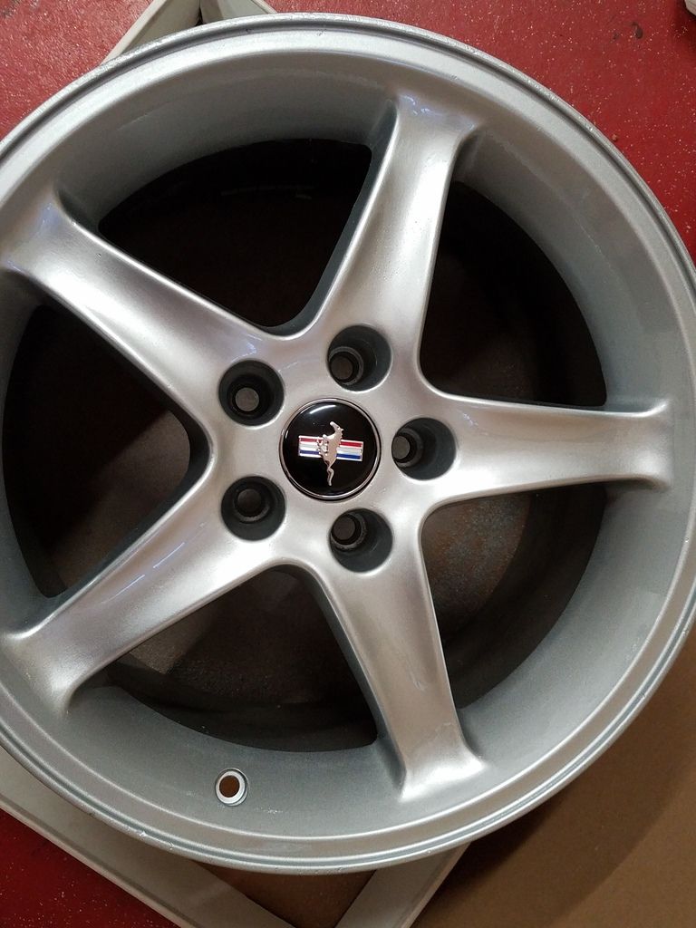

And these are the Cobra R's that I picked up cheap.

The R's are going on first.

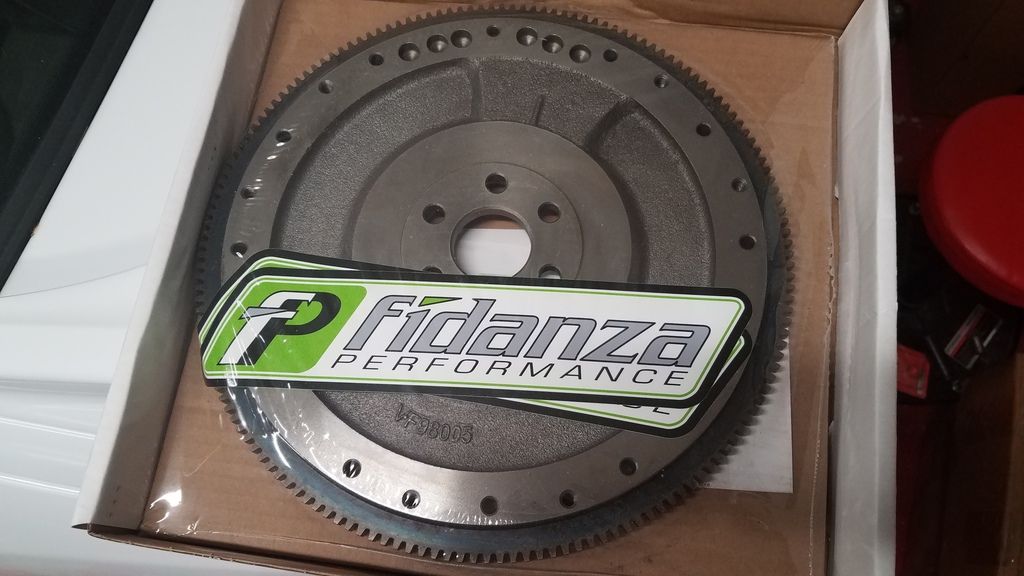

Ze flywheel iz here! Really nice piece.... It's a 28 ounce Fidanza for a 10.5" clutch. The King Cobra clutch (stage 2) should be here tomorrow.
