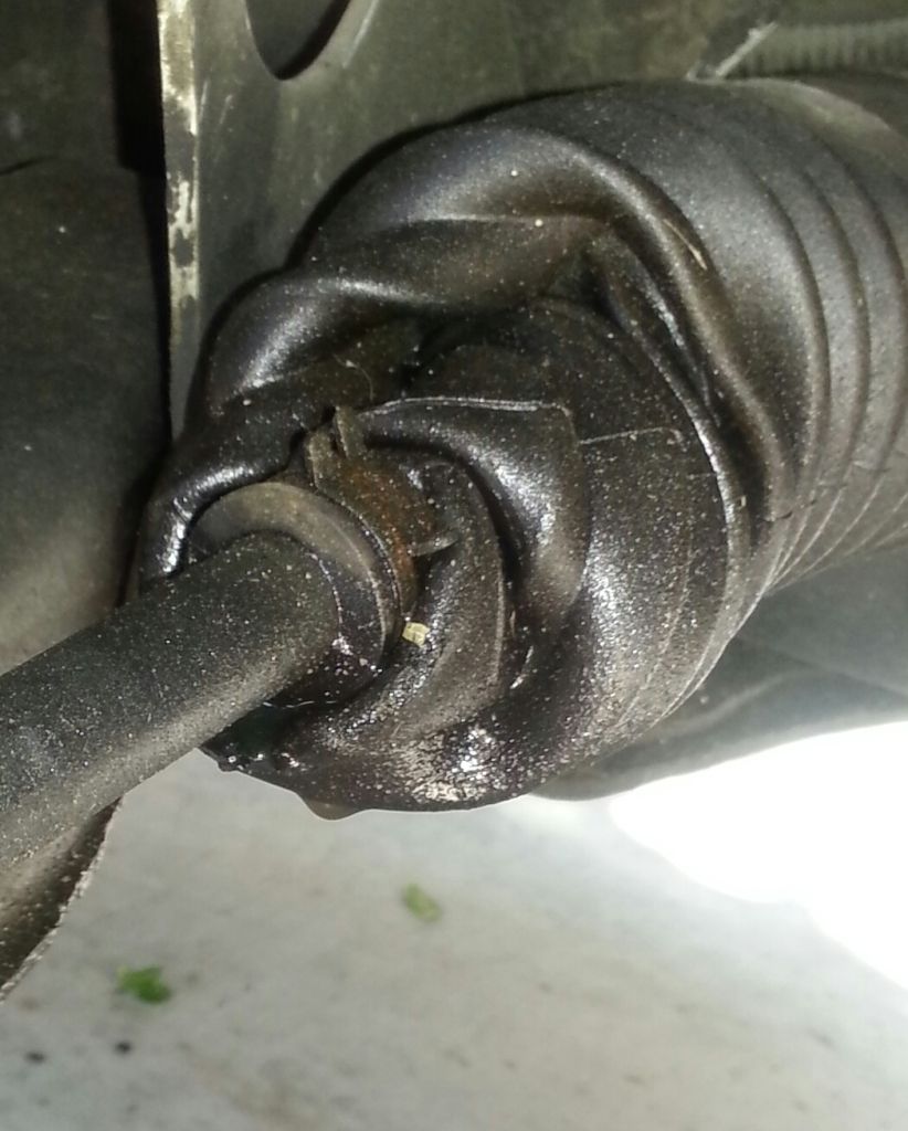

And now for the reason the project was started. Every time I turned left, this boot would piss power steering fluid. You can see a drip forming on the boot in the pic. What a Sorry excuse for a boot it is too.
