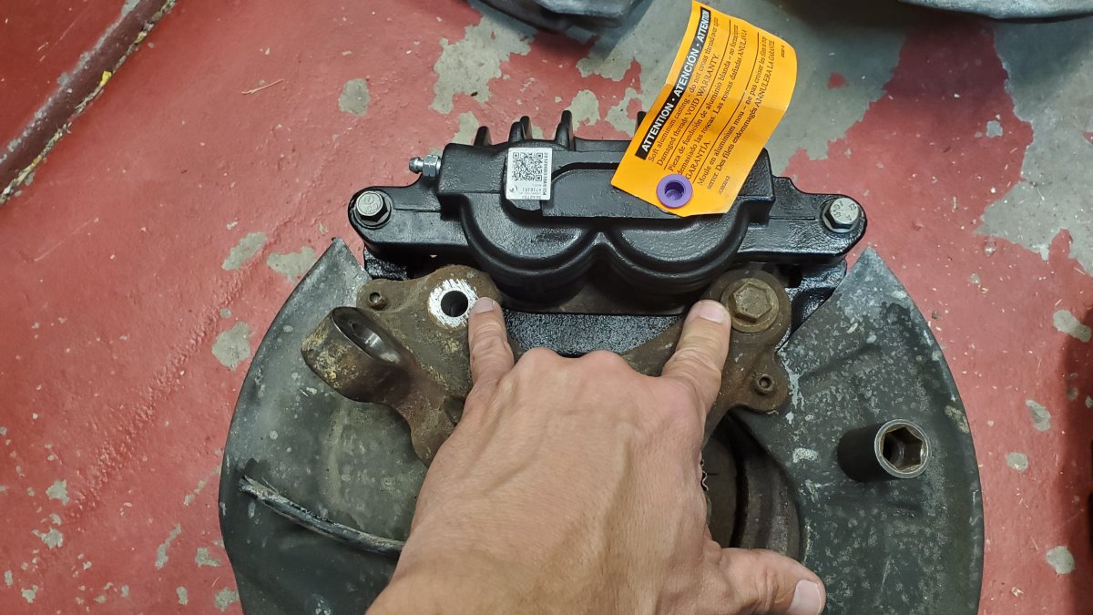

Just picked up some SN95 front brakes for my 89. Going to try and adapt to New Edge Calipers. I've seen it done doing some grinding.
SN95 brakes is the way to go on those cars. My brother did that swap with some ssbc calipers if I remember correctly.
I have sn95 brakes on my 65 lol. 4 wheel manual drum wasn't cool after you pass 90 hp of the stock 225 inline.... I did no grinding, one adapter and they bolt right on. That's why I love mustangs, everything fits and if they don't, someone makes an adapter. I run a 289 with a holley sniper system, I guess it's like 275rwhp. Not a beast but it moves.
I'm going to go out and try to see what needs to be done. I am wanting to put the PBR calipers off a 99-04 on it. I have a couple brand new calipers, as well as some used.
Nice to see you're still around BlackBII!!
For the record... with some MINOR clearancing, the PBR dual piston calipers will bolt right in to place! Man, I really excited about this.
Just some light grinding where my fingers are pointed, and it's in!

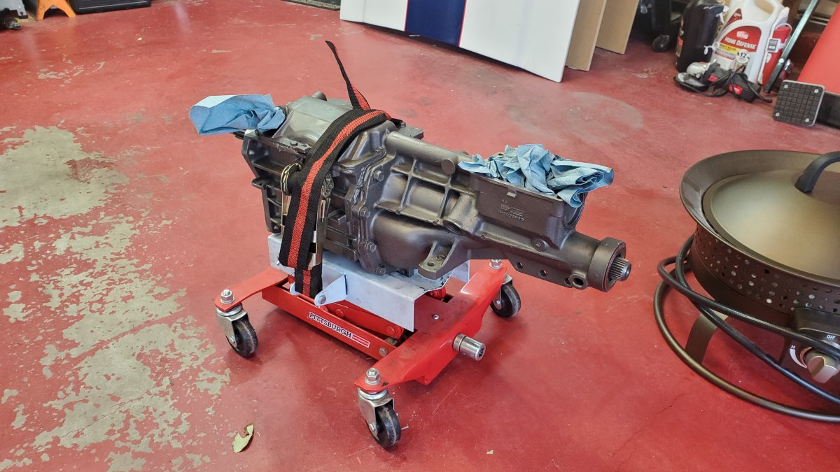

I pulled the tank out of my 88 over the weekend to replace the pump, filter, fuel level sending unit, and wound up needing to replace the filler neck grommet too. I'll be hitting a car show with my 89 this weekend.... just not sure WHICH car show yet.

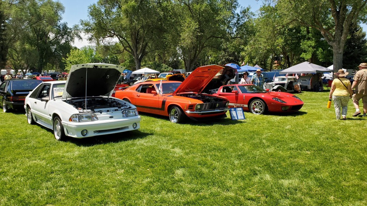

Also, this was from the All Ford show I did back in May.... LOTS of beautiful Fords there.

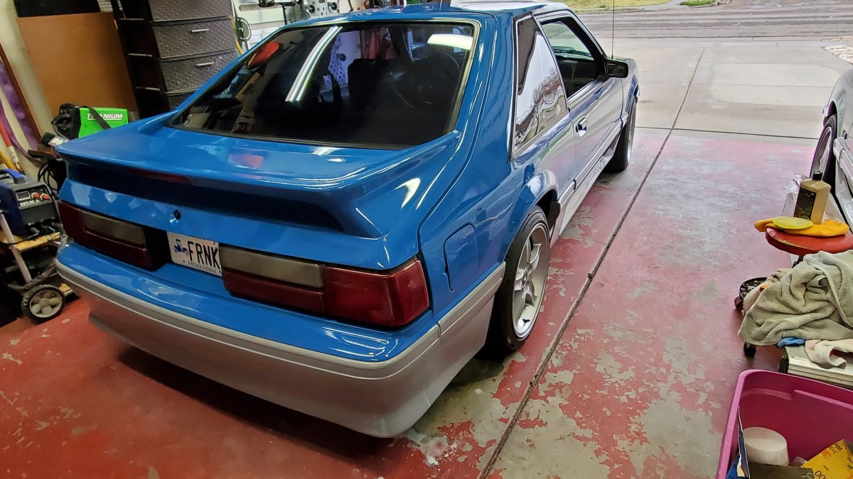

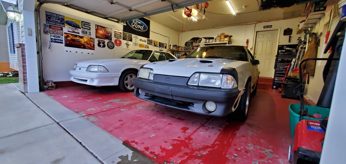

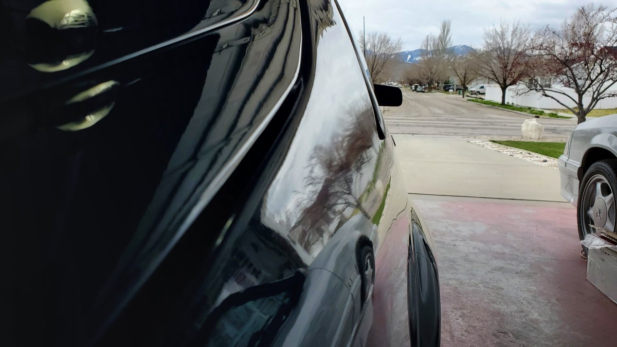

Well... I figured I'd come back around and show what my 88 Mustang project is looking like now. This is my first paint job. It cost me well under 400 for the paint and supplies.

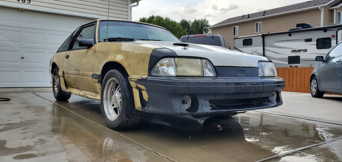

The day I got it home... June 16, 2020:

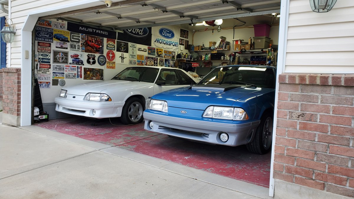

The two side by side that same day....
Side by side now....
EDIT: Paint cost details =
HOME DEPOT
Rustoleum Royal Blue: 2 qts X $16.48
Rustoleum Smoke Gray: 1 qt X $16.48
Kleen Stip Acetone: 1 gal X $22.96
Quart Size Mixing Cups: 8 X $1.98
Medium Mesh Filters 4 pack: 4 X $1.28
Husky Spray Gun Filter Kit: 1 X $13.98
30 pk Quart Stir Sticks: $1.48
TOTAL: $107.34
OREILLY AUTO
Master Pro Primer: 2 X $22.79
Master Pro Activator: 1 X $43.99
TOTAL: $89.57
TRACTOR SUPPLY
Majic Catalyst Hardener ½ pint: 2 X $21.99
TOTAL: $43.98
HARBOR FREIGHT
Central Pneumatic Gun: 1 X $16.99
Gun Cleaning Kit: 1 X $4.99
TOTAL: $21.98
AMAZON
U-Pol 2K Clear Coat Kit: 1 X $72.50
TOTAL: $72.50
GRAND TOTAL: $336.85
