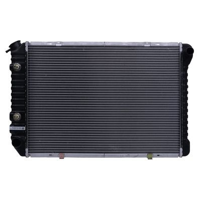

I just went and picked up the radiator this morning. It is an aluminum unit, as pictured:

Your car is an automatic?
No, this is a universal radiator for either transmission. It is what became my warranty replacement at Autozone. It is actually the only radiator they carry for it.
