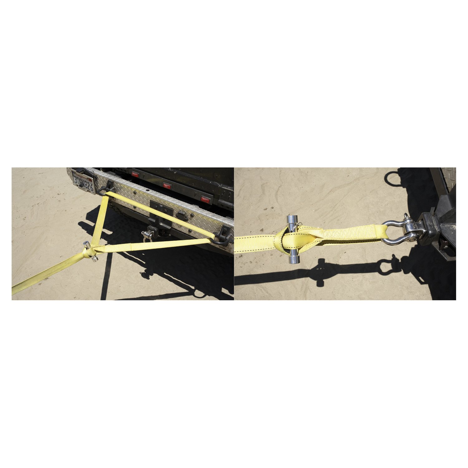

the strap is 5 years old, it just ripped the looped end off for some reason, really clean tear to as well, not many stringers. the strap on amazon is like 25$ now days, not a whole lot. ill honestly probably never use it again untill my kinetic strap breaks.

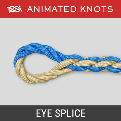

Ran across the website that I used for repairing an eye splice. They have animated gifs for almost all knots.
There's actually a better way than that one Always. I first weave the eye and then on into the shank.
It's basically the same also with a wire rope excepting the shank there just gets clamps(weave it around the eye and bring it back together and then weave the tail, then clamp it) Cable clamp saddle always goes on the live side
