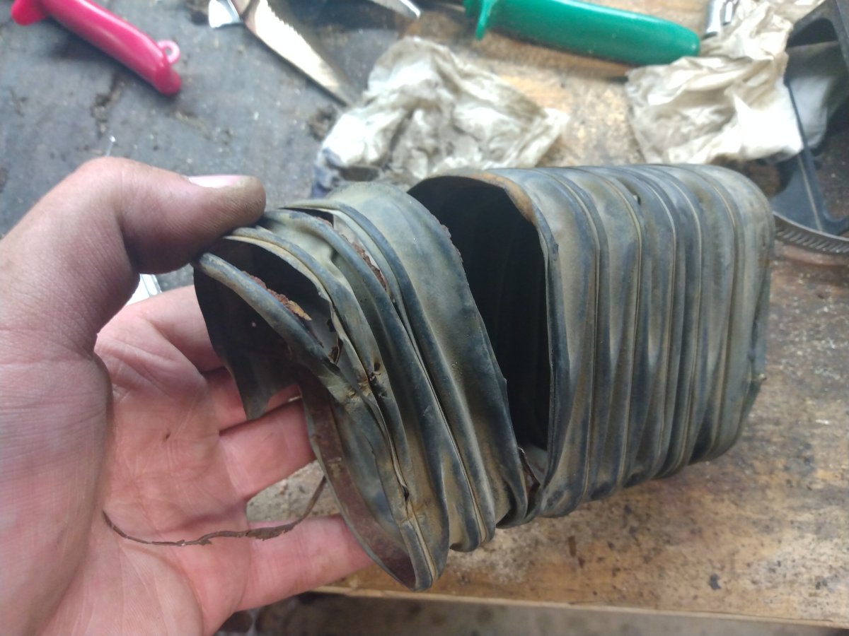

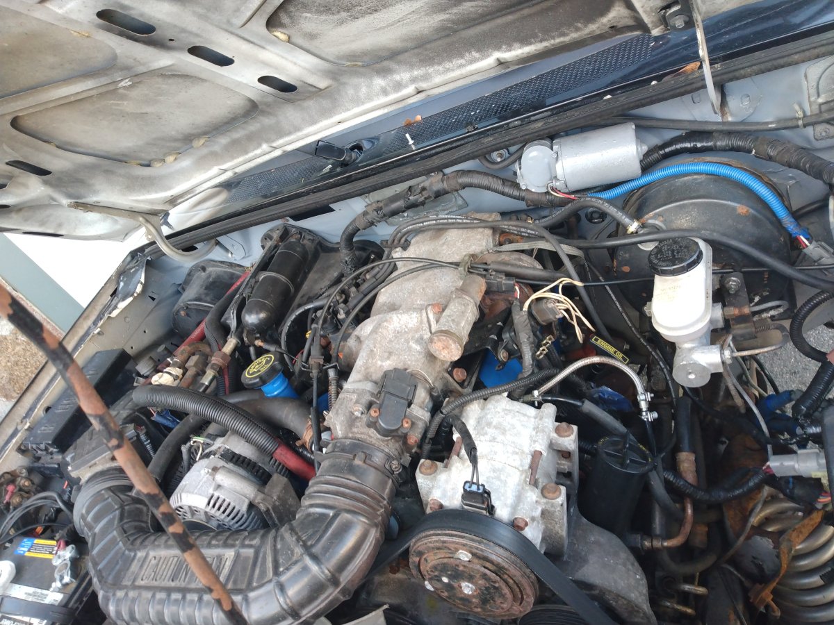

Starting at the throttle body working back is the intake tube. Nothing special is going on here other than me repairing vacuum leaks in the pleats with electrical tape. The rubber seals between the air filter box and throttle body are perished and temporarily fixed with RTV. These are actually pretty hard to find in my area. (If you have one for sale in good shame DM me.)
Next we have the air box. On the lid is a vacuum tee with a reference to the inside of the box after the filter. This passes vacuum to a diaphragm described later. I believe this fitting is here in the lid is to check that the air filter is flowing enough air. If it is getting clogged it cuts off vacuum.

I fitted the old snorkel back to the hole in the air box. This runs under the battery tray to a vane connected to the vacuum line mentioned above. When there is no vacuum applied, air continues through a duct to a cutout in the firewall. I made this by taking round duct and squashing it rectangular with a 2x4. This lets ambient air go directly into the engine from the front grille. The original ducting had torn and the structural wire inside rotted away. The replacement duct was grabbed from McMaster and I chose a size ½” too big. This doesn’t need to be air tight, but its an unfortunate error on my part.

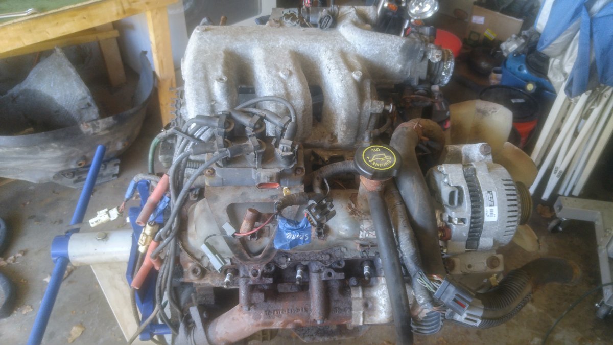

When the engine is under vacuum, the vane directs air from the side of the snorkel to the passenger side exhaust manifold. This tube was completely missing when I got the Explorer. My only hint of what was going on was a severely corroded heat shield on the manifold. This pulled hot air off the exhaust into the engine to reduce its density and fuel consumption under light loads.

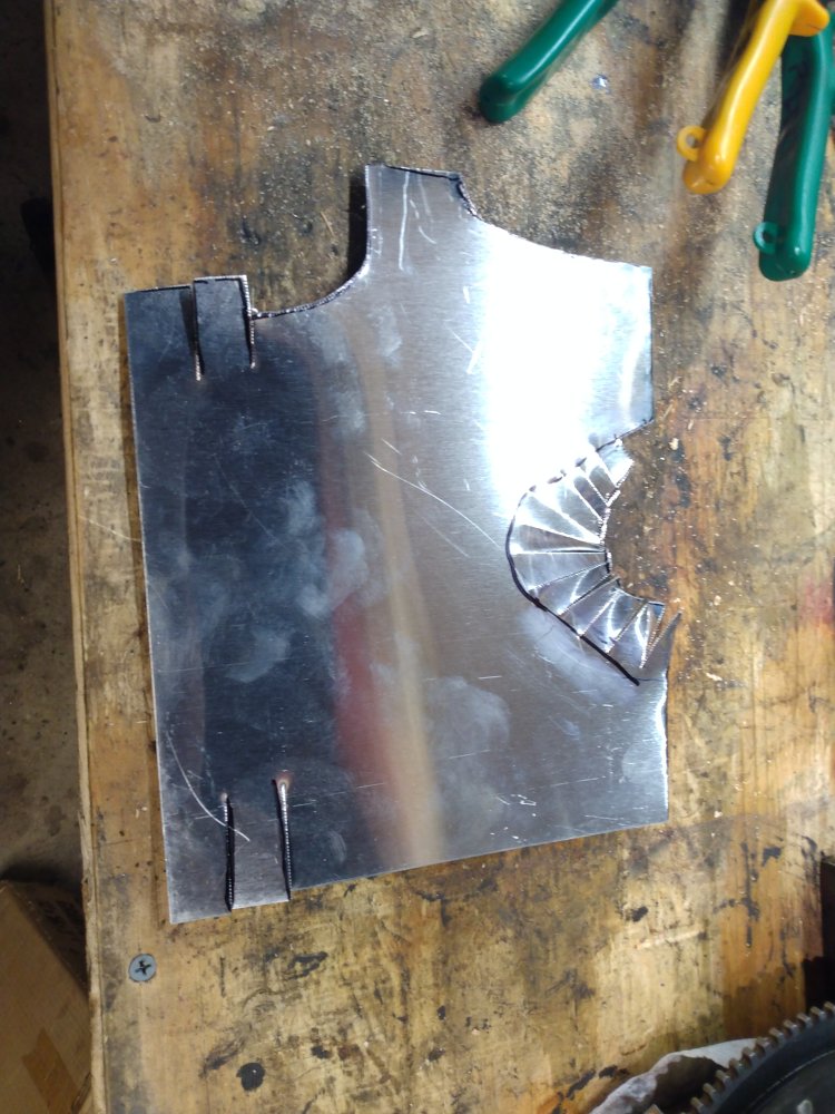

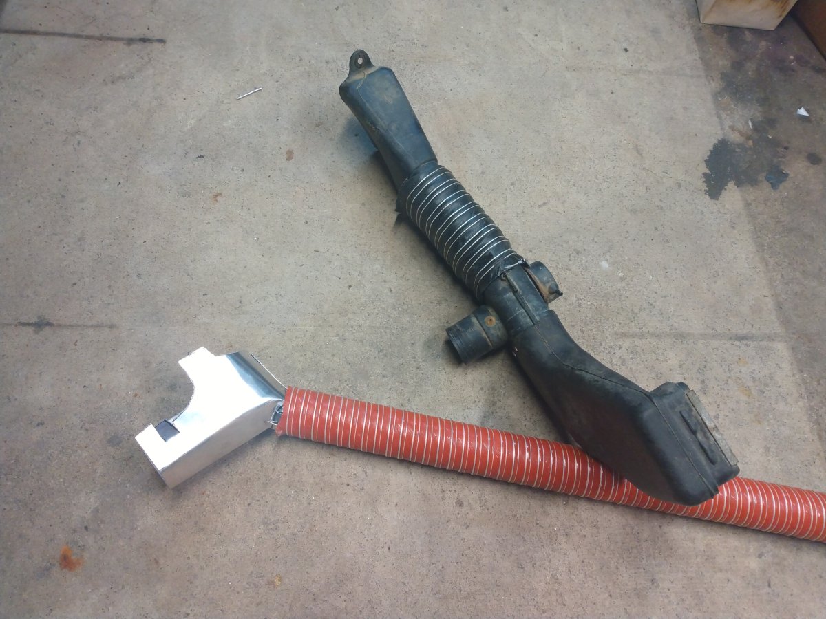

I bought some thin aluminum and tried to recreate this heat shield. The aluminum was cut into shape and bent over a couple of 2x4 sections glued together. I pop riveted the front and tried to do some complex geometry to make a flange for the ducting. The image below was actually the penultimate design but highlights what I was doing. I drilled a hole in the top to align with a hole above the exhaust port in the head. To hold the rear part closer and prevent rattling, I found a Ford hose clamp and screwed it tight. I did not succeed to get it contour the manifold as tightly as factory, but I think it will be an improvement over my old system.

I think you are under a misconception of what the ducting for the air cleaner box is for
The vacuum ports on the top cover are hooked to a bi-metal valve inside the cover, strictly temp controlled, so needs no electrical connection
This valve sends vacuum to activate the warm air valve that is on the air intake hose between the air box and rad support(CAI)
A cold engine will warm up faster if it uses pre-heated air, so a "chamber" is built around the front of the closest exhaust manifold, exhaust manifolds heat up very fast once engine is started, these "chambers" are not air tight just need to warm up the air which is pulled into the air cleaner box
This is actually an Emissions requirement now because cold engines are big polluters, so the faster they warm up the better
But this method to get pre-heated air has been used since the 1950's just for faster warm up
On carb'ed engines it was just more obvious, the Drier Vent size tube from center of engine air cleaner down to exhaust manifold's "chamber", lol
Every gasoline engine vehicle must have this.
Whether or not it's in working condition is another story, the pre-heated air tube will disintegrate, and any engine work on the exhaust manifold will usually find the "chamber" still in the parts box after reassembly, lol
But it is only used when engine is cold, so most do not miss it, and the air comes from in front of the rad support(cold air intake) as soon as possible, coolant temp at approx. 140degF
Not part of any MPG strategy
Just used to warm up the engine faster
Colder air does allow more gasoline to be used to get more power, the point of a CAI, and why car makers have been using those since the 1960's
But MPG will stay the same if you are not using that extra power for fun stuff
Once an engine gets coolant to 190degF the MPG is the MPG, your right foot has more to do with that than outside air temp
Under 190degF coolant the MPG is lower, so the quicker you can get up to 190degF the better
