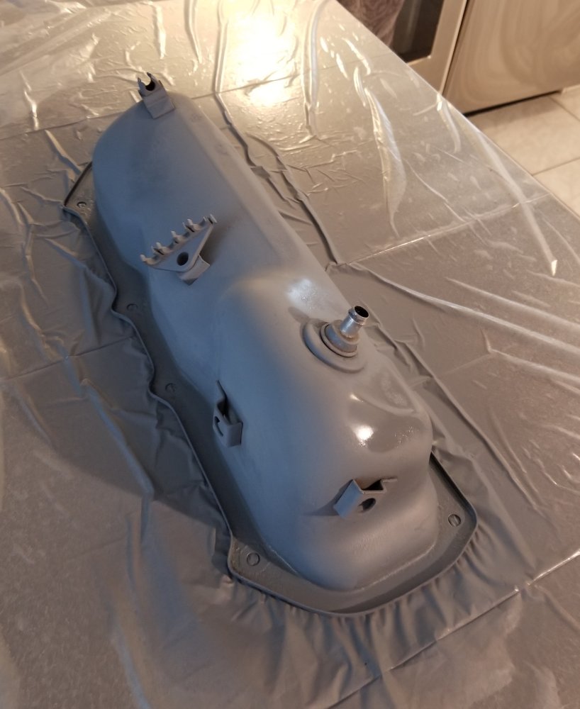

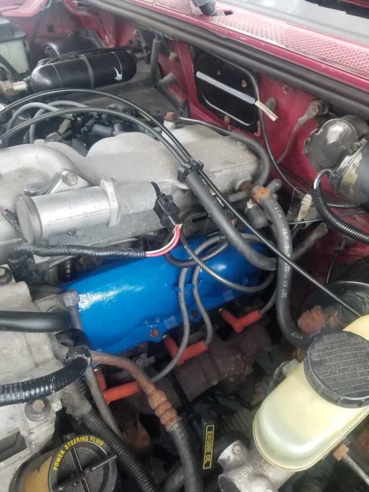

Exactly, that's why I went online and searched everywhere, and on eBay I finally found one, it was a junkyard cover but salvageable. And mine was rusted out and leaked on the manifold after a long drive also.
Here's how it was from junkyard, before and after pics.
75030
75032
75033
75034
Here's the old one, as you can see the leak.
75035
The driver side cover can be repaired with enough determination & patience.
I was in the same boat about a year ago (not quite as bad as your rusty cover pic, but leaky enough above #6 cylinder to burn a plug wire).
Here's a picture of my solution: cutting off the old flange, using it as a template for a new flange made out of 3/16" stainless flat stock.
It was my first stainless welding job that wasn't exhaust pipe. The whole project took about a week of nights, at least 20+ hours. It failed multiple leak tests until I got everything stitched sufficiently, with plenty of burn-throughs. I'm glad I sandblasted thoroughly, which revealed pinholes below the PCV port that also leaked.
Even with short stitch welds, the whole thing warped horribly and shrunk across the short side. I over came that with a couple hours back and forth to a 50ton press to spread the long sides back into spec. Then another few hours with a hammer, a vice, and finished with a flat file for a uniform sealing surface.
Quite a challenging project, but 11 months and 5,000 miles later, I'm happy with the result. Leak free and still looking good.

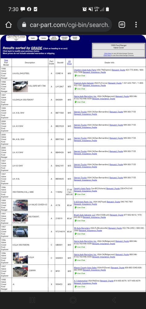

Edit: whelp... for some reason the car-part.com link didn't work.... but there had to be a dozen or more listed in good shape.
This is a right side cover.
Yeah I know. I bought the left one from him on eBay a few weeks ago. If I couldn't find the left, I woulda used that one on the left side. A friend said it would work. But no PCV inlet. Your thoughts?
