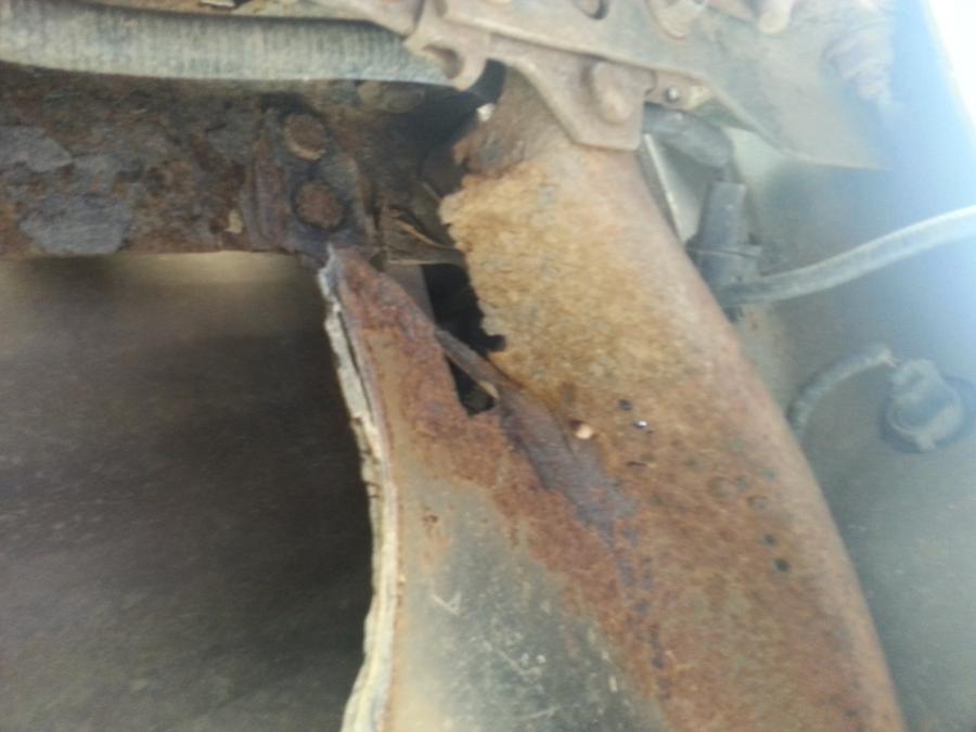

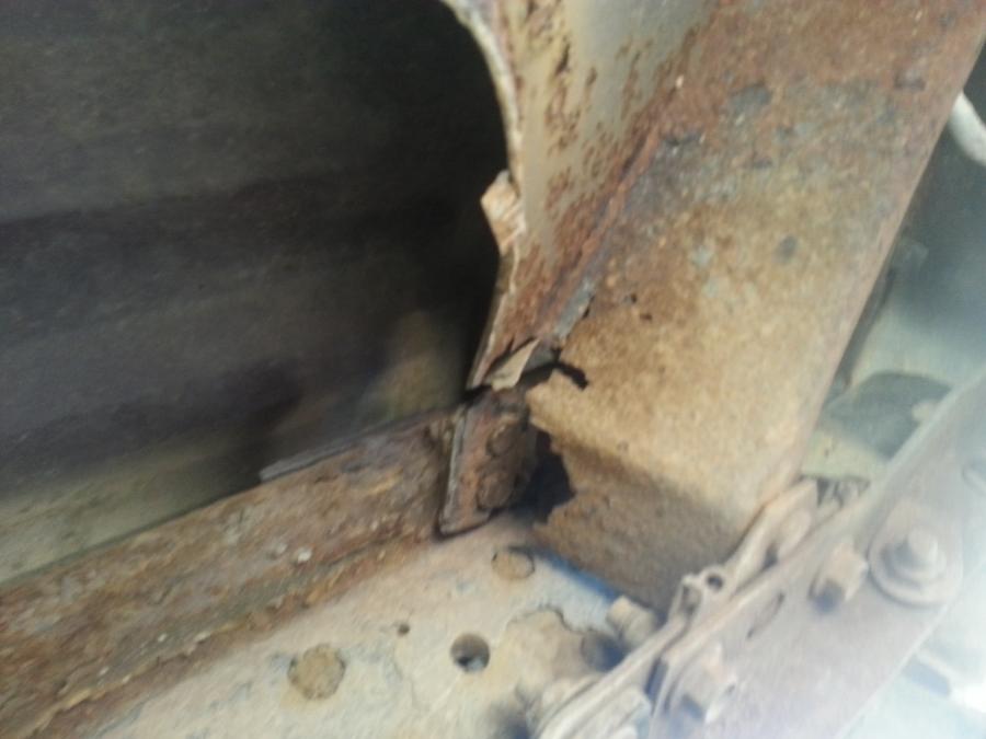

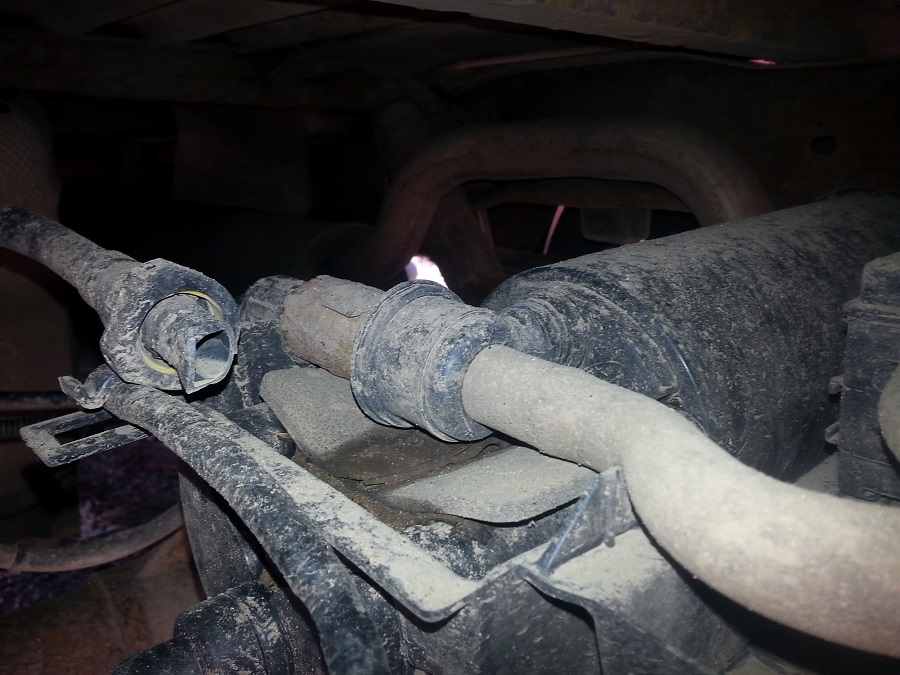

Ok, so this winter was pretty hard on my undercarriage. The spare tire mount has almost rusted completely off. Rather than replace it, I figure I'll just remove the mount and tire and save about 200+ pounds. Only, I found a problem. The charcoal canister is mounted to the spare tire mount; I would hate to have to weld a new mount up just to save the charcoal canister, so I'm going to take it off. Everyone I ask either doesn't know what I'm talking about, or can't give me an easy straight answer. So What all needs to be done to remove the charcoal canister and keep my truck running smooth?

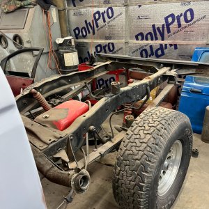

I agree with most of what you're saying. Except for, 1. I will save 200lbs. I already removed the tire to try and keep the mount from completely breaking off, and I felt how heavy the mount and crank and canister are, combined I will save 150-200lbs. 2. The spare tire mount doesn't appear to be a frame crossmember; there is no way that a thin piece of metal that is hanging below the frame could be a major structure point. Im pretty sure that's what the large crossmember above the axle and at the rear of the bed are there for. 3. I have had quite a few knowledgeable people who say that the charcoal canister does very very little for your fuel economy. Also, here in Michigan im 98% sure we don't have any emissions laws other than requiring a catalytic converter. Another piece of information, the overflow line from the gas tank to the canister broke off, so i'm already pulling vapor codes and I'm not getting any worse gas mileage then when the truck was new.
  • Removing the Charcoal Canister
More pics
Take away all the rotten metal you want. Leave canister and plumbing in place tied to something that is staying with wire or cable ties,etc. It is easier to keep the system stock, than to deal with the work arounds needed when you delete stuff. :D
Issue to be mentioned "Already pulling codes". At this time you know it's that code. Yes it trips the light. However if your truck had/has another issue, you'll never know it because the light is already 'on'. Unless the driveablity goes down the drain--quite a few times before the truck/car goes "limp" it will trigger a code before it gets that bad.
It's easier just to fix the line and return the system back to stock, then to argue back and forth.
