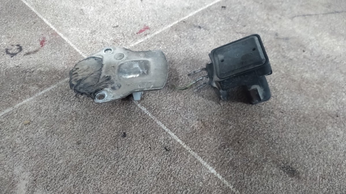

I seem to be finding conflicting information about this topic. The truck in question is a 1994 Mazda B4000 that has the early style cam synchronizer with the window on the top. Someone prior to me broke the electrical connector off the back of the sensor and it's just dangling. I would like to fix this and have found information regarding how to remove the sensor on 95 up but not one single post about my style of sensor. It appears that there is a metal cap holding the sensor in place instead of the sensor simply being screwed to the top of the synchronizer.
Sooo with that being said...before I tear it all apart... RockAuto, AutoZone and Advance have a sensor listed by itself but it looks different than what I can see. The connector comes straight out the back instead of at a 90 degree angle. Also maybe looks like it won't fit under the metal cap.
I may just be able to fix the one I have, anyone run into this situation before? Rather not have to buy a whole synchronizer if just the sensor can be replaced.

Well I found that you can indeed remove the sensor. Two screws and it comes out as I suspected. Now I either need to repair this one somehow, or find a replacement... looks like maybe I can solder the wires, pack it full of hot glue or epoxy and be good to go.
I really do not want to replace the whole thing, the synchronizer itself works fine, the plug is just broke off.

I did an extreme ghetto fix on it last night. Drilled out the rivets that hold the sensor onto the cover (it is NOT simply a button like I imagined, there's a magnet and all kinds of stuff there.) Soldered the wires back together, covered the whole mess in liquid electrical tape, let that dry, and then reattached the connector part with a combination of hot glue, super glue and rivets. I'll keep an eye on it, if it falls apart I'll track down a new sensor.
Lol nice, yep that'll at least buy you some time to parts hunt. Hopefully it works!
