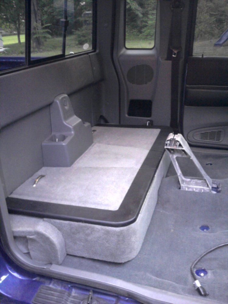

I really like what this guy did for his rear section and will do something similar but I will store the jack under the hinged door instead of leaving that plastic cover in place which takes up room. It allows for some covered storage and a completely flat platform for the dogs.
OH man that is SO cool. Looks like he did a little bit of custom work there. Super nice! Thanks!
I actually wanted some kind of platform so the dog can look out the windows. The only thing I would do different here, if possible, is use recessed handles that would lie flat. But it doesn't look like he's using this for a dog platform.
I think I could make it just a little deeper so maybe it comes up to the level of the cup holders. Then you could really store a lot of stuff in there. And, yeah, like you say, move the jack and cover. It would leave just a little curved place in the trim, not bad. With a bit of plywood and some carpet and a stapler and a few hinges and handles, it wouldn't be too hard to modify this idea just a bit for one's specific purpose.
If you go higher with it, and cover over the rear door pockets, I guess that's not a big deal. Although, it appears, if you didn't drive crazy, you could actually use them for watering dishes.
Depends on how tall you are probably. The higher the platform the less seat travel you have. Water dishes! LOL
