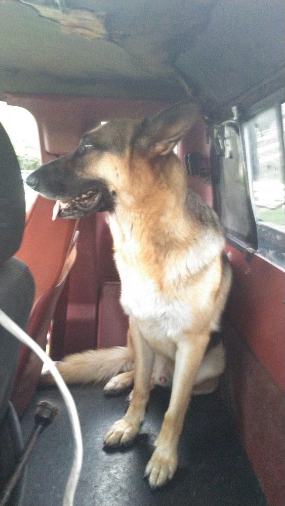

Hopefully a few pics will clear up the confusion. The seats are different across the generations. My seats are still intact...just folded away....

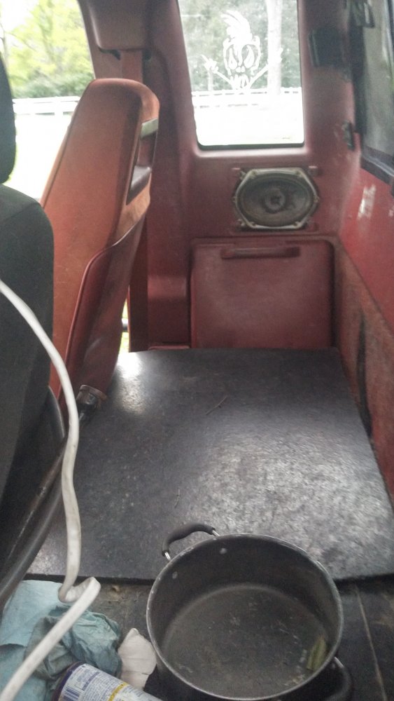

Ah, I took out the 3x 1/2" bolts holding the driver side jump seat to the body. There is yet one more bolt, looks like it's behind the seat belt mounting, looks devilish to get to it. Am I right about that? Maybe can get open end in there. You guys who have done this surely know...
I was able to just squeeze a ratchet and shallow socket to break that back one loose and then finished it with a gear wrench. There is nearly 34 pounds of uselessness in those 2 seats alone.

I guess I'm not following this very well. There are only 5 bolts total, the back 1/2" bolt (1 of 4) is closest to the tunnel and rear wall, it was just a bit harder to access. The other 3 were simple. The larger T-50 Torx for the seat belt is the only other fastener and it holds both the seat bracket and seat belt to the frame. I will reuse the bolts to mount the proposed platform. You got the seats out, that's all that matters.

There's a flap of carpet over a 1/2" bolt and that larger seat belt T-50 bolt in the rear corner of the cab. Use a T-50 Torx, ratchet, and a long extension, no sweat at all. And no, it's not that complicated. Read post #20-there are 5 bolts total, at least there are on my 04. I hope the pics of the passenger side help.

Are you saying you haven't removed the seat trim yet? I see now why you have been having so many problems accessing the bolts. That plastic plug on the large trim section has to be removed and the trim pulled off as the very 1st step. The short section of trim can stay on the seat as it doesn't intervere with anything. Otherwise it's nearly impossible to get anything in there to loosen the bolts.
