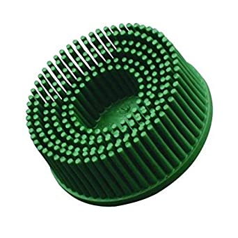

The Permatex gasket remover didn't do much against the gasket material still stuck to the block. The Fel-Pro instructions for cleaning the head before putting a gasket on is to use a die grinder and fine wire brush. Green Scotch-Brite pads aren't really doing much, 1000 grit wet/dry sandpaper was a little quicker to remove the stuck on graphite(?) gasket remnants. From reading online, the Roloc pads are a bit to aggressive for some people, is a wire brush a safe next step? Or a brass wire brush? You can see in the picture the small smooth section on the left side of cylinder 1/2 vs the stuck on gasket to the right of cylinder 2/3. The stuck on material isn't coming off with the plastic scraper I bought.

I use 3M Roloc bristle brushes for cleaning stuff like this. Scotchbrite roloc pads are a good option as well but they are a bit more aggressive especially on aluminum.
I probably wouldn't use sandpaper, you'll be at it forever.
The roloc brush I use, typically about $12 at NAPA
46645
I am trying to use tools that I can't easily mess up the flatness of the block. Internet seems to be 50/50 on whether the roloc discs are great or way to aggressive.
Those bristle brushes are made out of plastic, you really have to try to make them damage cast iron. They will not hurt your block. Like I said aluminum is a different story, but even then they're pretty safe.
