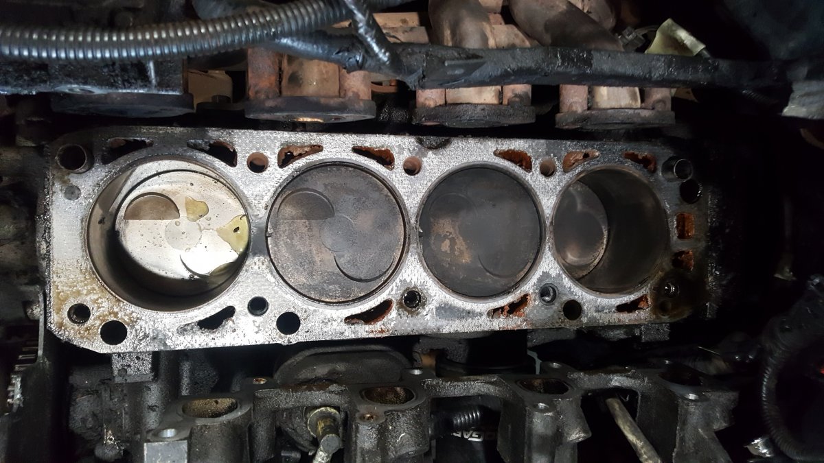

After about 10 hours of work over two days I got the block off. There wasn't much fluid in the radiator and seeing what cylinder 1 looks like...was cylinder 1 burning coolant? Is that why it is so shiny as compared to the other 3 cylinders?
45612
45613
Yup, #1 was being "steam cleaned" by coolant leaking in

Finally able to make it to the hardware store to get a 7/8 socket to rotate the engine. It rotates very easily with a just a tiny bit of noise from the cylinders, no idea if that means anything. I checked for scratches by eye and with fingertip/nail on all the cylinders and didn't find anything.
The only thing I noticed was that cylinder 1 looked worse than the rest right at the top where the blown head gasket was, which you can see in picture 2. It is rough to the touch like a fine metal file. It almost looks like the cylinder is closer to that side of the bore than the radiator side.

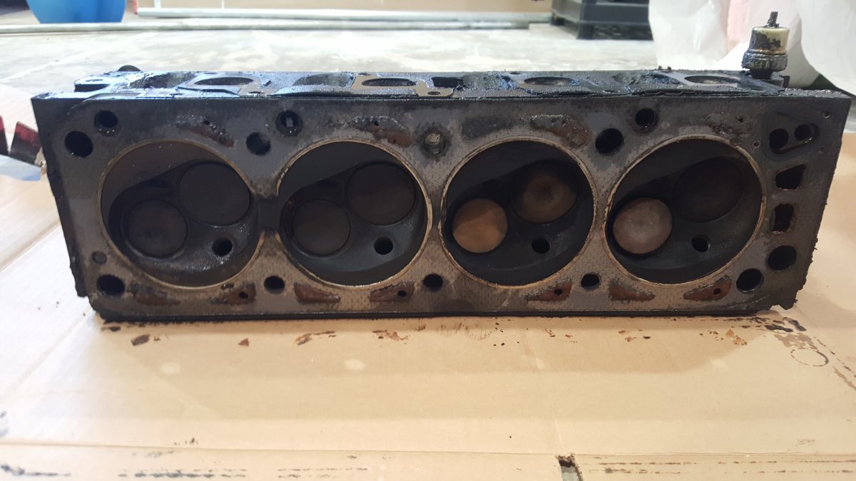

The blackish color between #1 and #2 is sometimes a sign that the head gasket was allowing the two cylinders to trade gases back and forth. That would make it run very poorly. If you look at the exhaust valves on 3&4, they are 'brownish', while those in #1&#2 are black. Black is not getting hot, while tan/brown and dry looking indicates they are getting hot, which is to be expected.

Edit: Changed the title of this thread to describe my problem. Before I put all of this back together, I am trying to figure out if the marks on the #1 cylinder wall are an issue.
If you can't feel them with finger nail they are not an issue

I would be concerned with the #1 cyl. Judging from those pictures that block needs machined! Anything short of that is a half assed repair.. Any machinist is gonna tell u, that u need to refinish that cylinder.
