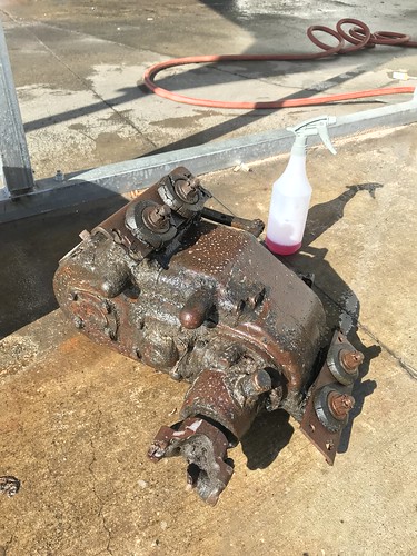

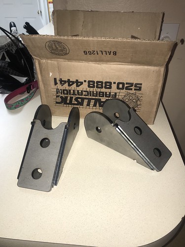

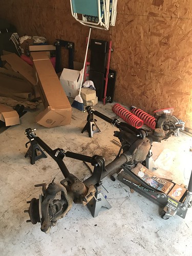

onto the sas swap plans, I have a high pinion xj dana 30 with a 3.55, I plan on putting in 4.10 to match my rear end for now. Found 4x4horses early Bronco 3.5 lift coil springs on facebook, bought a rough country long arm kit from work. I have divorced transfer case dana 24 from a early f250. Got some f150/bronco spring retainers from the junkyard. Ballistic fabrication long arm frame mounts. To cut costs I'm rebuilding the xj brakes by leaving them in and alot of the other rusty parts in vinegar, painting them, and rebuilding them with a piston kit. Trying to do this low budget as possible, using my work discount with rough country so I will be using them as much as I can cause it will be the lowest price I can get these items, also plenty of trips to the junk yard and craigslist/facebook market place finds. Still debating running 33's or 35's but I'll have to see when everything is together. I am no fabricator but the diesel tech at work as done a couple sas swaps on rangers and plently of bigger trucks I've seen in person. Still trying to do as much bolt on parts as I can so I will be doing skyjacker lift leaf springs, most likely will keep my stock buckets and modify them, adding truss to the dana 30 knowing that they are weak when beat on, using bolt on 1 ton steering, rebuilding the axle with all spicer parts, debating a fuel cell to have extra space to work with. I have many plans and taking this little by little. Any info from experienced guys would be much appreciated! I will try to update this thread when I make progress.

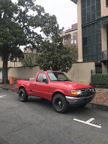

ReliableRed's 97, 2wd, 2.3, 5 speed, SAS BuildRanger before sas swap by Cole Hannah, on Flickr
ReliableRed's 97, 2wd, 2.3, 5 speed, SAS BuildDana 30, long arms, springs by Cole Hannah, on Flickr
ReliableRed's 97, 2wd, 2.3, 5 speed, SAS BuildDana 24 by Cole Hannah, on Flickr
ReliableRed's 97, 2wd, 2.3, 5 speed, SAS BuildLong arm mounts by Cole Hannah, on Flickr

I did a little checking on the t-case because it looks intriguing, pretty neat. I have a 205 in mine and it fit between the frame rails perfect, I suspect yours will fit similar since looks like it is similar in shape and size.

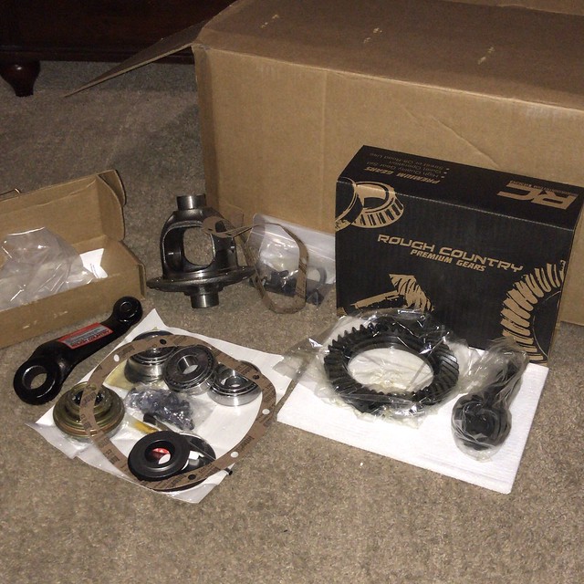

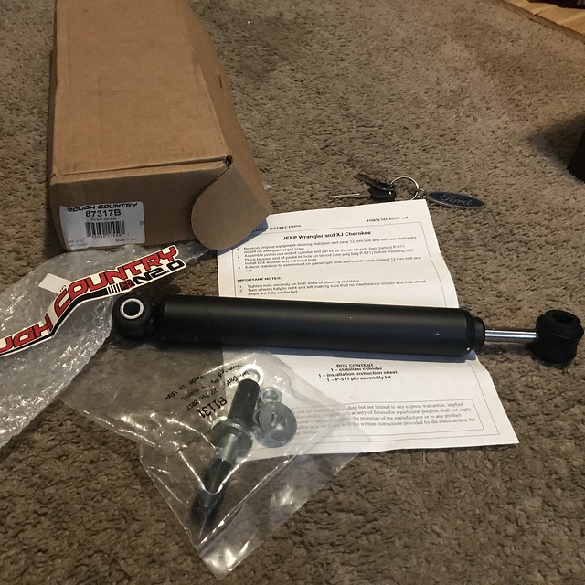

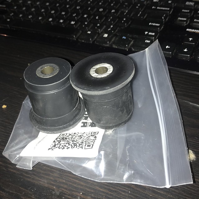

Got some parts in the mail, Ranger drop pitman arm, 4.10 gear for the front axle, open carrier for for the bigger gear, master gear install kit, D30 control arm bushings, jeep steering damper. The jeep damper I got off the Rough country scratch and dent ebay page for 20 bucks! eBay description said it had a couple nicks but don't see any reason to return. I wondering what style axle seals I should do? Seems to be 2 different styles? I believe all I need is axle seals and a locker or open diff gears to finish the axle rebuild, besides u joints, ball joints and hubs. Also following up on the fuel cell I read a nice thread of a guy doing a 89 bronco 2 tank and a 2.9 fuel pump that might be the direction I will go with fuel tank relocation. If anyone has some input on that I'm all ears!
ReliableRed's 97, 2wd, 2.3, 5 speed, SAS BuildFront gear and pitman arm by Cole Hannah, on Flickr
ReliableRed's 97, 2wd, 2.3, 5 speed, SAS BuildSteering Stablizer by Cole Hannah, on Flickr
ReliableRed's 97, 2wd, 2.3, 5 speed, SAS BuildD30 Bushings by Cole Hannah, on Flickr
