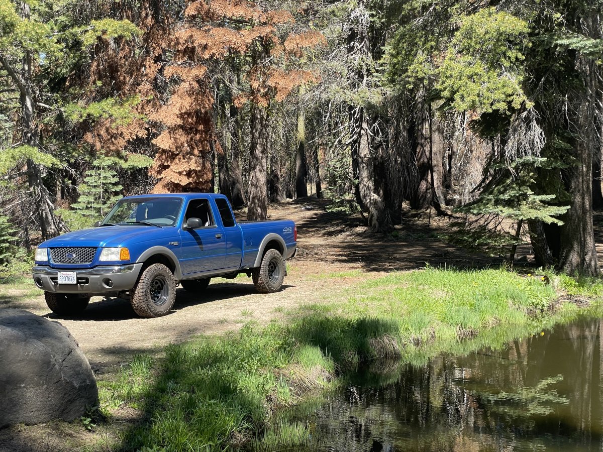

I’m not a huge automatic guy but I know the basics. To me it sounds like classic valve body issues. The overdrive solenoid not working correctly or something along that line. I’ve gone through all the sensors on the truck side of it that could affect the pcm values. What do you guys think? Valve body? Something deeper? Here’s a pretty picture to motivate y’all.
