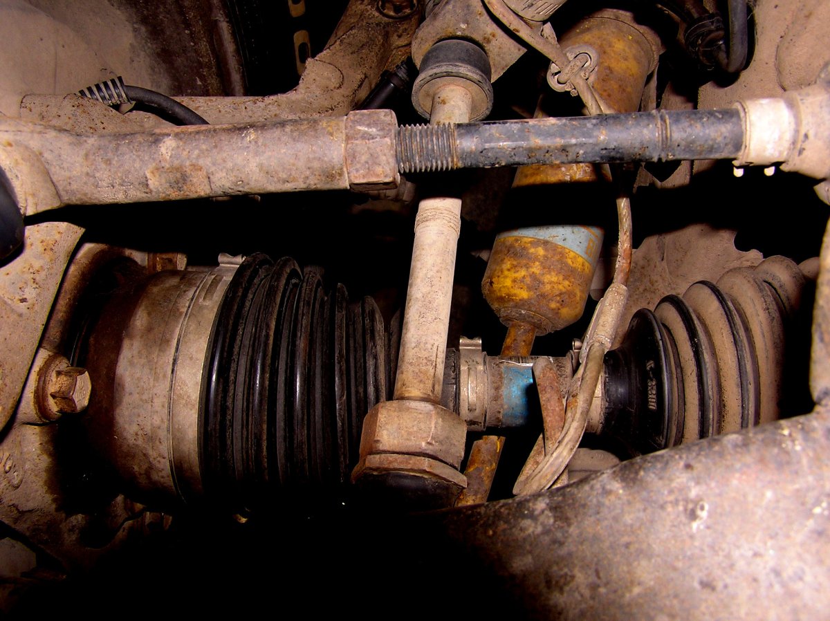

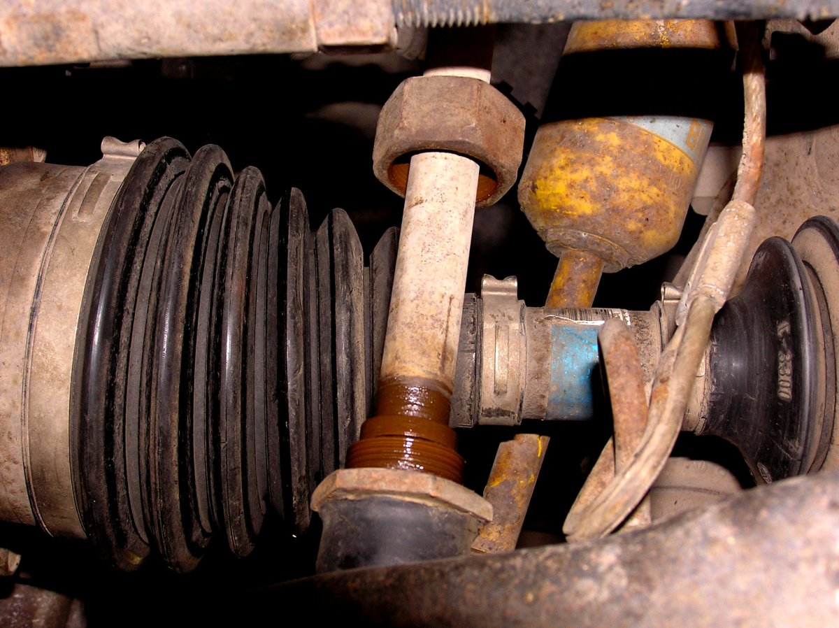

I finally took some photos of the disconnect I designed. This first one shows it connected. The bottom part has a rod the extends up inside the top tube. With the nut screwed onto the bottom, everything is tied together and the anti-sway bar works as it should. You can see the cable I installed to make sure the anti-sway bar would not lift enough to allow the rod to slip out of the tube. Barely visible are the threads just under the tie rod on the top tube that is used to store the nut when disconnected.
The second photo shows it disconnected. If the suspension was flexed enough, you would be able to see the bottom rod extending out of the top tube. You will just have to take my word for it. I didn't feel like messing with it to get the right flex. You can see how the nut is stored on those threads I discussed earlier. You can kind of see the flange on the top tube above the lower threads on the bottom piece. That is what the nut clamps on to tie everything in place when connected.
I was asked what I would change to improve it. The main thing I would change is to make the threads a little longer so they would engage easier when connecting on uneven ground. I would also make the hex a little wider on the bottom. I actually had those features in the original design but my German machinist made some changes to make it easier to fabricate.
