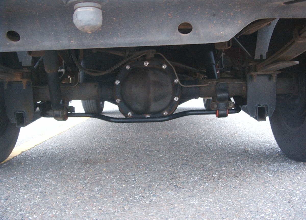

Did your Ranger have a rear bar already?
yes. i guess the 05 edge came with both bars
Mine is a 2003 Edge, like all the rest, made with off road in mind.
I haven't really liked the way it handled on the highway even with the sway bars. I lowered it: replaced the 2" lift blocks with 1" in back, cranked down the front torsion by 5/8". Still not happy, I added the spring clamps in back, and then swapped the stock front sway bar with something better. Now of course, it's a lot better. The difference is noticeable. It's safer, I'm sure, at highway speeds. That's what got me searching for a better rear bar.
