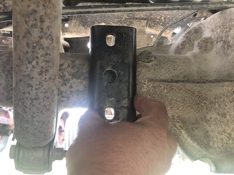

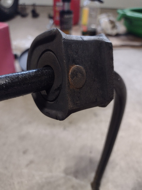

Got to grab some more pics from the camera, but finally uploading from my phone. I only have some closeups of the underside of the bushings that attach to the axle, (please ignore where I was about to hacksaw through).
And thanks Scott! I knew I wasn't crazy. It's just so odd these aren't split bushings. I'd love to just slide them off, but no way these babies will make it over the eye where the bar attaches to the endlinks. Which has me thinking: how did they get them on in the first place? The second pic kind of shows an inner part that would roughly measure out to the same diameter as the eyelet. So is that metal nail just holding those two pieces together? This is like a ship in a bottle scenario :unsure:
Gaz, I can grab the other photos if interested in the whole setup. I have the bed off so really easy angles/clear views.
@RangerJoey , I can see now what you.were describing. Thank you fir the pics .)
What metal nail? If it is the round thing on the flat part you are refering to that is just rubber that got squished into a hole in the axle bracket.
Mine slid pretty freely on the sway bar, they were old/hard enough they couldn't quite do the corner to fully get off but the would move around.
You sir, are totally correct! Looking at the rust around those "nails" led me to think they were some sort of fastener that connected an inner bushing to the main bushing, (the second photo kind of shows that smaller circle inside the sway bar bushing). But you're right on point. Took a magnet to it and nothing. That poked it and was able to pierce it like... like rubber :)

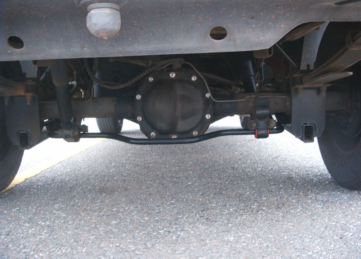

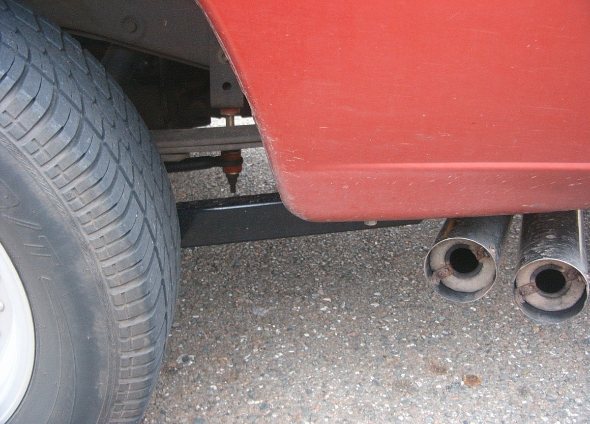

My 98 didn't have a rear when I bought in in early 2000. I was going to be towing a fairly heavy trailer from CA to OK in 2002, and wanted the truck as stable as possible. So I installed a Hellwig rear bar at that time. I definitely noticed the difference. In 2015, I noticed while the front tires were off, there were four missing bushings on the front end links .At that time, I replaced all the end links and frame bushings, even on the Hellwig, with Energy Suspension parts from Auto Zone. Nice thing is they now all have zerk fittings. Did the same on the front and rear bars on my 04 LIGHTNING. The fronts were bad on it as well.

Sorry for the delayed response. I didn't get a notification that you posted since you didn't use the quote function. Yes, the Hellwig came with bushings when I bought it in 2002. And they also needed to be replaced in 2015 when I did all the others. That's why the pics I posted show all red bushings. Those are Energy Suspension bushings purchased at Vato Zone.
