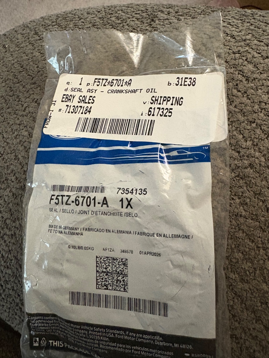

Curious what y'all would use if available. I have a felpro kit for my 2.9l short block build. Has a National (made in mexistan) RMS. Only reason I'm suspicious of it is I had pulled a junkyard engine for the interim (wiped cam but oh well) it had a new clutch and a recent looking national seal that had failed and created a pretty major leak. Scum was a lot more recent than the rest of the engine.
Here's what I have:
Two different NOS Ford Made in Germany (unknown age)
Or the made in Mexico National from the Felpro kit
Any other brands I should check out? Just want to use the best thing I can get since its rather buried in there. Thanks!
Edit: to clarify I have two of the same Ford seal.
Ah! There IS one in the short block as well, even though it came with one in the kit. Its marked chk. Taiwanese. It's gonna come out anyhow as I need to pull that bearing cap to verify clear oil galleries in the crank and block.

I use the 4.0 Ford seal . However you will need the seal driver. It has a wear ring . Ford was suppose to make another run on them .

Man if you have Ford seals, use 'em.
Fel-pro is very hit or miss. It's not like they have bad batches, some of their parts just suck ass and it doesn't matter if you got it 10 years ago or today. Some of the water pump, timing cover and thermostat housing gaskets that I've seen might as well be made out of cereal box cardboard. Some of their others are very good though - their Permadry valve cover gaskets are great.
Some things I will try to use OEM Ford parts if at all possible, timing cover gaskets for 4.0's are one of those things. The waxy green material that they are made out of is superior to everything else out there, at least in my mind.
I've used Engine Tech before, no real complains to speak of, seemed like good quality for the most part. IIRC there are two grades though, the cheap gasket set and the good one...get the good one.
Last, National parts, I have had pretty good luck with them to be honest. In fact I try to seek them out if I simply must buy parts locally. My guess is if one failed on a rear main, there are other issues there or it was poorly installed. The seal itself could certainly have been bad from the get go but I'd look at a scored crank or something like that first.
