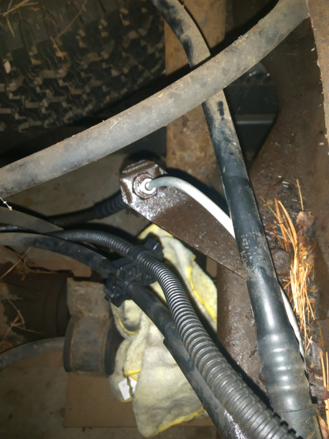

Anyway, this weekend, I jumped back into the swing of things and removed the bed, (still have a broken bolt in the frame). Immediately after removing it, I confirmed you guys were right about the steel brake line that runs over the driver’s side rear axle. It leaks, but only when pressure is applied. That is, it’s not sealed and fluid comes out the top of where the flange should meet up to the section that takes it over the rear axle:

I tried tightening the coupler as much as possible, but the problem remains.
I really like the idea of your previous suggestions in terms of just buying a new piece and bending it, but from what I'm seeing, I suspect this line runs up to the master. So short of buying a kit and trying my hand at flanging, (never afraid to learn a new skill), should I just try and pull this line and replace the whole thing or simply try to remove a section and link a new line in?

That rusty line along the frame is definitely the original brake line that ran to the splitter hose, where you are showing the leak above.
It's an annoyance to fish the original broken line out because its clipped on in a few places as I recall so people always leave it. Every ranger I've had has had that main brake line replaced and I have always found the old, original rusty line still there next to the gas tank, plumbed to nothing

I would probably unthread the leaky fitting and inspect the threads to see if they are all cross threaded and messed up. If so you may have to replace the splitter hose- I'm sure all that will be obvious when you undo the fittings to get a look. You will also be able to see the flare on the line and see if it was poorly done. Maybe get piece of 3/16" line with 3/8 SAE fitting for 3/16" brake line at an auto parts store and take a look at the flares, will give you reference of what a proper double flare looks like
If you can't tighten the fitting to stop the leak, I wonder if someone used a metric not SAE fitting and it only feels tight because it's cross threading. Even if it has the wrong fitting etc., you don't have to replace that new line all the way up to the master cylinder to fix your issue. If you are going to work on brake lines definitely buy a small tubing cutter suitable for a 3/16" diameter line. Very important. You can then cut the fresh line coming down from the master off wherever its easy to work on, beyond the rear of the gas tank, and re flare with new fittings and even threaded couplers (Do NOT use compression fittings, many states have laws against it and it's not the best idea anyway) to bypass a bad part of the line

Just wanted to finally follow up and say THANK YOU to all of you! Brake fluid seems to stay in the lines. Mind. Blown! :headbang:
In short, the best way to do this would've likely been replacing the hole line back to the main unit. But since this was a brand new line and short of rethreading everything, etc, I picked up a little in-line flaring tool, (not sure if I can reference it, but it's on Amazon for like $15). On my very second attempt, I was able to get the flare in there correctly. And there's zero percent chance I'd have any shot at that without a) taking the bed off and b) everyone's help.
