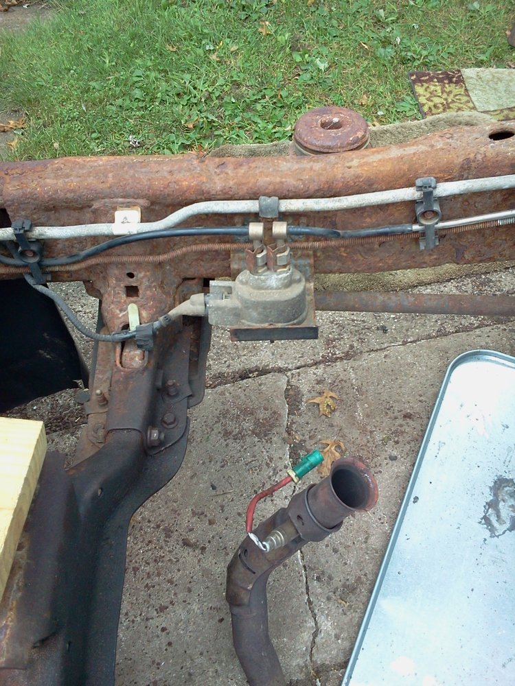

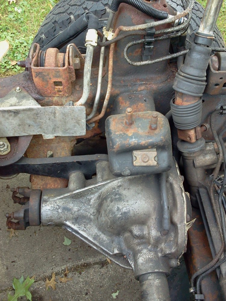

Hi Everyone,
I did a frame off restoration last year and I am putting everything back together. I'm struggling to figure out exactly how the intermediate/rear brake line, fuel line, and evap line route by the front differential mount under the frame heat shield. I've searched for a while and cant find any pictures or diagrams. Does anyone have any pictures or diagrams?
The truck is a 1999 4x4 AWABS
Thanks
this is a '99
don't have any pics directly behind the heat shield.
That helps a lot! Wish I could see under the heatshield as the new brake line I have seems to want to route through the front diff mount, but with the pics I can probably figure it out with confidence. Thank you
