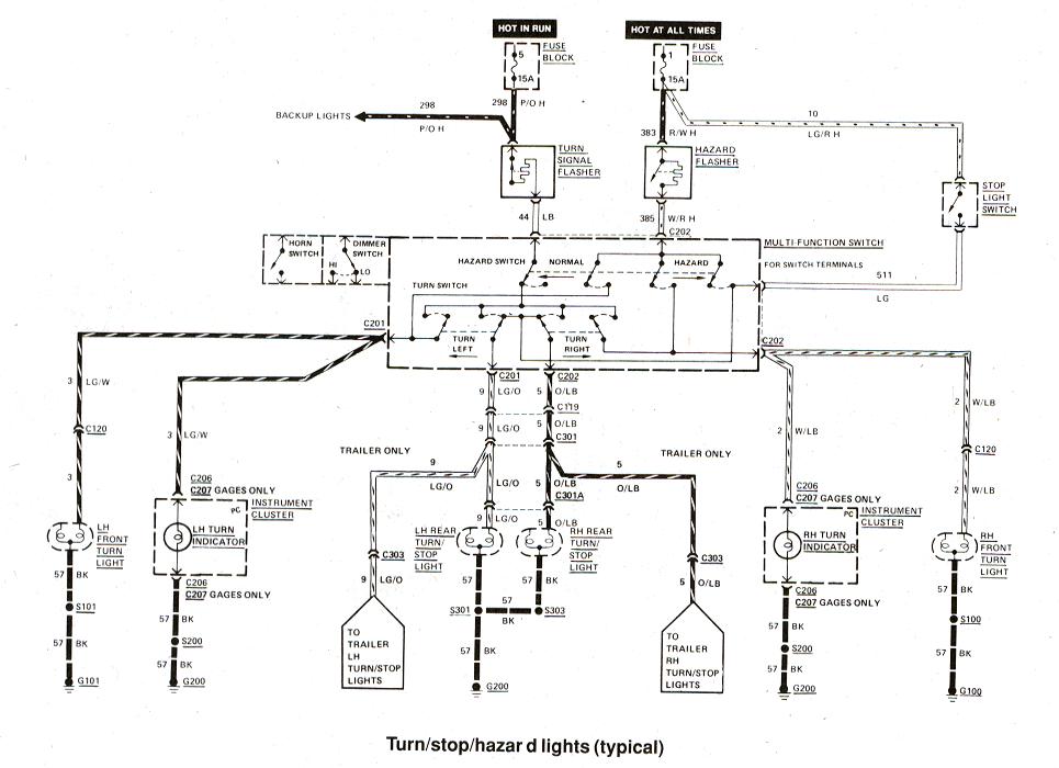

Here's a diagram.

After studying that diagram only one obvious thing stands out as possible. Part of the Multi-Function Switch is out. Odds of that though at the same time as the swap is probably something like 1,000,000-1, unless you had a turn signal on and something arced.
