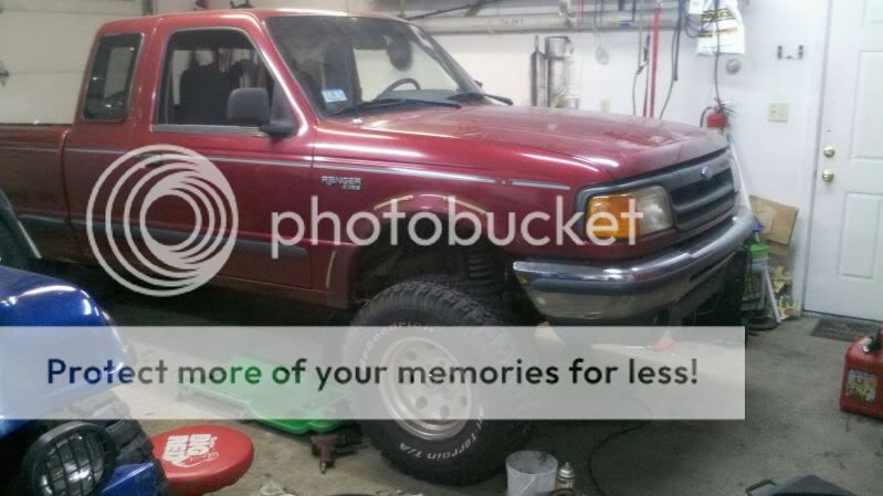

they are from a tj. they are 15x8 american racing wheels with 3 3/8 bs. here is a picture rolled underneath since i already have the stock wheel off for the axle shaft swap
Ravo's Ranger
the truck is maybe lifted 6" off the ground so its about 2" higher than where i want it to be when completed. but i think it looks pretty sweet

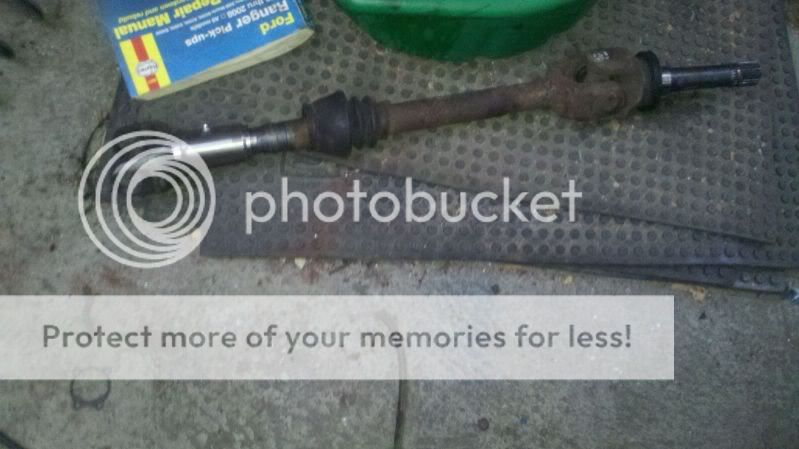

and speaking of axle shafts.

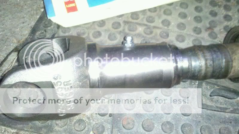

the slip yoke took me 3 weeks to find
Ravo's Ranger
i installed a grease fitting because i didn't want to have to do this again.

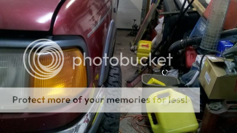

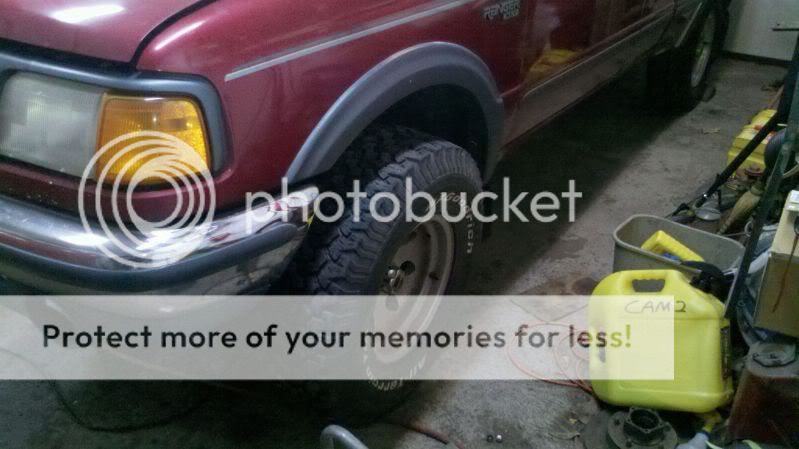

here it is from the front. i was surprised and pleased at how little it sticks out
Ravo's Ranger
i was worried 3 3/8 backspacinng would push them out too far but i think its perfect. when i get my 33x10.5's once these wear out they should just barely stick out.
also it rubs a little on the fog valence. once i get my leveling coils i should be all set. and if not.... i got a hacksaw

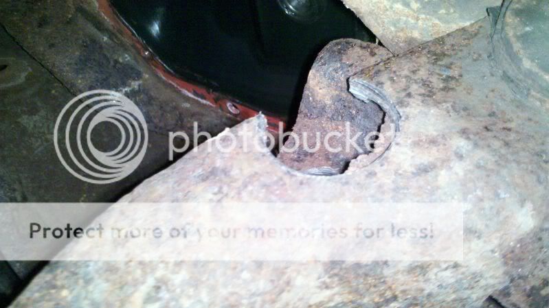

i'm going to roll this thing off a cliff. what in the hell was ford thinking putting a vertical bolt on the diff that you can't get to.
and hints before i do some damage to my truck
got a pic? i have no idea what part your talking about with a bolt like that
i will take one later. on the left side of the front diff there is a vertical bolt inside one of the arms that's almost impossible to get to

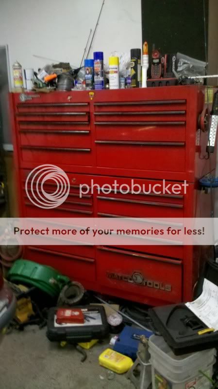

first off. this is my tool supply for anything i might ever have to do

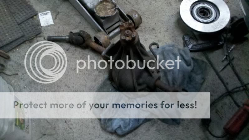

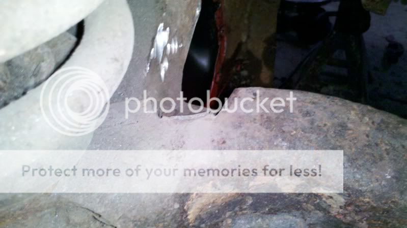

and now fun stuff. while i was out my dad notched the rad arm to get that bolt out
Ravo's Ranger
had to drill out a hole underneath to get the impact driver on it

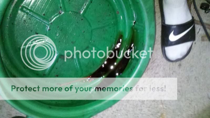

this is how much oil came out. im not sure but i think i was supposed to have more. stupid previous owner:annoyed:

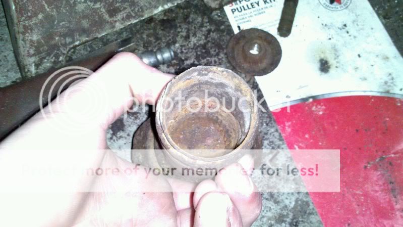

and this was the cause of all the trouble... do you see any splines in there?

I think ford woulda wanted you to pull the radius arm to pull the diff. When I did my radius arm bushings all data wanted a bunch of extra steps too. But all I woulda done was undo the radius arm bushings bolt pulled the traction beam on that side forwards maybe took that half of he radius arm crossmember out and slidtje radius arm over that way you wouldn't have had to cut up the radius arm. Sounds like more work then it really is, I think I'd box in around where you drilled for sure. Otherwise yay 4wd!
yeah. i'm more than likely gonna box it up. even though i doubt it will who would want it to fall apart while you're driving
Yup like u said chances are it'll be fine but I'd rather be safe then sorry. Maybe this is a good oprotunity to make some extended arms
