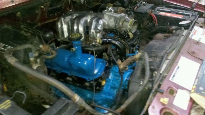

also my heads just got their first coat of paint. i should start reassembly tomorrow afternoon! don't worry. there will be pictures. i can't wait to see the color scheme of the engine once its all together

started assembling things. i feel better already. also my camber problem went away now that i got my heads back in. they were leaning bad with no weight in there. anyway.
heads all torqued down

lower intake on. can't wait to get the covers and intake and exhaust on to really get the full extend of the color contrast

it's been a few days, but my dad dopped my left valve cover and chipped the paint. i had to repaint them like 4 times because the paint kept cracking. i finally got it. everything is torqued down. now i just need to finish hooking things up.
looks like a brand new engine
