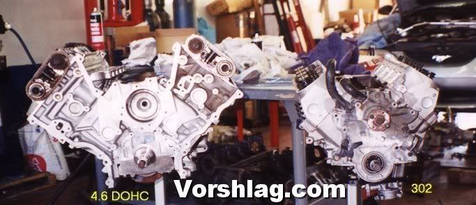

Good luck fitting ANY modular motor into that engine bay... that lightning motor is TALL and WIDE, the 6.2 is the same. You could get away with a cobra 4.6 motor in there. 300hp in this vehicle is all you should need. Power to weight ratio man. Power to weight. the 4.6 is tall and wide, but not as tall as the 5.4/6.2.

the 4.6 swap has been done a few times, theres a few builds on here. The 5.4 takes a little more doing though since its taller.

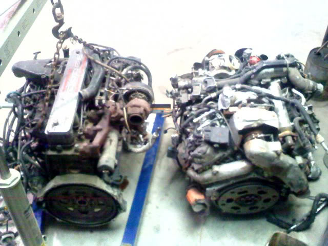

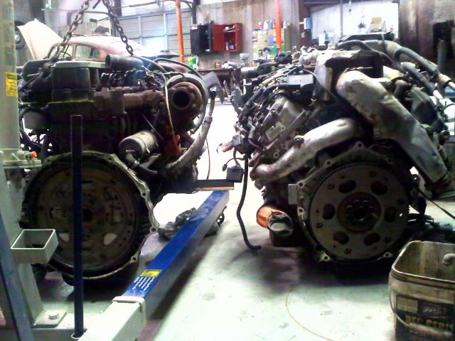

well this thing sits happily in my engine bay.
:dunno:
attachment.php
a 302 is a tiny little fawker.
this is a d max/cummins comparo. my engine is basically the same size as a d max. well if you remove the factory turbo plumbing like i would.
granted i would prefer the old school small block size for obvious reasons....but if a guy was all hard core for one of those ford monstrosities and had a money tree to build it....its a non issue.
