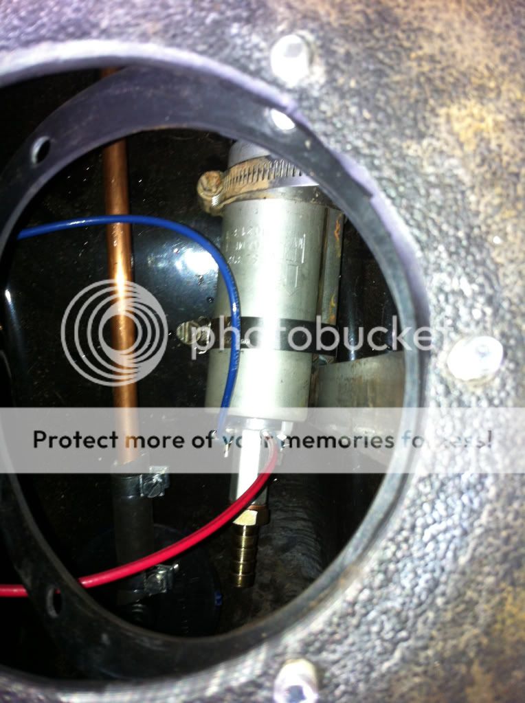

Been busy not much to post. Pulled tranny out just got a call it's ready. Started on the in tank fuel pump. 3 walbro pickups a walbro gsl392 pump submersible fuel line from napa $25 a foot. A got some submersible fuel line from liquid iron industries but it was supposed to be 3/8 but seems a bit small so I didn't use it.
I'll also leave the frame mounted pump and have the ability to swap it over to that if needed to get off the trail.

keep us posted how it works out for you. This may be an stupid question, but how do wire a submerged pump?
I use just regular thhn wire which is fuel resistant use two plastic washers and screws for pass through for the power. Ill get pics tonight.

Got my tank put all back together. Made a bracket that holds the pump and goes to ring for filler neck. Ran wires through outside of tank with plastic washers similar to how the fittings are on the tank. I've ran my jeep in a similar way for 5 years. Getting everything in the tank and hooked up with one hand was tricky. I now know what it's like to build a ship in a bottle!

Finally got the truck going shift flare is gone! Fuel pump can't even hear it run! Still needs little stuff bump stops etc then I'm going for a dune run. Front springs on the street are an improvement a little stiffer doesn't bottom out over potholes now. Got a tranny dip stick from lokar.
