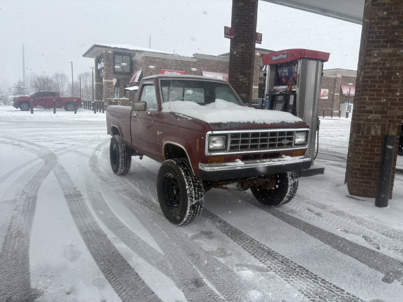

Here she is after I fixed her 🫶🫶

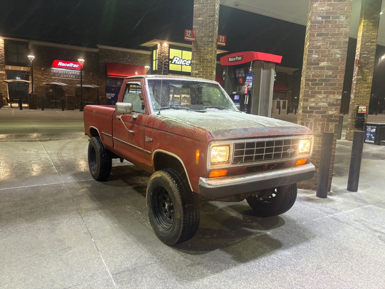

And one more for the road

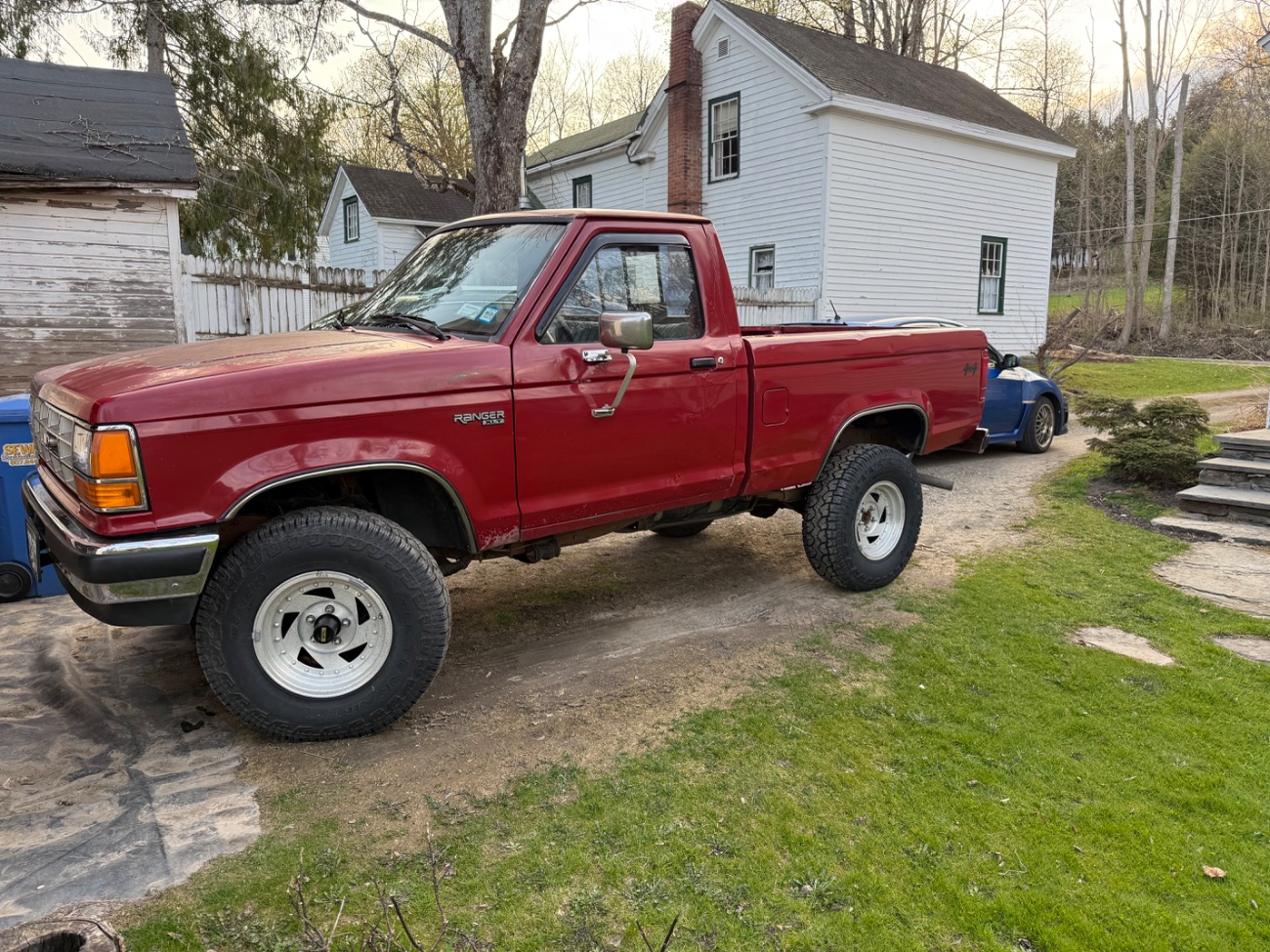

Wow. Uncanny resemblance to my 89.
