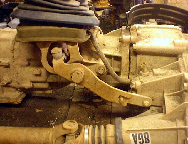

Yeah its dirty as hell. and yeah its missing a few bolts, mostly on the shifter linkage.
Comparing to this pic i found, seems like the linkage is just out of alignment
The t case to front shaft output is supposed to be that way or is it missing something?

Get some better pics of the front and back of the t-case. An ID number off of it would also be helpful. Something doesn't look quite right about it.
If it's def a 1350 then it's probably supposed to be like that. I think they all had the slip-yoke style shafts. I have one that should work if you have too much trouble finding one locally.
Thats a BW1350, looks exactly like what my truck has. I personally dont like the slip yoke joint but until I need to get a new transfercase, Im not going to complain.
I just saw that the output of the transfercase for the rear driveshaft is different then mine. Mine has a yoke on it and your has a flange. That makes me wonder were things changed over the years or has the transfercase been messed with before.
The front is supposed to look like that. If you want to have anything over 3" of lift, that front driveshaft will probably vibrate on you. But dangerranger83 is using the same d30, t-case, and front shaft and says he has no problems with it. I have a 1350 but with the fixed front yoke from an 87 or 88 STX. I will have to find a picture of it for you.

I believe in 86 is when they went to the flange.

If they went flange on the 86, this 91 would have it right? :icon_confused:
They put the flange on the rear output.

I started cleaning the trans today.
and i found a weird issue.
i dont know if im missing a part or what, but i cant make this 2 parts fit.

That shifter linkage isn't right.

For the pics ive seen, its supposed to have a small bent.
please take those pics, since i need to get it right before we put the trans on the truck. :icon_thumby:
your also missing the rubber that goes onto the shift pin and the lever goes on both sides of that. i thought only the 54's had the bend in the linkage?
