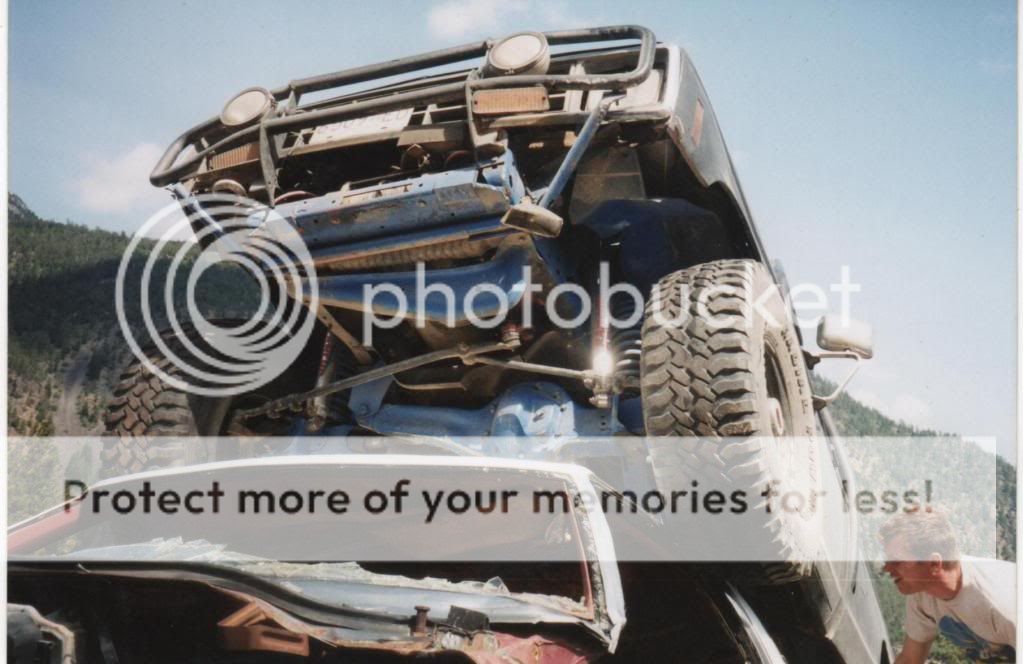

and there she is-2.9,dual transmissions,spicer 20 t-case,custom d50 front,full float 9" rear.
by this time i had come up with some 35s and formed up a bit of an exo cage,as well as some aluminum bed rail caps.
sweeeeeeeeeeeeeeeeeeeeeeeeeeeeeeeeeeetttt...... like i said gwaii, junkyard wars, lol :icon_cheers:

this one shows the front suspension well.note that the tie rod ends have been relocated to the top of the knuckle.this makes it unnesessary to use a drop pitman on smaller lifts.
not even junkyard-those diffs came from the dump:icon_hornsup:
junkyard would have wanted $500 for that stuff.
guess you just gotta know where to look, post some more pics!!!

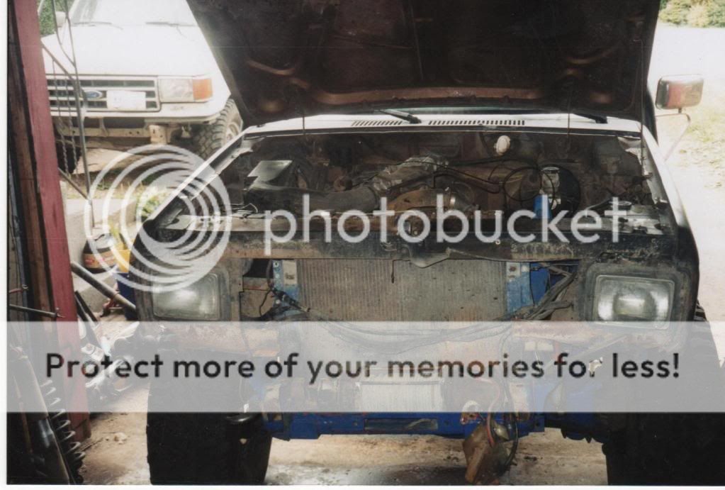

heres the last time it would see less than 8 cylinders.you can see on the rad support the results of many severe beatings.the headlights are not exactly looking like the day it came from the factory.
Awesome build! And awesome AMC eagle in the background of the one pic...I love those things..
i had a lot of fun with that eagle,built a lot of stuff for it,wheeled the hell out of it too.

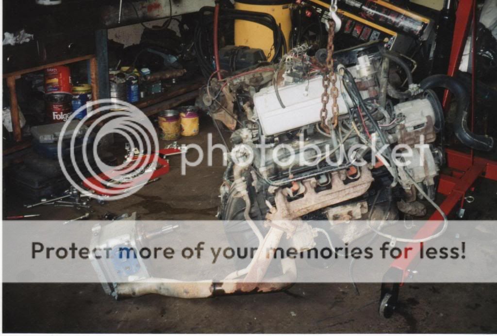

got this from an 87 f150 to toss into the little beasty.

the lump sitting behind the engine is an overdrive gear splitter.thought about using it,but with 3.50 gears and 35" tires,the last thing i needed was overdrive.
what i did need was underdrive,and as stated earlier,i had become addicted to multiple transmissions.i had a t18 2wd 4 speed,and an np435 4wd 4 speed,as well as an np 205 t-case,so i figured i would combine them for this truck.

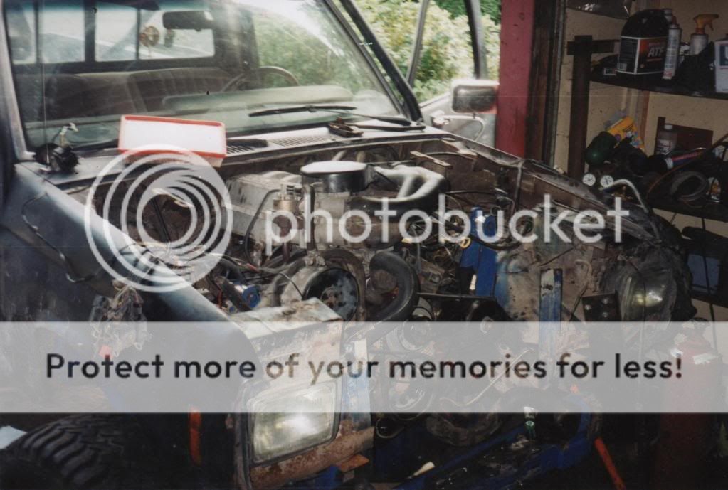

once i had the engine into the bay,i could see there would be a problem with the intake.theres lots of room at the back of the ranger engine bay,but it tapers down pretty good at the front.this is where the highest point on this intake setup is,so unless i got into serious crossmember surgery,it would not clear the hood.since the crossmember is what the front suspension is attatched to,this was not practical.besides,it was easy enough to get a 4bbl manifold for it and just go carb.
after this point i guess i didn't take any pics of the engine,as there are none in my collection.

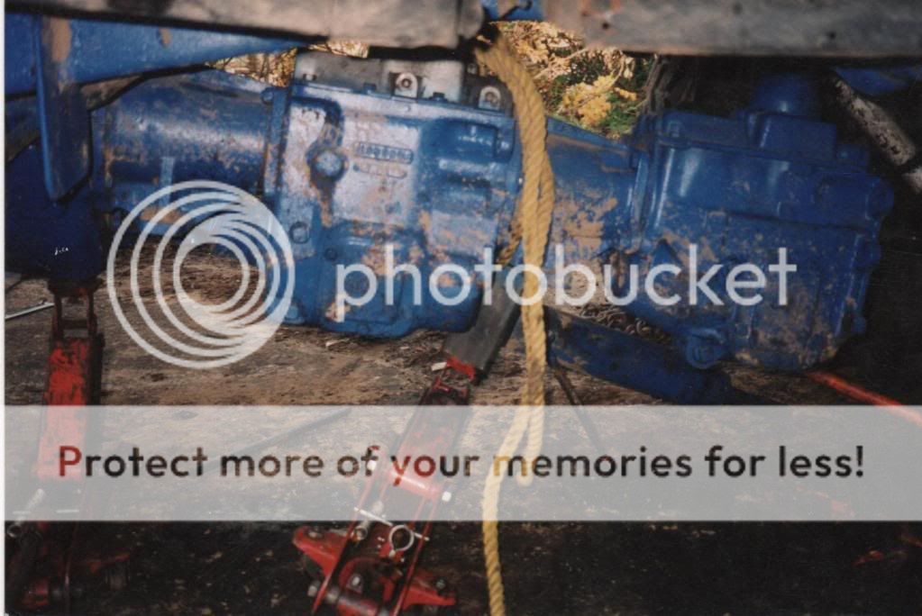

this is the trans set.at this time i was just using two regular shifters,one for each 4 speed,as well as the t-case shifter.as you can see,lifting this big lump of iron into place was a production,especially on a sloping driveway.
