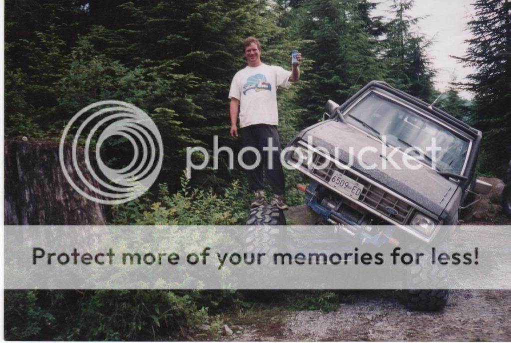

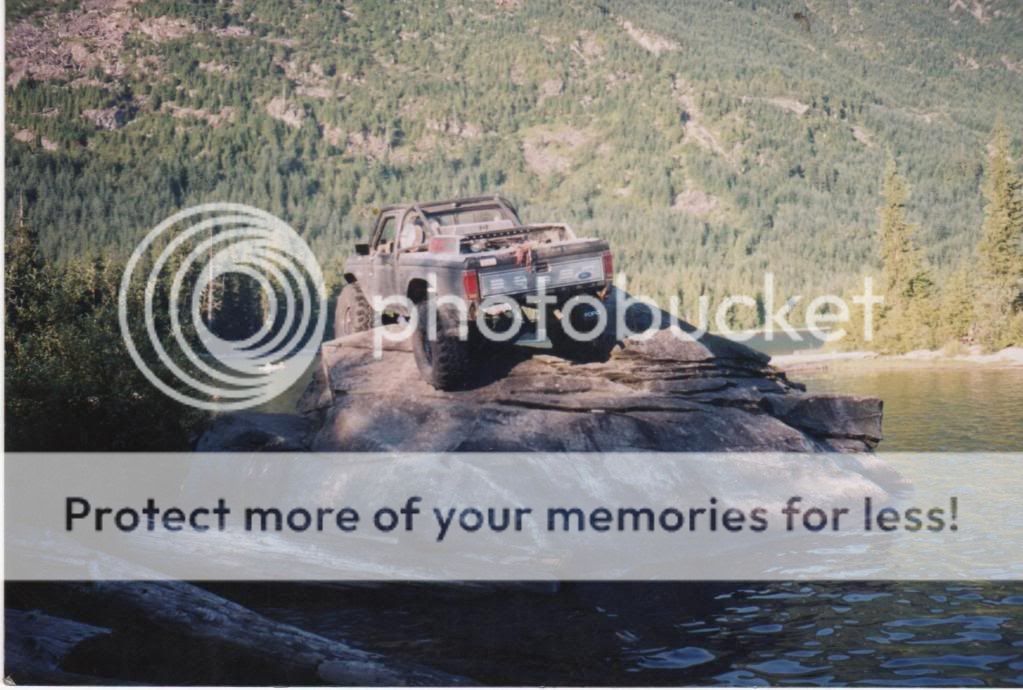

at this point i was taking the thing out to climb over anything i could find...like this rock.
it was working good,the engine was fantastic-smooth,had a good rumble running just the cats,pretty economical with the fuel,and passed emmisions testing with the best numbers i'd ever seen.
but there was still work to do.
wow you made that rock your bitch!

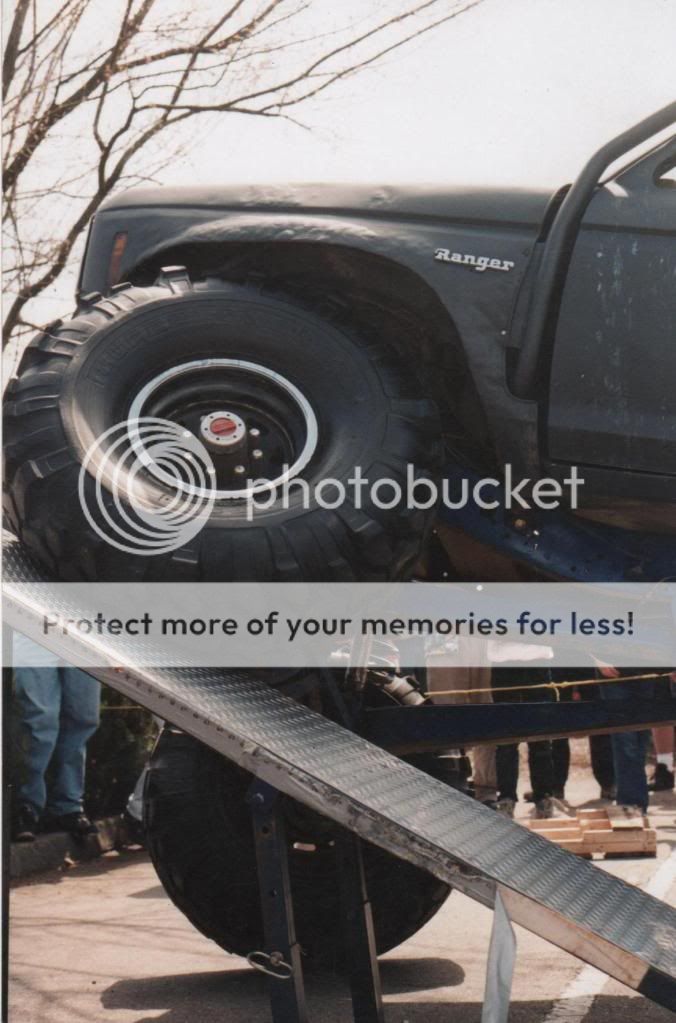

i was still doing the ramp thing,and this pointed out one issue.
the tied together front worked well to improve flex,but there was a problem keeping springs in,as the diff was able to drop out further that the springs would go.there were several trucks on the circiut with this problem,to the point that the officials made a rule that any truck having a spring get loose would be disqualified.it was a good rule.

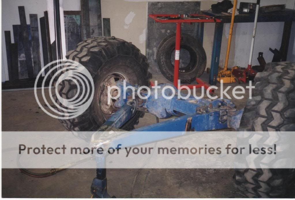

so i moved the springs inboard of the frame,with no engine there,i had plenty of room.
the issue i had now was that the front was too loose,as in not a high enough spring rate.another thing that was causing problems was the radius arms.since with one going up and the other going down it twisted the front end so much,i had the alignment going out all the time.this got rather annoying.

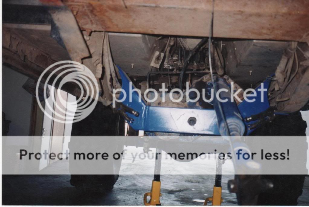

i pulled the radius arms together,welded a pivot on the junction,and solved my alignment issues.
of course,it needed something to pivot on.so i made this crossmember from 1/4" steel,massive and fully boxed as it would take all the fore and aft loads on the front end.
it also helped stiffen the frame.
