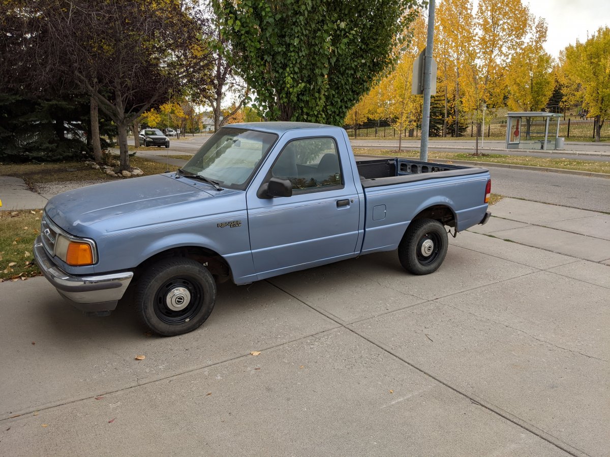

The 97 Ranger

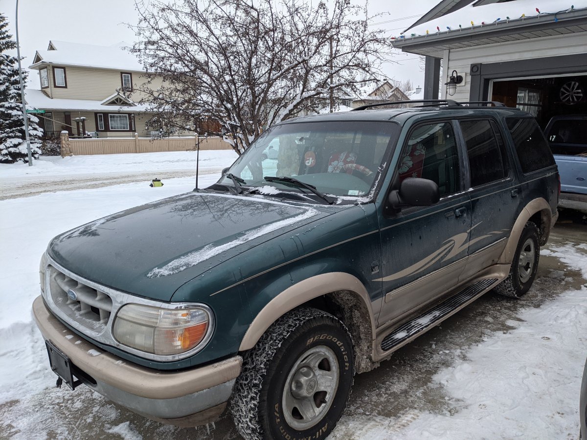

And the donor, 97 Explorer 5.0
Unfortunately it dropped to below - 40 this week, so haven't started anything yet lol
Those both look too clean to cut up.
HA, I just take good pictures lol. The Ranger is actually in pretty rough shape on the inside and under the hood, runs well, but if you looked at it up close you'd notice it needs a lot of work. The explorer mechanically is is good shape, and really not bad. My wife told my son the keep the Explorer and get rid of the Ranger. My brother in-law, father in-law and myself said have some fun :cool:

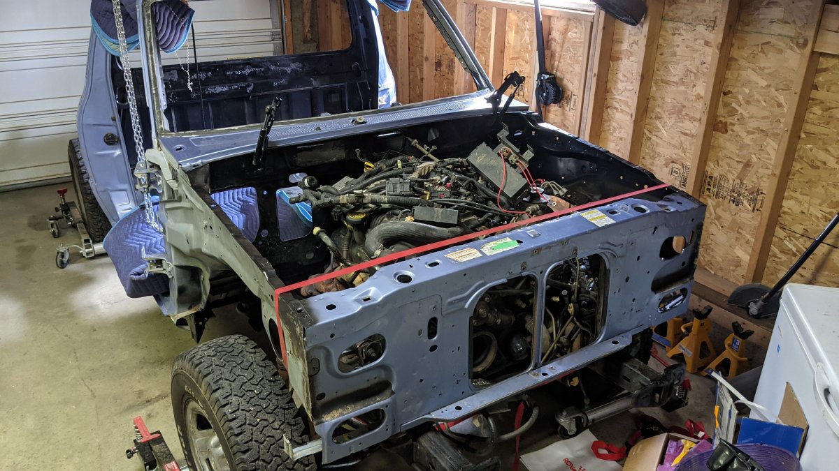

Just getting ready to finally pull the cab off the frame, what a mess. Rats nests all over the place, chewed wires, wires that were "mended" by the previous owner with bandaids. Even found an old nest beside the steering wheel airbag. Looks like the body mount bushings will need replacing, so great time to.do it, which leads me to ask if there are bushings that would lower the cab a bit, or is this a bigger job? Any thoughts on brand/type of material?

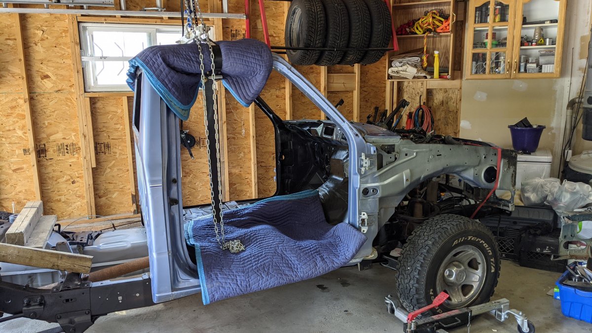

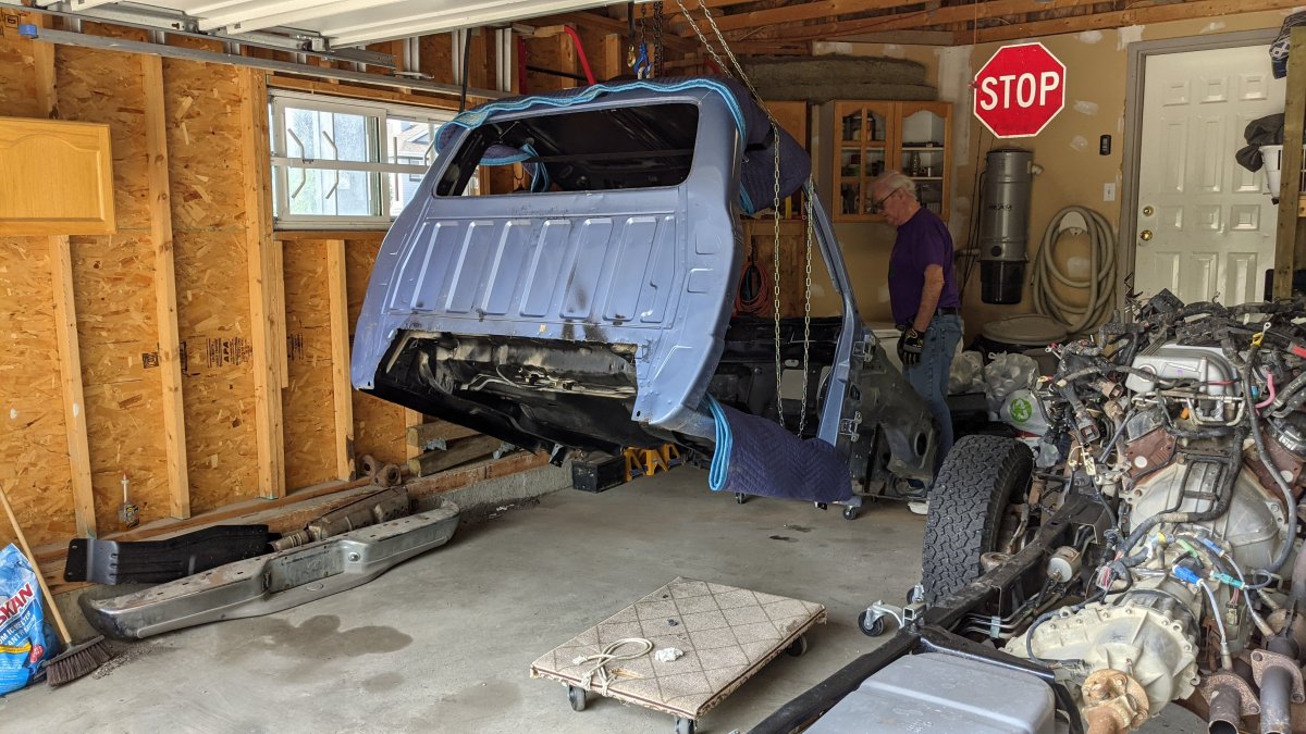

Got the cab removed on the weekend, 5 of us (including my 78 year old father in law) to lift it off. This may be common knowledge, but anyone thinking about doing this at some point, we found a steel cable attached to the cab where the seat belt buckles bolt in, and wrapped around the cross member. It took a few minutes to figure out why the cab wouldn't come off lol.

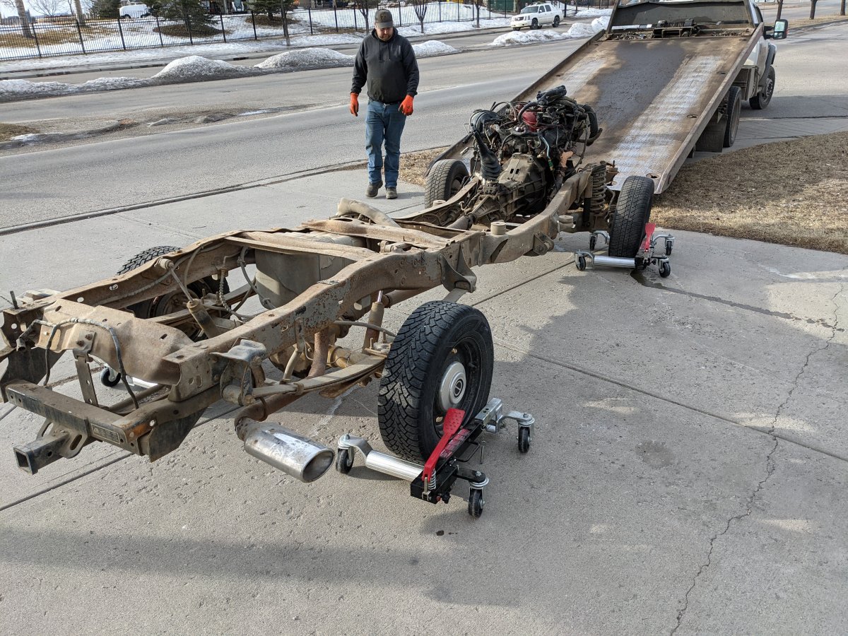

Also, if you're working in a small space like we are, I highly suggest getting wheel dollies to move the vehicle around. We also have the cab sitting on a heavy duty furniture dolly so it can easily be moved around as well. Weather is good so hoping to get explorer stripped in the next week or so.

Oh and forgot to mention how bad this truck actually was. The fuel filler neck was a piece of rubber hose, duct taped to the tank. The bellhousing was only attached with 3 bolts. The wiring was so screwed up that there was constant power to the truck without the key being in it. So as good as it looked in the picture, it was an accident waiting to happen. Guess you get what you pay for lol

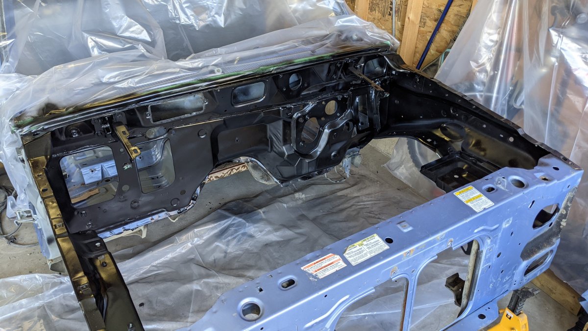

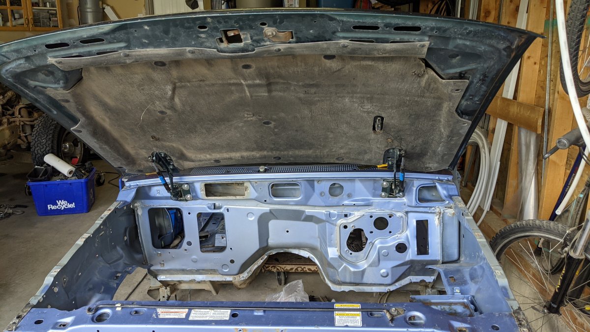

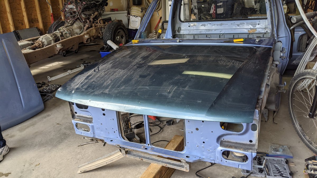

We're finally getting back to working on this. Decided to go with the Explorer hood and hinges, unfortunately not as simple as we would have liked. I thought the Ranger hinges used two bolts and 2 spot welds, ours were 4 spot welds. After a lot of measuring, we got the 8 holes drilled and mounted the hood, and were able to use the donor set as opposed to using 2 driver side hinges. Hoping to trial fit the cab on the frame now this weeked.

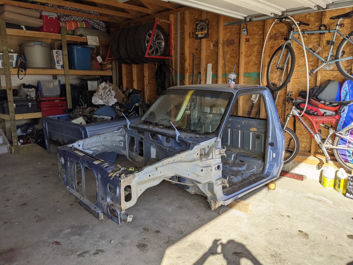

After a couple months of doing nothing, we're finally getting back to it. Got the cab on the frame, core support is being drilled out this week so we can swap in the Explorer, and hopefully have rear cab mounts made up in the next couple weeks. In case anyone is wondering, the completely stripped down cab weighed about 320lbs, and the garage trusses held it just fine :)
