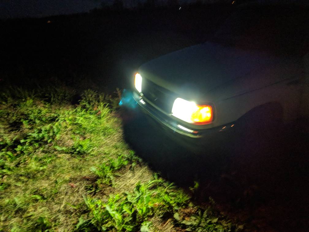

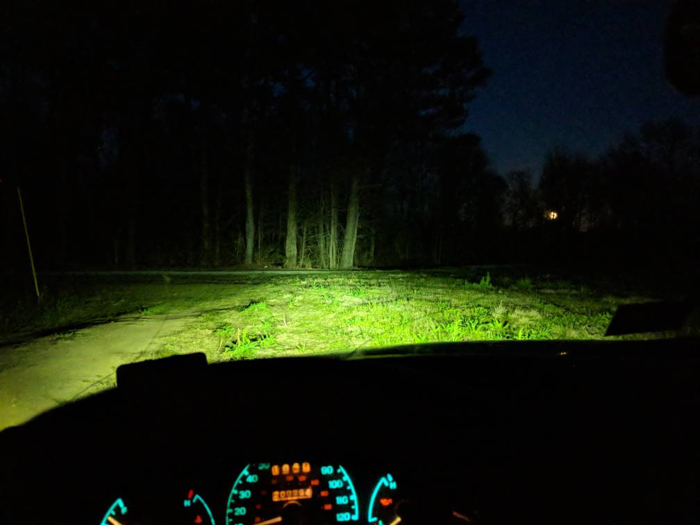

I have led bulbs in my ranger and they work really good at night. Only bad thing is my "high beams" dip down, but my night driving is limited now that I work closer to home and the sun sets around the time I'm pulling into my driveway
Ranger/B-4000  LED Headlight Coversion - Experiences & Suggestions
Sent from my Pixel 2 XL using Tapatalk
The filament wiring is backward
Wiring seems correct but it could be placement.. I'm not worried, my lenses are so yellow it looks like my low beams, sadly I've had to drive home after sunset this week, normally doesn't matter because I'm pulling in as the sun dips behind the trees

I came across the same situation when I installed a set of three sided LED's into my 98 headlamps, the wiring for the filaments was reversed, one has to pull the pins from the LED harness receptacle & reverse the low & high.
The bulbs work well, because only two of the three filaments are *on* when in low position the beam is directed down by the headlamps reflector & doesn't scatter everywhere the way an HID does. I had to search for a set that went no higher than a 6000k temp rating.
Where is your "high" led situated in the housing? Mine is at the top and that could be the cause

The high is not so much the issue, it's the placement of the lows in the headlamp housing, The further the distance the filament is from the base of the bulb where it seals into the housing the lower onto the ground the beam will be thrown. The closer the filament is to the base the further down the road the beam will be thrown. For the lows it's all about where the light reflects off the bottom of the housing reflector back up onto the upper rear curvature of the housing and then out thru the lens.
The bulbs I purchased have a 48cm distance from the base (where the collar contacts the lamp housing) to the center of the low beam filament. The high filament is a shorter distance. The filament board is longer than most others I looked at. These are a twist lock design, I did not like the bulbs that make use of a single set screw to hold the collar as those allowed the bulb to move, a poor design in my opinion.
Of all the bulbs I looked at there are many variations with regards to this measurement. There doesn't seem to be a exact constant between manufacturers. I chose the triangular bulbs seeing as the two lows point down & the single high points up. I wasn't looking for extreme brightness just something better on low beam than what the halogen bulb provided.
Keep in mind the majority of these items are manufactured in Asia (as mine are), one needs to be choosy on what one selects.
