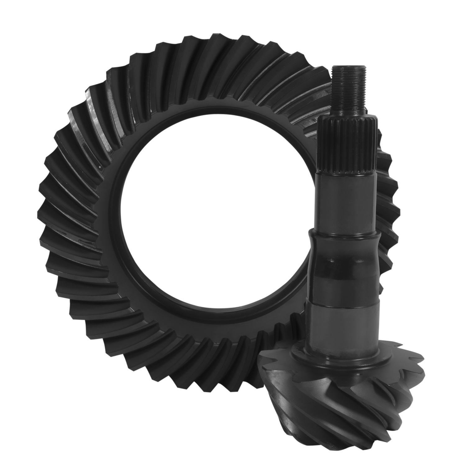

I have 5:13 for both front and back. 8.8 and d-35. Maybe update your chart...
wow, where did you get 513's? I looked over yukon, summit, jeggs, etc - figured if yukon didn't have most nobody would.
ouch that's pricey... I googled 5.13's directly since none came up on the typical listing pages and found a couple hits both said "not available" but only ~$270. Thanks, will update as it is nothing to do, and they show 300+ in stock so definitely not dead.
happen to know what the tooth count is to get to that ratio? (I'm assuming 41/8, but looking for confirmation)
nothing urgent, I couldn't make the math work out with any other typical pinion counts so figure it must be 41/8 and not urgent at all... not enthused to get around to developing it into a pyhton or javascript or or - whatever it takes to make it a dynamic calculator instead of static...
