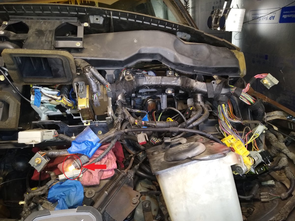

UPDATE:
I think I found the problem last evening. It was late when I came into the house so I didn't get a chance to update last night. Everything was fine up to yesterday. Didn't blow a single fuse. then all of the sudden the fuse blew and I was right back to square one with the exception that I got pretty much of all the truck back together. The bed is removed and has been for a year now and I have a sheet of plywood laying across the rear frame and have been using that as a bench to store parts and tools.
When I got to the rear of the truck and get things restore properly I removed the sheet of plywood to have access to everything. After getting everything looking good and all the rust removed and replaced what needed to be replaced, I just threw the plywood back across the rear frame to get my parts bench back that I really missed. well in doing that and just throwing the plywood onto the rear frame, I pinched the wires that went to the rear taillights and didn't know it.
I am guessing that when I started putting things back on my homemade work bench, the wire must have moved around enough to stop shorting and when I starting putting lights back into the sockets yesterday I must have disturbed them back to touching and blowing fuses again. took me a few mins to open up the wire loom to find it. I am hoping that was my problem all along and now it fixed. I hope everybody is still following along with this thread and I can share everything that I did to this truck. It has come a long way to the point where I am at now. The young kid that owned this truck really beat the snot out of it and she was in bad shape. I didn't restore the truck to be a show truck I am building it to be a daily driver.
