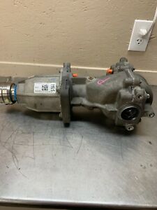

I meant not a "normal" rear differential. AWD vehicles that are front wheel drive based have a transaxle up front with all the gearing in it already so the rear axle is just a little coupling thing not an actual normal big ring and pinion setup.

Fascinating. How do they handle turning when the AWD system is active?

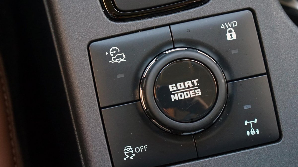

The BS has 4wd lock and rear diff lock...

@Dirtman - That Escape rear differential (right half of assembly) in your picture is the same Dana 28 found up front in Gen 1 & 2 RBV - normal ring and pinion. Ahead of the actual differential is a clutch mechanism (left half of assembly) preventing driveshaft bind between front and rear axles when driving on hard surfaces. Newer versions will lock clutches almost as good as mechanical set up.
If you meant that it isn't a solid axle, that is true. But even Expedition and Explorer gave up solid rear axles for ride comfort.
