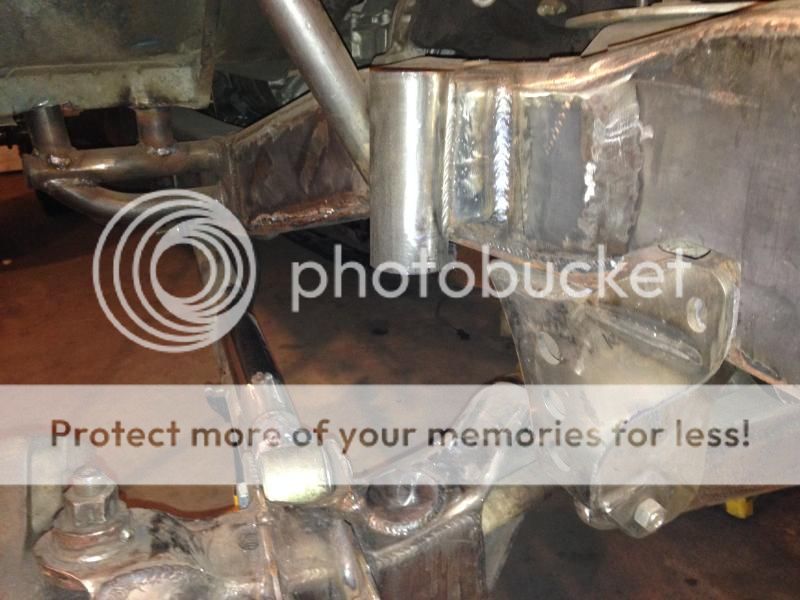

A few more things done.
Got the passenger bump can mounted, and strike pad welded in.

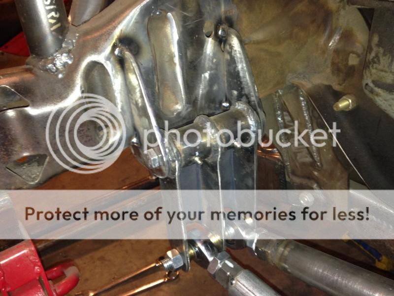

Grease zerks added to my swinger, the holes pass through past the delrin, and lubricate passages between the delrin/sleeve.

And got the passenger side tie rod made. I got everything to cycle perfectly with clearance with the heim on TOP of knuckle arm. I tried running it below and got bind.

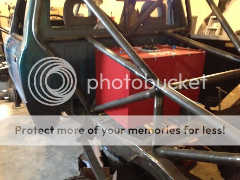

Got my fuel cell, and through it in place, havent made mounts yet. 32 gallon...

I didn't see if you said one way or the other... you planning to put the outer skin of the bed back on for appearance's sake?
looks good btw! we can only aspire to your level of greatness
Yeah, I have fibreglass fenders for the truck front/rear.

Just wondering, why didn't you plate the frame there?
Didn't need it, its just holding a pivot point, there's no force being applied in this area...
