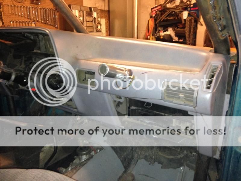

Went for a ride in my buddies RZR this weekend, and decided it was best that I have grab handles for my passenger, similar to what was in the RZR.
Tore dash out, cut hole, welded in DOM tube.
Rangebe...version 2.0
Reinstalled dash, made DOM inner sleeve, and drilled for snap pin.
And welded up some handles. Will get some dirtbike grips or something to go over the ends. Bars can easily be removed by pulling the pin, and handles out.

oh yeah, the cage setup selection/execution inside and dash fit-up is outstanding imo as well.:icon_thumby::icon_thumby:
your patience is much greater then mine for damn sure!!
You need a "Remove before flight" ribbon on a plug for when the passenger grab handle isn't in use.lol

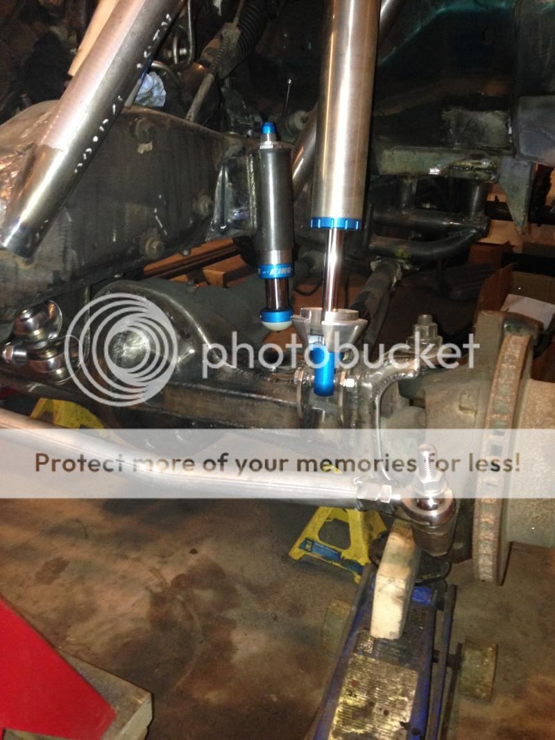

with that much droop does the passenger side axle have any bind in it from the diff side? BTW this is a great build i like the ttb set up,i just thought i was doin something with d44 knuckels on my d35 but sir have raised the bar !
I have clearenced the middle u joint in order to prevent bind, but yes that is the limiting factor for pass side droop. Where it is is fine. I will strap it a bit above for safety tolerance.
I do have a muffler plug with that slogan, will try and take a pic :D

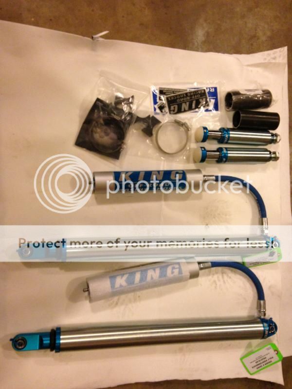

Just got a bunch more parts: 2.5" King 18" travel remote reservoirs for the rear shocks, and 2.0" King hydro bump stops for the front.

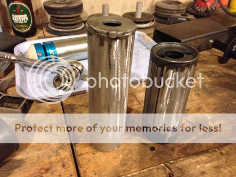

Been tinkering again. Started mounting bump stops.

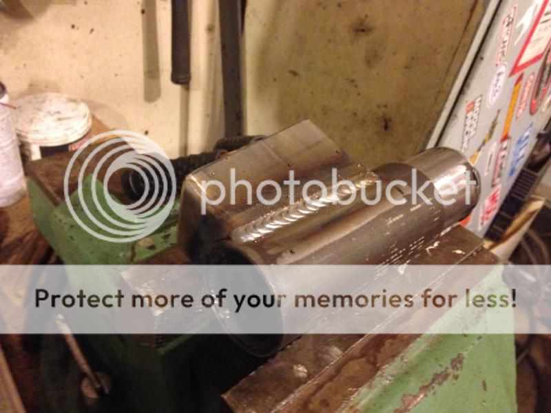

King bump can cleaned up. Made a slug out of 2" DOM to use while welding in order to prevent the can from warping. The slug is 10 thou over the actual bump, so if it slides in/out after welding, I shouldnt have an issue.

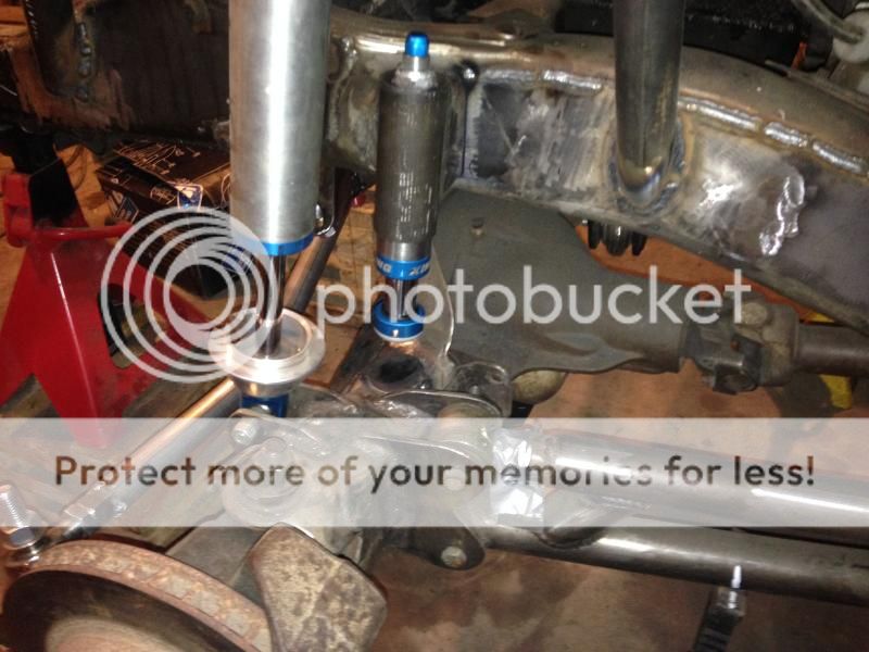

Started making brackets. I ended up doubling up the sides with plate, so it is 0.250 thick.
Laying dimes with the can in place.
And tacked in place. Also made a 0.250 thick bump pad on the arm, youll see it if you look close.

Will burn it in tonight, with the bump removed of course. Also need to play with my tie rods more, even though the current geometry works, Id like to try and make the driver side straight with no bends.
