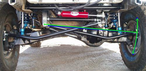

no bend required for the pass side. fully cycles with no bind straight.
Notice how on that setup the Pass tie rod is in front of the drivers, mine is the other way around. In order to get clearance I had to make mine this way.
Ohhhhh ok. I thought it was a symmetry thing to control bump steer.
