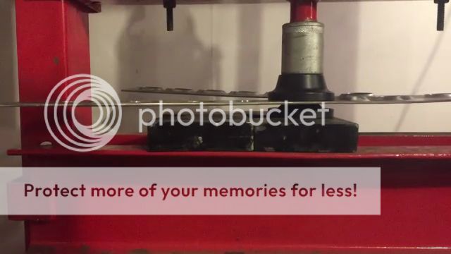

Then dimple died everything. Dimple dies are from TMR Customs, and work awesome.
For those of you who havent dimple died anything, look at this video. The deflection is almost alarming, however come right back into shape.
