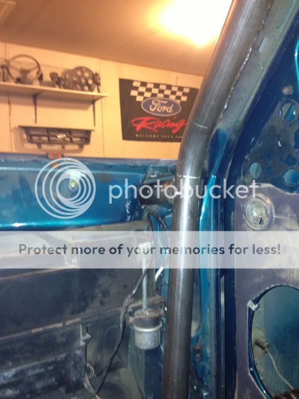

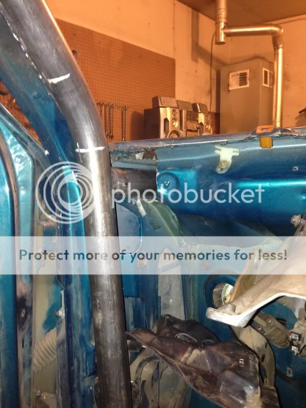

Getting closer to being done the cage. Got the internal cage to engine cage outriggers sorted. Cut/enlarged holes through the fire wall to gain access to A-pillar tubes. While it doesnt look like much, it was quite a bit of work to get it all to fit and keep the stock wiper linkage intact.

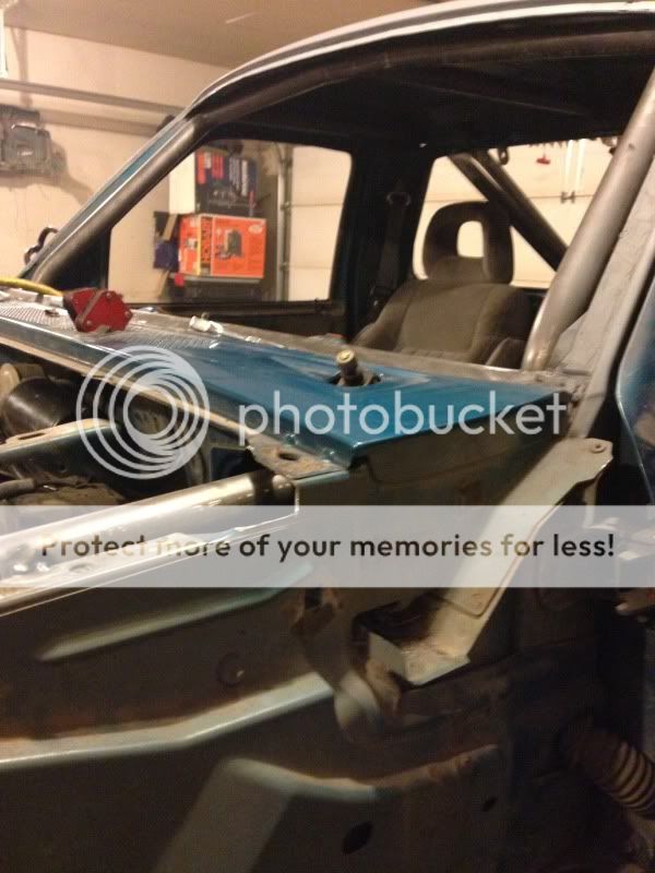

And you can see where to the tube passes through the firewall into the engine bay.

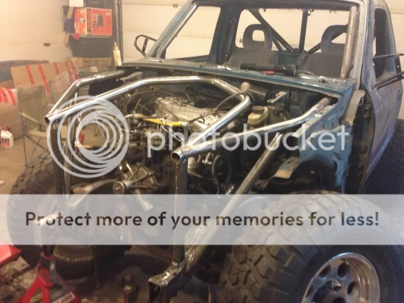

Been busy, havent posted in a while. Lots been done, and even more than what pics I have.

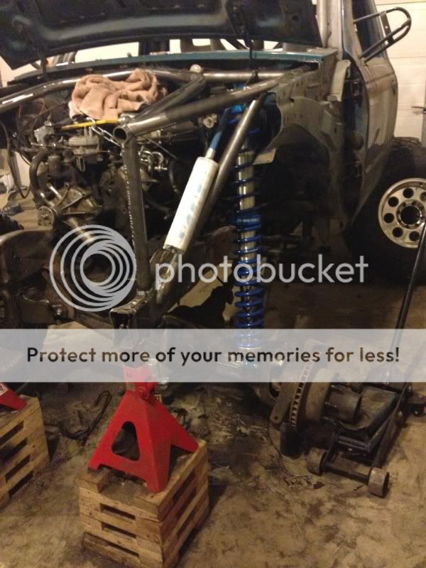

Engine cage started, goes through firewall in 3 places.

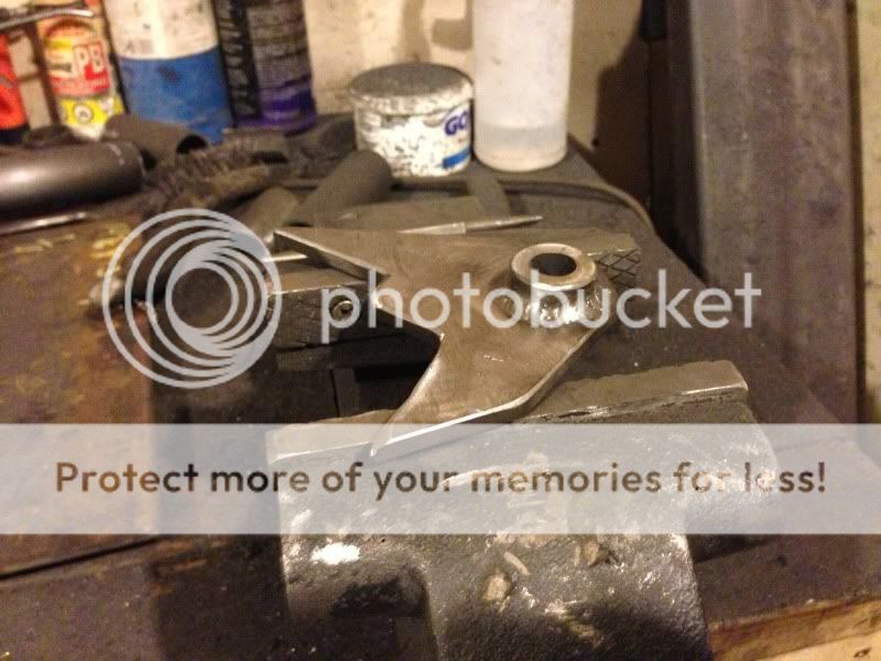

coilover mounting

and coilover in position.

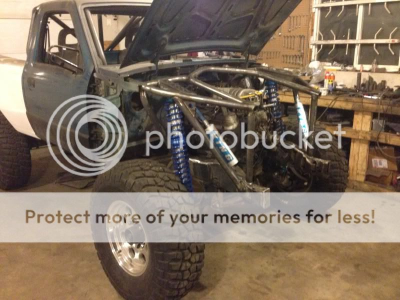

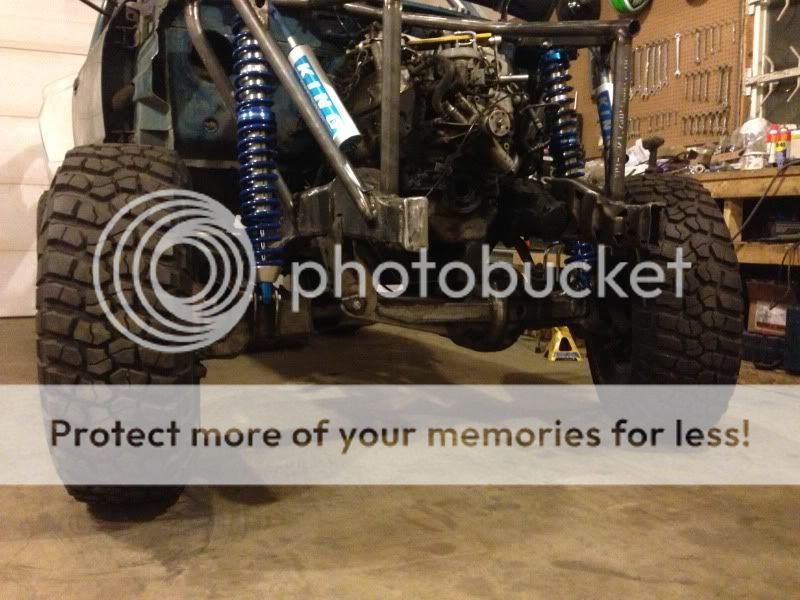

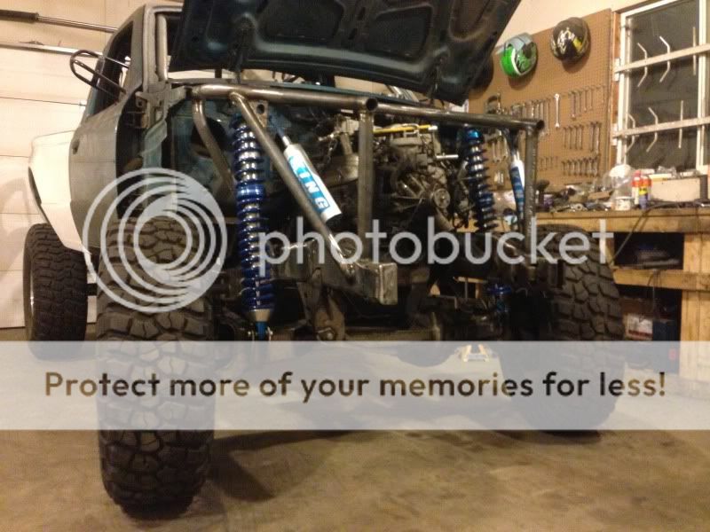

This is the first time the truck has supported its own weight in a year and a half, very pumped. Still have to make the removable braces in the front of the engine cage, and a couple more down tubes, but shes getting close! I think my spring rates will be just about bang on. This is about ride height, and the upper coil retainer is turned up most of the way, so as weight is added Ill just turn them down to where I want them.

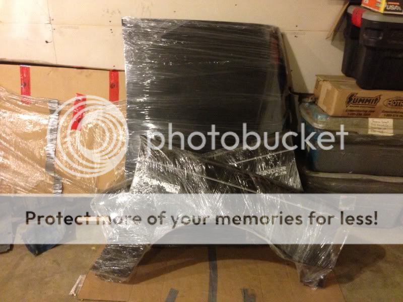

And scored these at the junkyard; MINT black gen 3 Ranger hood and front fenders (wrapped them in shrink wrap to keep the grinding dust off). Im going to have 2 sets of skins for the truck; fibreglass for pre-running and go fast stuff, and stock steel bedsides/fenders cut to fit the wheels for trail-bashing.
