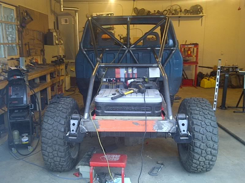

What's an action packer?

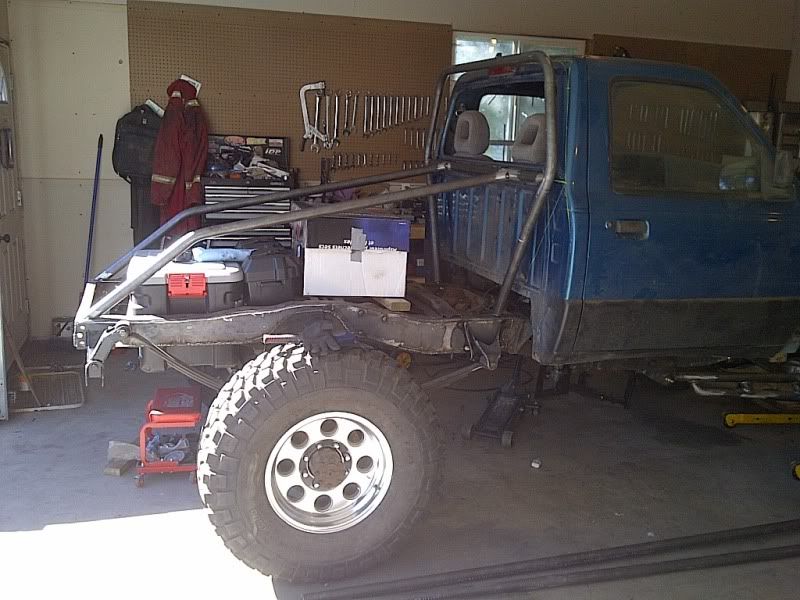

neither. Full prerunner bed cage tied into internal roll cage extending through the firewall to engine cage.
teaser.......cardboard box mimics fuel cell, and the rad isnt there, but will be going in front of the cell.

Progress:
Doesnt take long to eat through a bunch of tube lol.

nope, running those leaves for now, but with 2.5 18" travel remote resi shocks and air bumps. The cage will be there for strength, and for when (couple years) I do cut the stock frame off and 4 link it :D
Im pulling 17" of travel out of my leaves, hence the need for an 18" shock.
Yeah, I was pulling 17"on the 63" leaves on my old red Ranger. Rear end flexed like a boneless stripper.
I am running 5.5" lift 63" leaves and my 12" travel shocks are limiting droop buy atleast 4".lol
