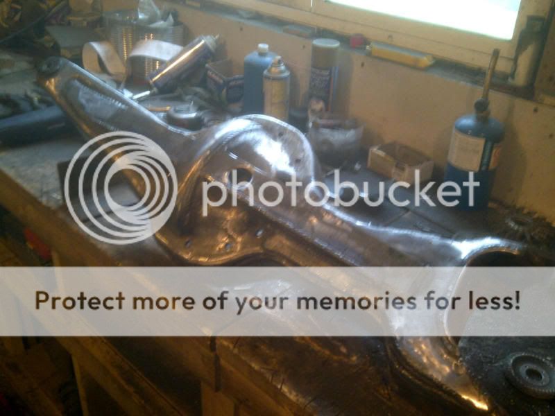

Thanks. Got the ring gear street in place.
Cut a piece from the 50 beam, as it is 5/16" thick.

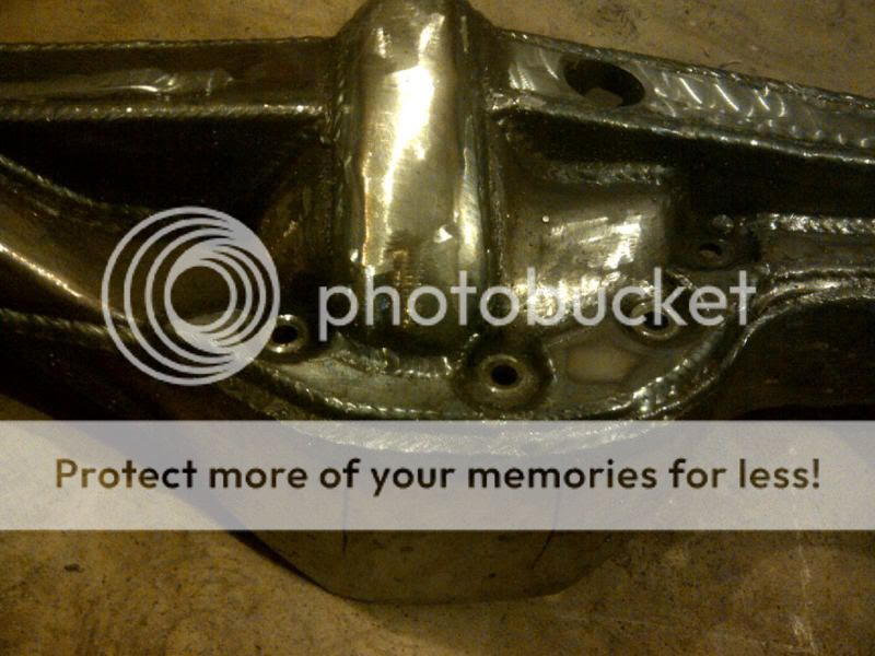

Rangebe...version 2.0
Burned in:

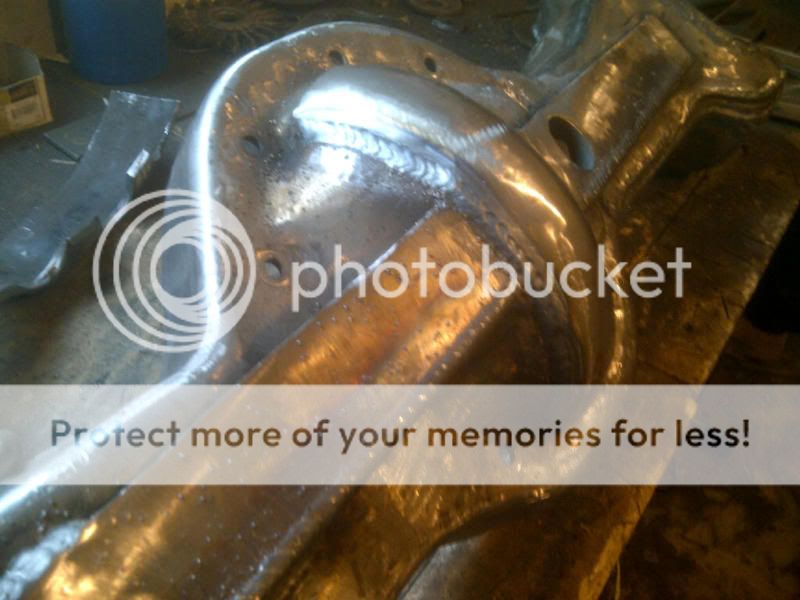

Just need to plate the bottom of the beam, and top of the truss, then the beams with be DONE. Wayyyy too much work into those beams....

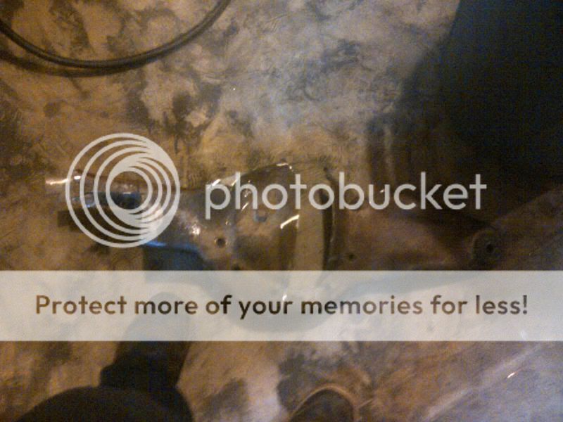

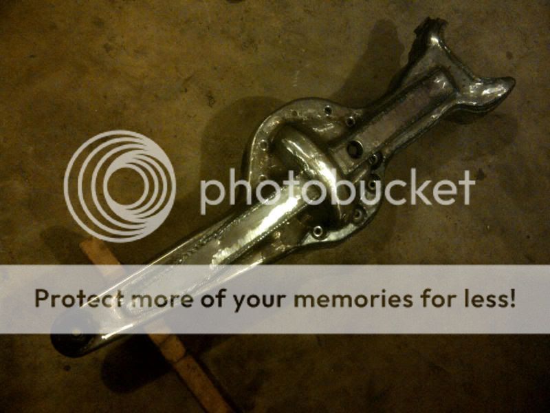

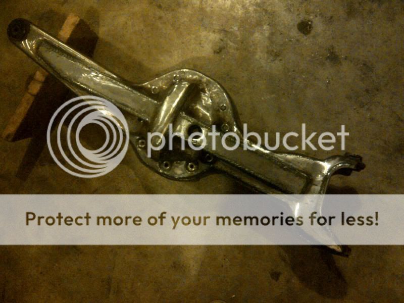

FINALLY finished the drivers beam. I am officially done with these beams, and can get moving on my radius arms once the rest of my parts show up....Ive got a trick up my sleeve for those :icon_thumby:

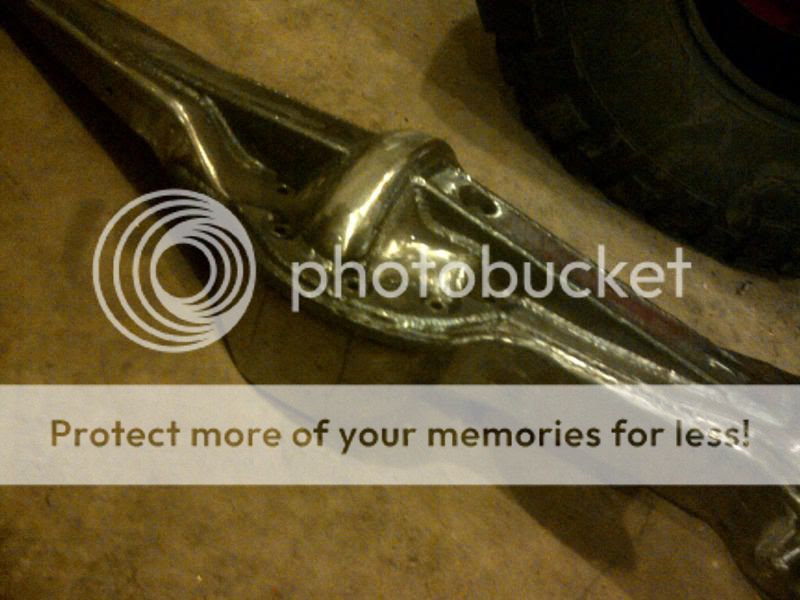

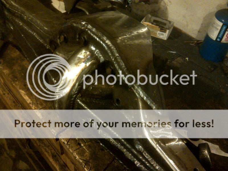

For the count, the bottom, front, back, ring gear are all plated, and the whole beam trussed. This thing is SERIOUSLY beefy.

Youll notice I plated the bottom, and extended it rearward a bit extra in order to give the diff a bit of protection.
have you weighed the beam yet? have a feeling your end weight is going to be over a s
straight 60
with complete outers, including knuckles, rotors, hubs, and calipers, Im figuring right around 350-400 pounds. Thats actually 50-100 pounds LIGHTER than a 60. Remember that a 60 has 0.5" thick 3.125" axle tubes. My beams look a lot bigger than a 3.125 axle tube, but they arent 0.5" thick, so It actually works out in my favor. Plus thats the weight of a stock 60...add a truss/armor/diff cover/etc...
