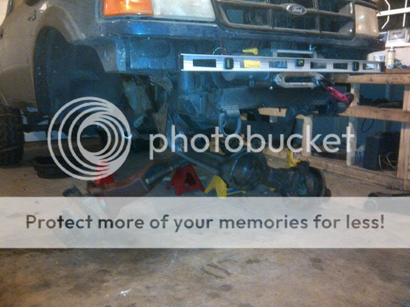

Yep. Rad was cooling a 427 stroker, so it should cool a stockish 302 more than adequately. Yes, rear mounted radiator, and rear mounted fuel cell. Wondering if I can get away with a stock water pump, or if I should bite the bullet and get a Meziere electric pump. What did you do for motor mounts? and could you do me a favor sometime, and measure how far rearward the transmission crossmember is, in comparison to the cab mount or something? going to make my radius arm brackets/tranny x member and would like to have an idea where to put them.
I used stock 4.0 mounts, made plates to adapt them to the motor, easy.
I will measure for you.
thanks.

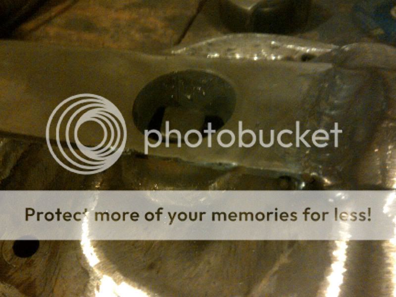

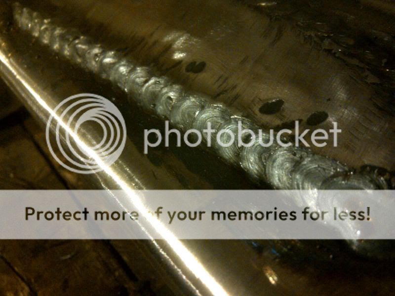

Back of the passenger beam was open....so I cut out a piece to fill it.

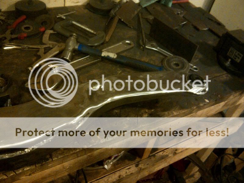

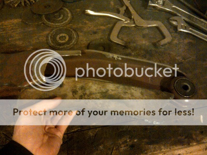

Burned in and cleaned up. Also pressed out the old bushing, and pressed in a new one.

um... it may be a stupid question but shouldnt there be a hole in that beam for the axle shaft? or is it on the other side
That is the back side of the passenger beam near the pivot, as shown in the picture...no shaft there. Window is on the front side. Take a look again.

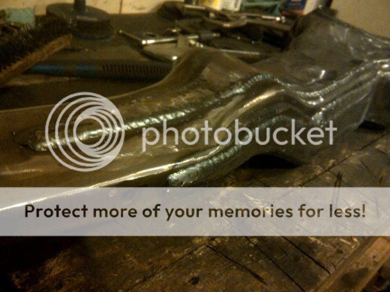

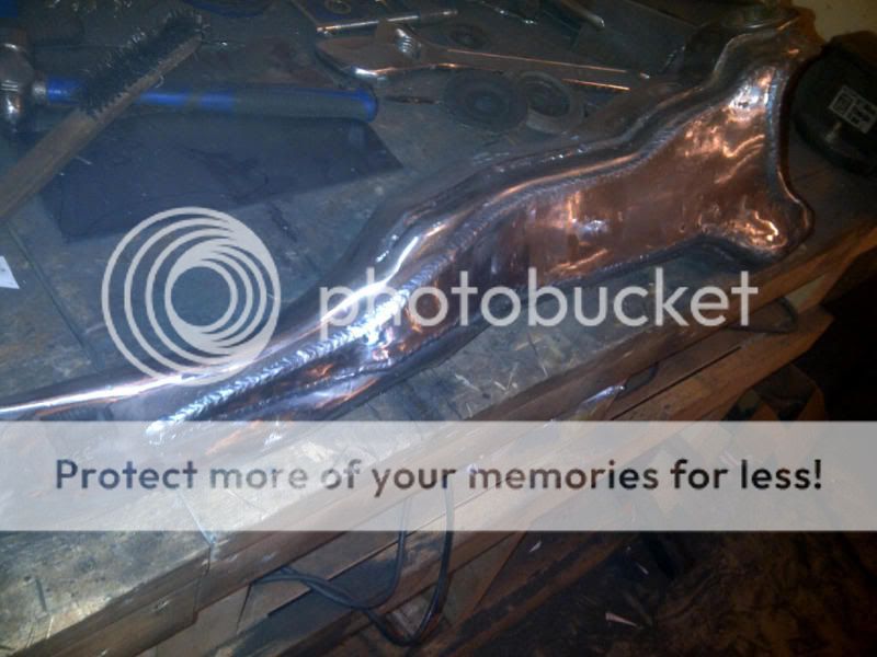

Got the passenger beam plated, front, back, and bottom.

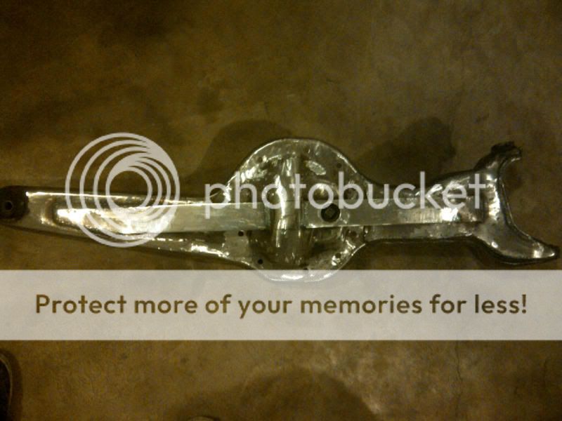

Need some more steel before I can truss the drivers beam...then theyll be done.

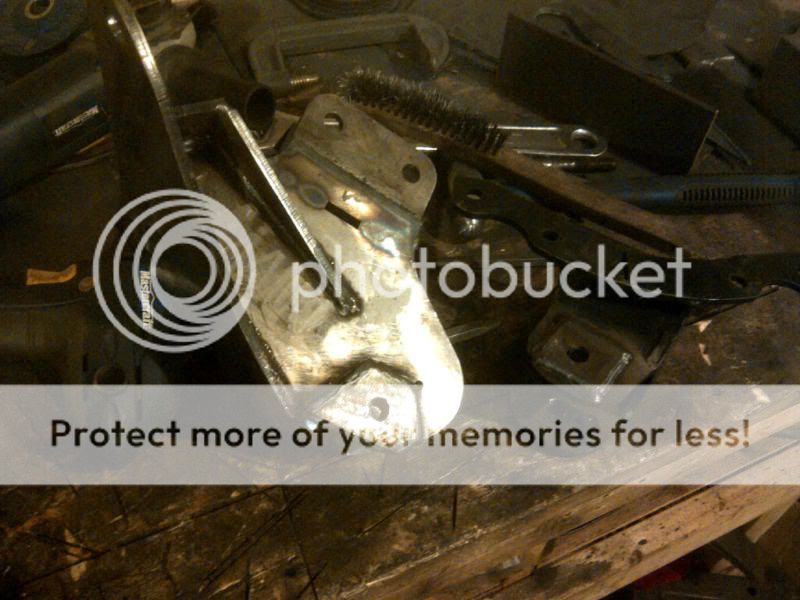

Finished welding my brackets, drilled final holes, and reinforced the holes.

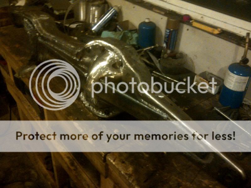

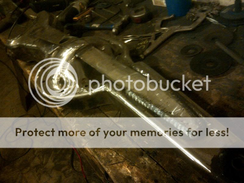

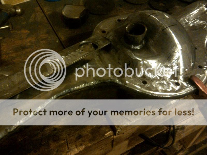

Took a bit last night to start on my truss. Wanted to keep the stock fill plug, so used a piece of 1.75 tube to protect it.

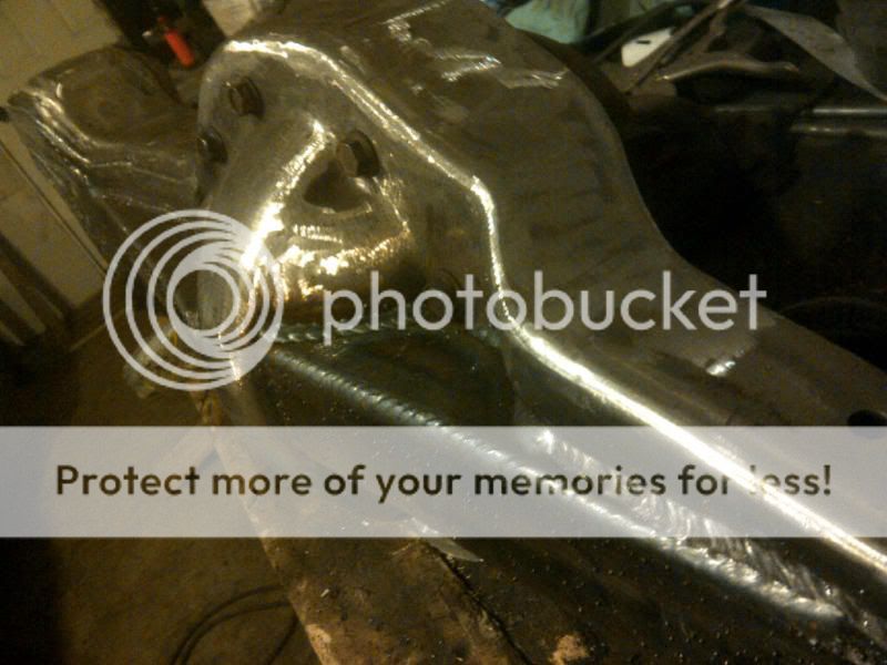

Need to fill in the side plates. Also you may have noticed I didnt go over the crest of the ring gear portion. I will be welding a plate vertically down the entire bump for protection, will do that after.

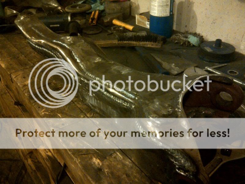

got the bottoms section filled. note that I welded it together with the pig bolted in, as to help minimize warpage.
